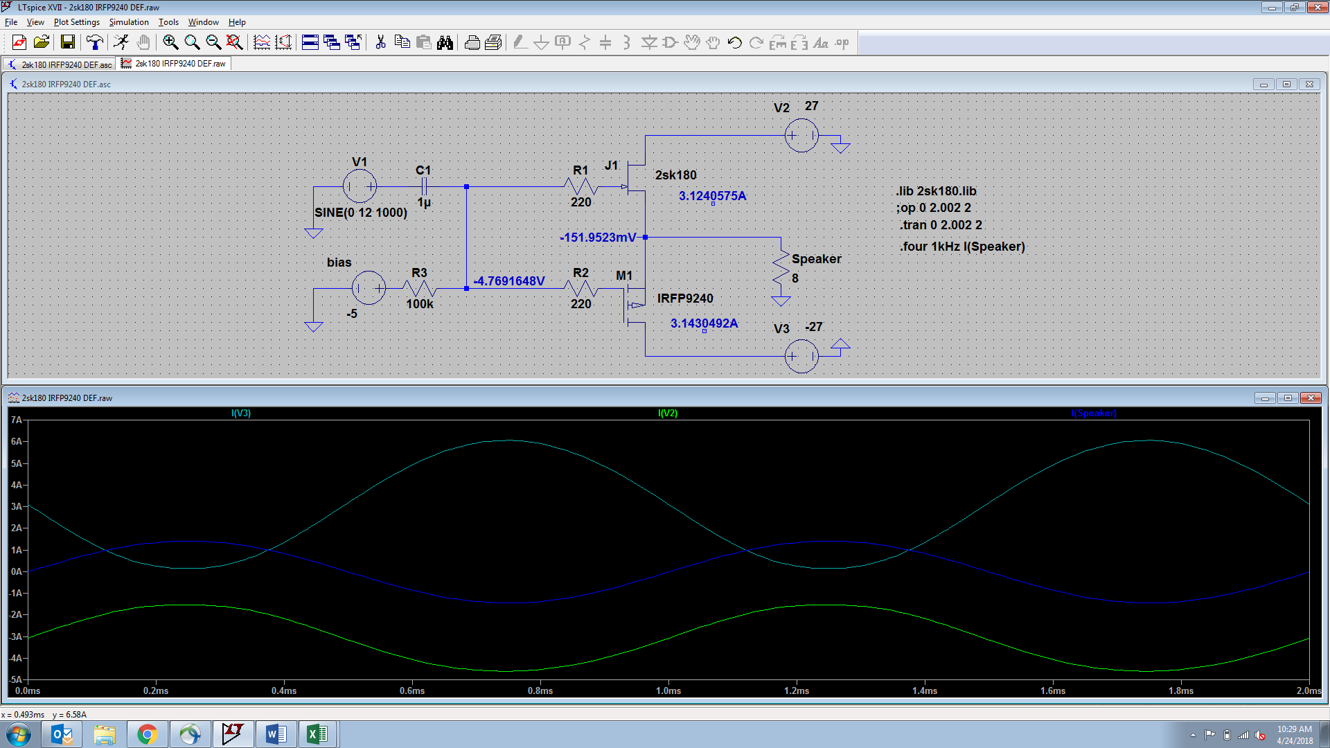

what I posted here : Most Greedy Boy, of them all... or (there is no) DEFiSIT of Papa's Koans
652778d1514115479-greedy-boy-defisit-papas-koans-defisit-currents-16vpp-8r-jpg
red - current through 8R load
green - current through mosfet (IRFP9140)
blue - current through PapaSit
that's probably of same seriousness as Monty Python's Flying Circus - World's Funniest Joke

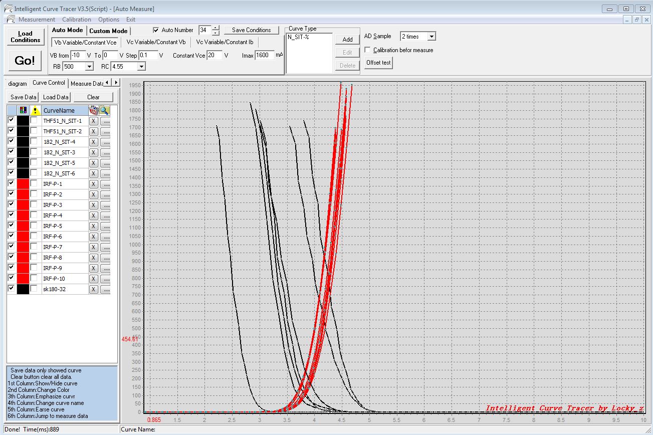

Seems I have no P channel IRFP9240 Mofets that have the same data as my SITs. They need all a higher Vgs for 1.5A.
So the method Antoinel suggested will not work, is it right that in his case the R084 had the higher Vgs and therefore he could reduce the voltage for the P MosFET?
The Lockyz measures the devices cold.
I would suggest you to try mounting both FETs onto a heatsink, measure manually (give time for them to heat up and stablize) and see what you'll get. The Vgs required for the 9240 to reach the target current will drop quite a bit after heating up.
I have been playing with LTSpice and trying to understand more about the DEF.
Please confirm my understanding:
1. With parts that are perfectly matched and using a symmetric dual rail supply, both parts will pass the same current and the DC voltage at the sources is 0V.
2. The gain of each device is likely not equal and so AC current coming out of the supply rails will be of different magnitudes.
is this accurate?

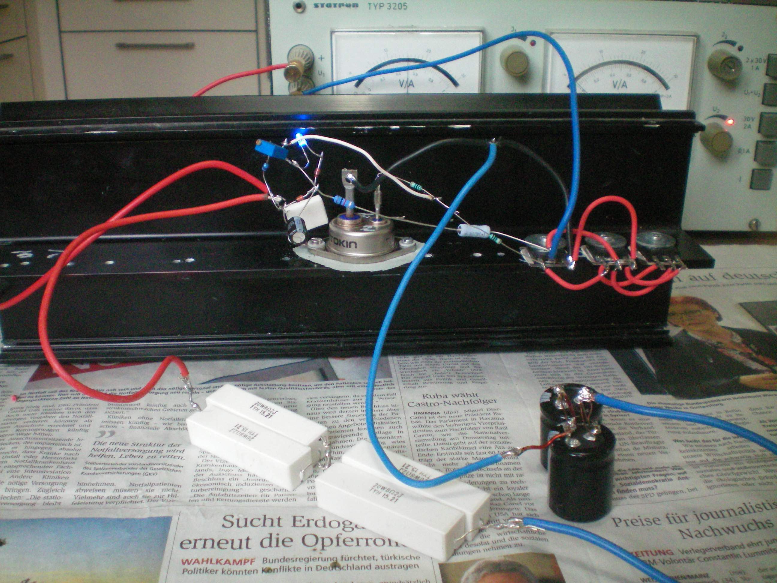

I had time so I made some tries with my SIT and some 9240.
When I paralleled two, later three 9240 I got at least 0.5A current running.
My external PSU delivers only 30V and 1A so these tries are more for fun.
Mind that I also invested in a blue LED to get the Pass effect......!
:D:D:D:Popworm:

Today I made some changes, other SIT, the one from yesterday was more in the middle of my ballpark. Now I took one with higher Vgs. No more the THF-51 but SK182E.
Results are now much better, still two 9240 parallel.
I can reach with 30V the 1.4A without problems.
Now I heat the heatsink.....
And many thanks to ZM for his generous presentation of Nelsons gift all over the thread and to Antoinel too, doing so much good research for the DeFSIT in his thread.

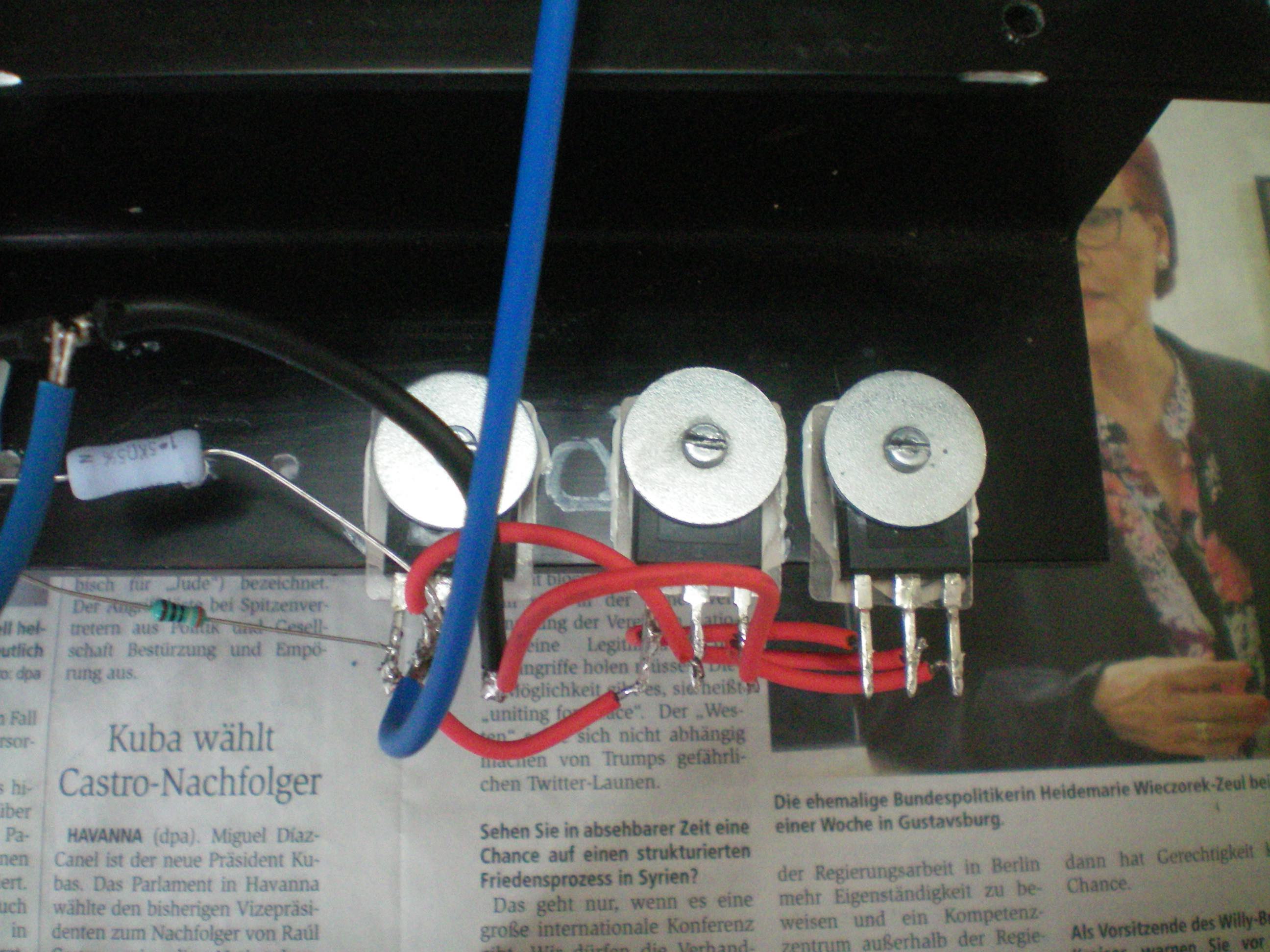

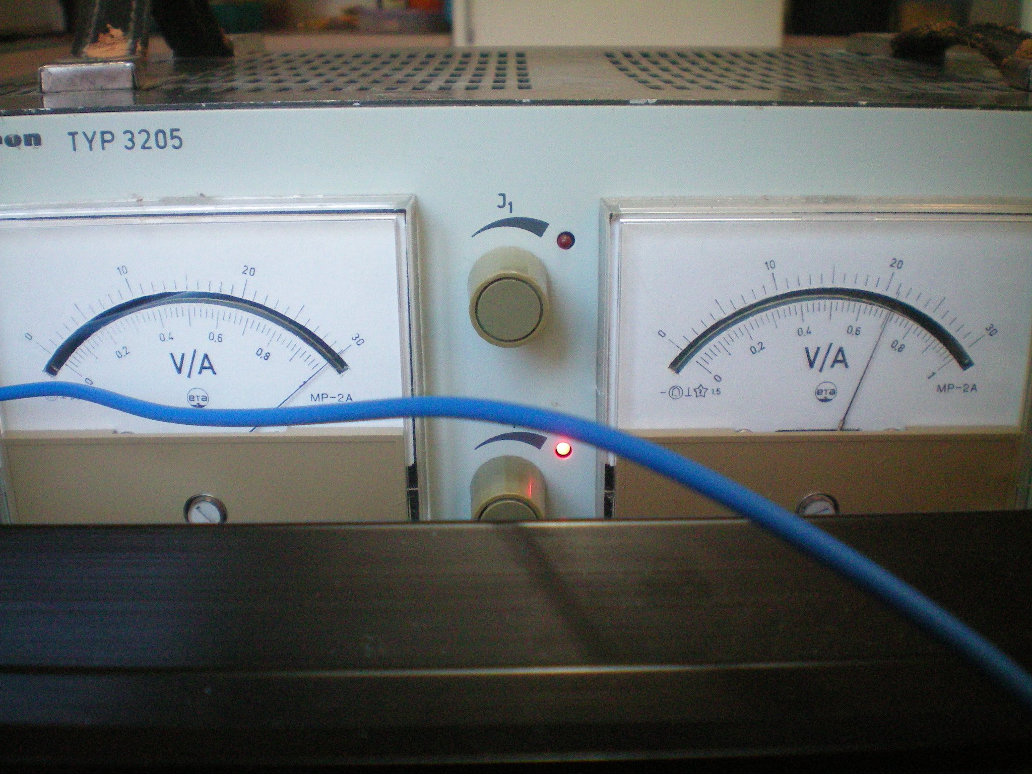

First picture shows the changed SIT and the two doubled IRFP9240.
Second pictures shows the voltage 30V and the current value, with 0.7A.
You must double it, I choose 30V 2A adjustments at the PSU.
Old gear from the former DDR.... :--))
:D:D
