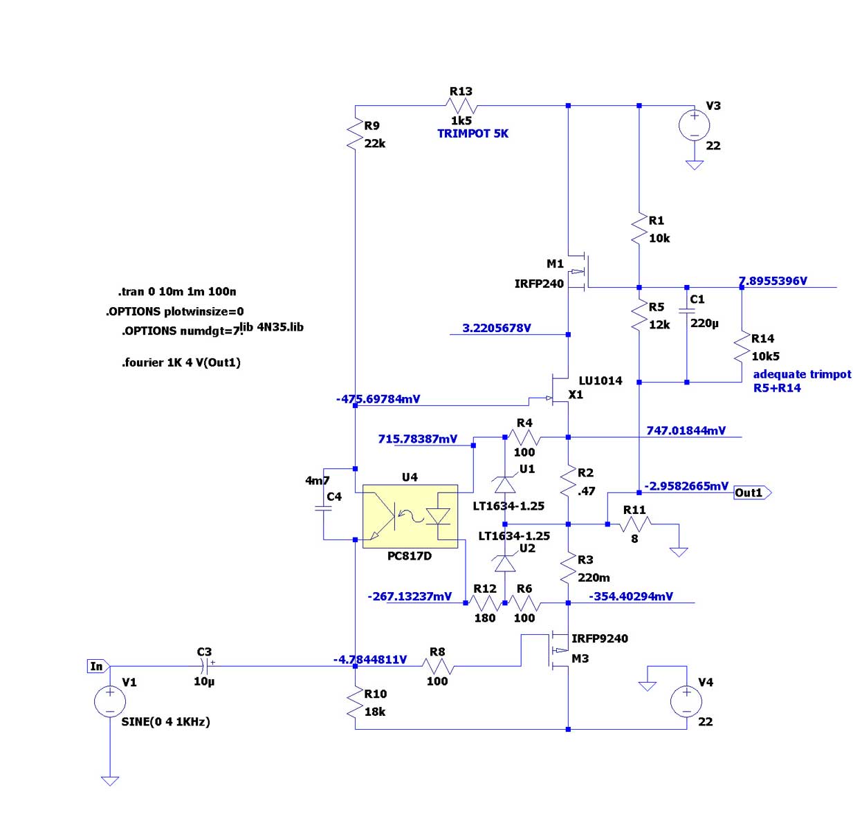

si , it is doable , Iq around 1A6 as predicted per spice
it'll need sort of speaker delay , just because there is nasty voltage peak in startup sim

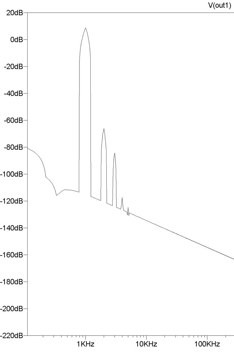

this is far from optimised** , THD is 0.1% at 1W , though THD spectra is schweeeeeeeeeet :clown:
**demanding both more time with LTSpice and then real deal - playing with it in vivo
Hi ZM. Interesting circuit. Pls check FET Vgs values; -5.3V for P-MOS and -3.8V for SIT?; reversed?

Mr. MR , have you SJDP model , too ?
and , just now , I'm having an idea of trying it with cascoded LU ...... it would allow full blast (meaning regular FW range of PSU voltage ) version of amp
will sim tonight ....... and just dream when I'll have time to try it in vivo

another proof that pudding exists :clown:
real pudding is on da Bench
startup behavior pretty benign , no need for speaker delay
cascode voltage fine-level trimpot advisable , you can put pot there and call it Zen Amount Pot ........ something as in PapaSit-1 :)
