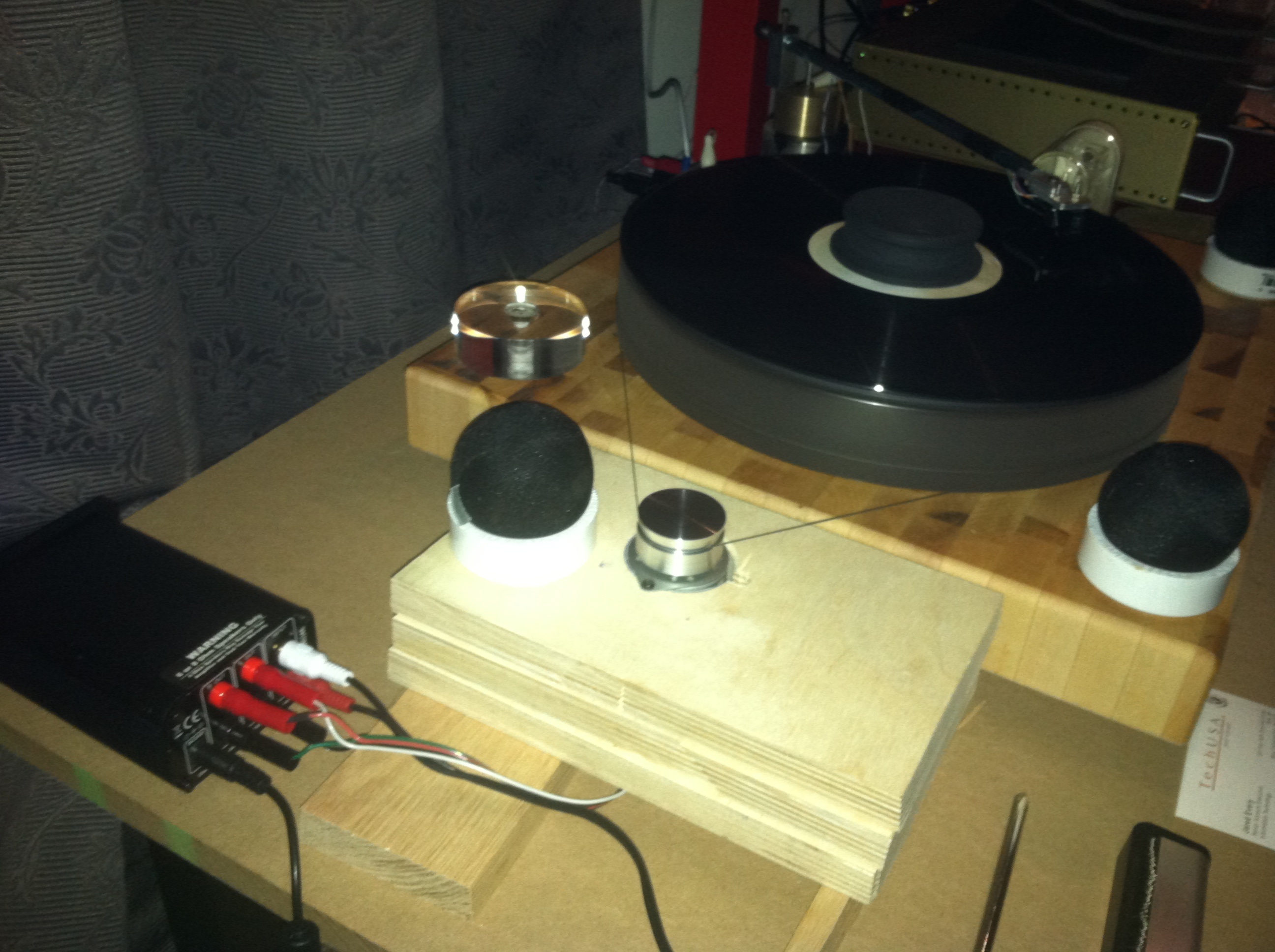

Here's my setup with a stepper motor. Has a bit less vibration than the 115v cap driven motor. There's a bit more bass and its picking up more detail.
Only tried a 60hz tone. Haven't put a strob on it yet either.
Not bad for a $4 motor. Still have two motors as backups. 😉
