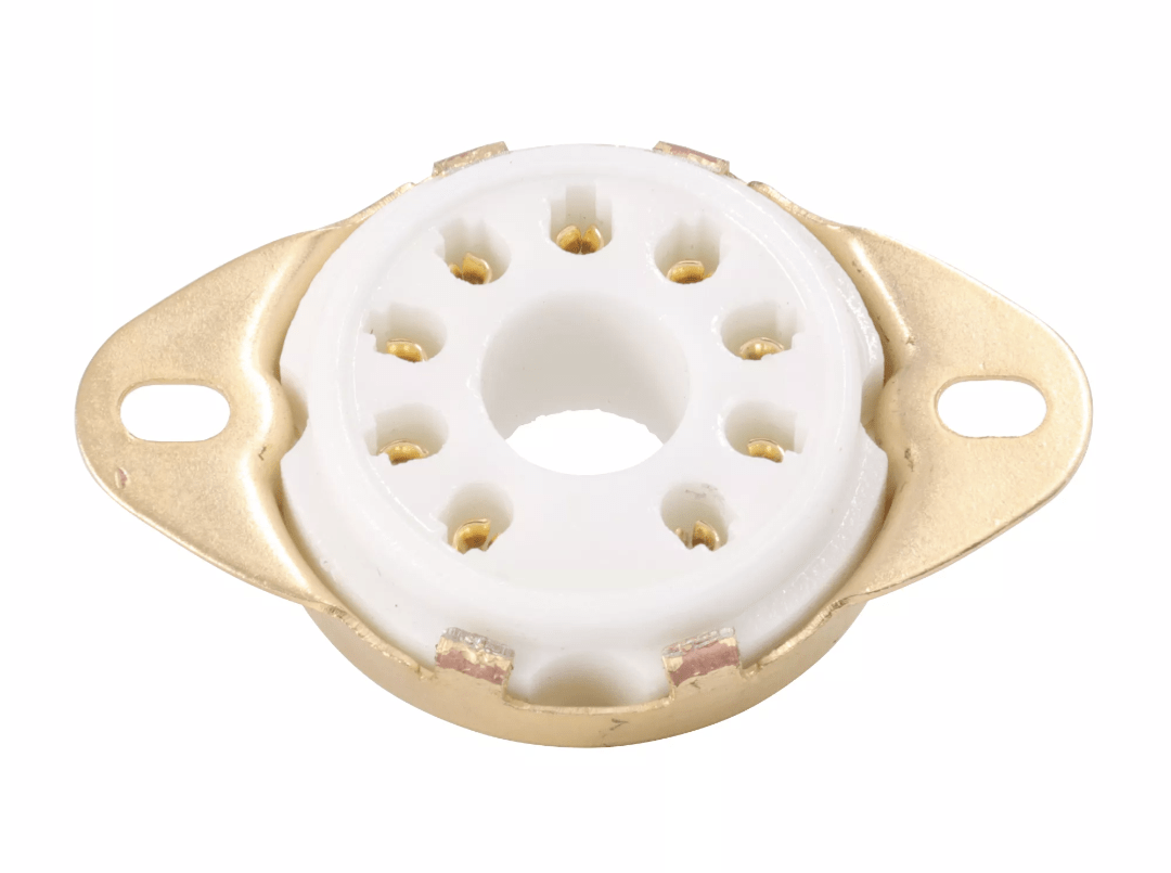

Can you guys advice on mounting ceramic bases like the one in the picture? I believe they are designed to be mounted under the chassis, but not sure how to handle the bit that stands out on the mounting hole.
Any advice is appreciated.

Thank you!Can be installed either way.
What about the protuberance on the top of the mounting holes? Should the chassis hole be shaped like it if mounted from the bottom side? Any advice on how to avoid cracking when tightening?
I don't. Never had a problem with cracking.Thank you!
With those I would put some sort of flexible washer/gasket material between the chassis and the flange around the mounting holes.

Well, they were advertised as B9D sockets. I tried 6P41S, PL504/8/9, insertion force feels the same with all of them. Not as tight as the Chinese B9Ds, which, in my opinion, are too tight.They could be Magnoval either. Same pin circle diameter, but thinner pins (1 mm vs. 1,2 mm afaik). Have some of them in my drawers. Hope Jose knows exactly what they are.

I managed to crack one of these Russian sockets. The lack of the usual somewhat springy metal ring suggests to me that they were designed to be screwed down to a more compliant material rather than to a metal chassis. They are, after all, intended for the Russian tv tubes 6P36S, 6P41S and 6P42/45S. The Chinese ones have the ring, so shouldn’t require to be tightened down so hard. I use a small drill to carefully open out the pins.
I just measured the pins of a PL504, PL508 and 6P41S, all exactly the same at around 1.25mm.I managed to crack one of these Russian sockets. The lack of the usual somewhat springy metal ring suggests to me that they were designed to be screwed down to a more compliant material rather than to a metal chassis. They are, after all, intended for the Russian tv tubes 6P36S, 6P41S and 6P42/45S. The Chinese ones have the ring, so shouldn’t require to be tightened down so hard. I use a small drill to carefully open out the pins.
