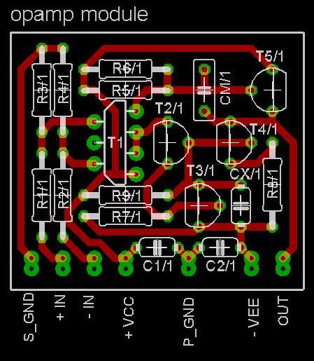

thank you all for positive feedback. It isn't my intention to make and sell PCB's. I'm going to post PCB pictures (not *.pcb files), which are very simple, and anyone will be able to redraw the design based on these pictures (hint - all resistors are standard 400mils). The design is free for personal use but if someone wants to make and sell PCBs on the DIYAudio, they may do so provided that a small percentage of their profits (ca 5%) goes to DIYAudio web server maintenance.
Regards

Is the balanced output stage the same as the XVR? The simplified XVR schematic has a balanced output stage that appears to be floating and not referenced to ground. What are the benefits of one over the other? What type of configuration is the XVR's and what is it called. I looked in a few op-amp books that I have and didn't see a similar circuit. The only draw back I can see is this configuration has different input impedances. Can anyone explain the XVR balanced output stage.

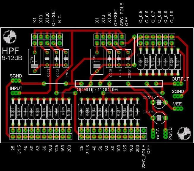

Can one add 1, 2, 3 highpass filters for to have 3, 4, 5 channels crossover filter ?
I heard this xover with moderate quality PS (LM317/337) in a PA system, and the sound was very good, with overall distortions under 0.05%. For home HIFI arrangements, I suggest using moderate quality parts to determine xover frequencies, Q's, etc., and then building the xover with fixed characteristics using higher quality caps, resistors etc.
I am not familiar with the details of the XVR's balanced output, but I don't think it is floating. Only transformer balanced outputs are truly floating, IMO. In literature, several ways to obtain an electronic balanced output can be found, one of them being the topology I have used. (see Rane schematics library). Drawbacks? Every topology has some.

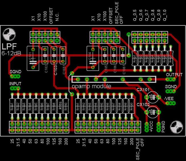

Hi, this does look like a very useflu littile thing to build, but I have one question (which is probably obvoius but I just want to make sure).
In your first post you say that you want this to be variable from 6 - 24 dB/Octave but you boards apear to be only for one section allowing 6 or 12. So i take it that you mean to cascade two units to reach the higher levels?

hacknet said:
i think this is a super cool active xo, but may i ask what is the offset for? is it a muliplier of somesort?
Here is possibility to set central frequency almost in the middle (-3dB point) between two standard discrete 1/3 octave frequency by adding 10 times smaller capacitor (100nF+10nF or 10nF+1nF or 1nF+100pF).
for example:
OFFSET FREQ.
foff=2^(-1/6*fn)=0.89*fn (-3dB point)
for f1=25Hz, f1off=22.3Hz
for C=C1+C2+C3=111nF and R1=63k4
after (2) foff=22.6Hz
