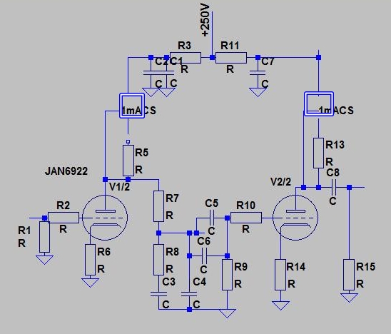

This is the schematic of said Mr.Grove tube RIAA. The capacitors of the passive RIAA network C3 C4 need to be rated at at least 250 volts better higher and should be 1% .
Thus they have to be selected by capacitance meas rather cumbersome as there are no 330nf capacitors 250 Volts 1% available. C5 C6 R9 are not a subsonice filter - thus no IEC. Further no XLR output- but that is standard.
The current sources are specified at 1 mA but no type is given, could be selected njFets.
The RIAA network is described to have low values of resistors R7 R8 and consequently high capacitance C3 C4 but reason not given.
What could exactly be the advantage of this tube over jfets?
A disadvantage first: a fet RIAA amp can be operated on rechargeable battery a bunch of NiMH for ex. the tube cannot.
Certainly a triode is more linear than a Fet we know plate current= v grid/cathode ^3/2
but what about noise? Crucial in semiconductors is 1/f noise. In this respect jFets can outperform otherwise low noise pnp bipolars. But noise of tubes? Don't know besides it is certainly "statistical" but which statistic?

You are actually asking some pretty good questions, unfortunately I don't have a lot of time to go into detail, but this design is not great on a number of levels.
  • The johnson noise of the cathode resistors will be amplified and will result in pretty significant noise over the audio band.
  • The RIAA network throws away some gain that is still to be had.
  • This design is probably not reflective of the designer's current thinking on these issues. To be fair I have designed very similar circuits with similar problems because I took a similar approach.
  • There are a variety of tube noise mechanisms, but 1/F noise is probably the biggest meaningful contributor, but there are others.
I highly recommend Merlin Blencowe's book "Designing High-Fidelity Preamps" it will give you the theoretical and practical grounding to design something really good using tubes. (Very good performance is possible with tubes, just takes a little more thought and care) Merlin is a member here, book came out in 2016. Worth it, and less than casual, but accessible treatment of low level tube circuit design.
SNR is not a problem with a well designed tube phono stage - snrs greater than the best cartridges (which are low 80dBs range).
Another book to consider is Morgan Jones' "Valve Amplifiers 4th Edition" which is entertaining and useful for those with some electronics foundation to fall back on.

On a different subject - selection of precision caps I purchase 2% and 5% and select to 1% or 2% respectively. For odd values or where trims are needed I add capacitance in parallel, again selected.
You can actually get very close and since polystyrene and polypropylene are relatively stable over time, temperature and voltage you can get close, and long term stability seems good in my somewhat limited experience.
Selection is also required for solid state designs operating at low voltages due to tolerance issues with the parts and a desire for tight conformance to RIAA.
I always aim for +/-0.1dB conformance to RIAA over 20Hz - 20kHz.
I think the IEC eq curve is a total waste of time, deal with rumble in the turntable rather than compromise the bass response of vinyl playback. I have similar feeling about the "Neumann pole" in the HF response, not part of the RIAA standard and was intended to cancel rising HF response far outside of the audio band with a specific line of cutters. (This is somewhat controversial amongst a certain crowd of audio enthusiasts.) Common cartridges are usually crashing at these frequencies anyway.
