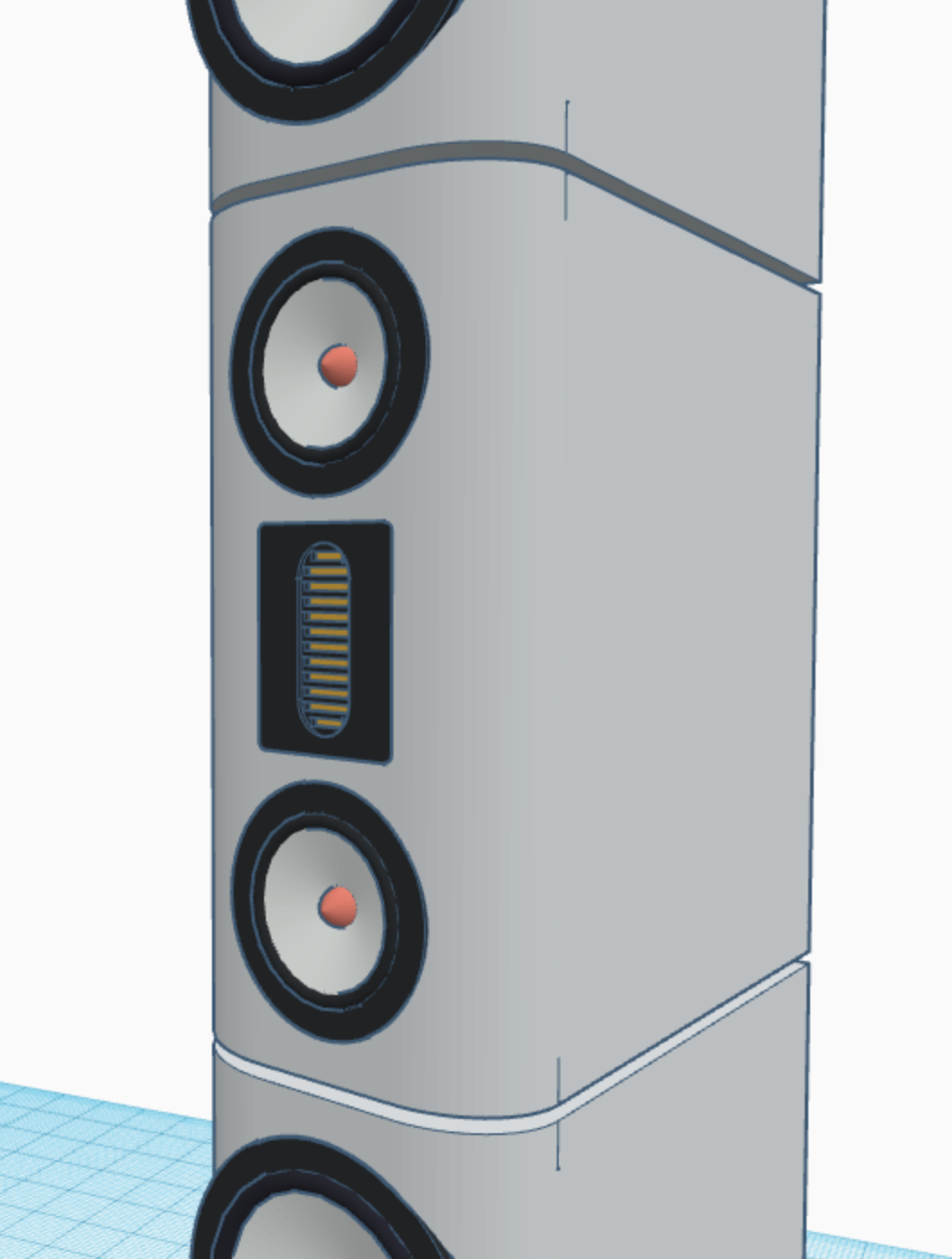

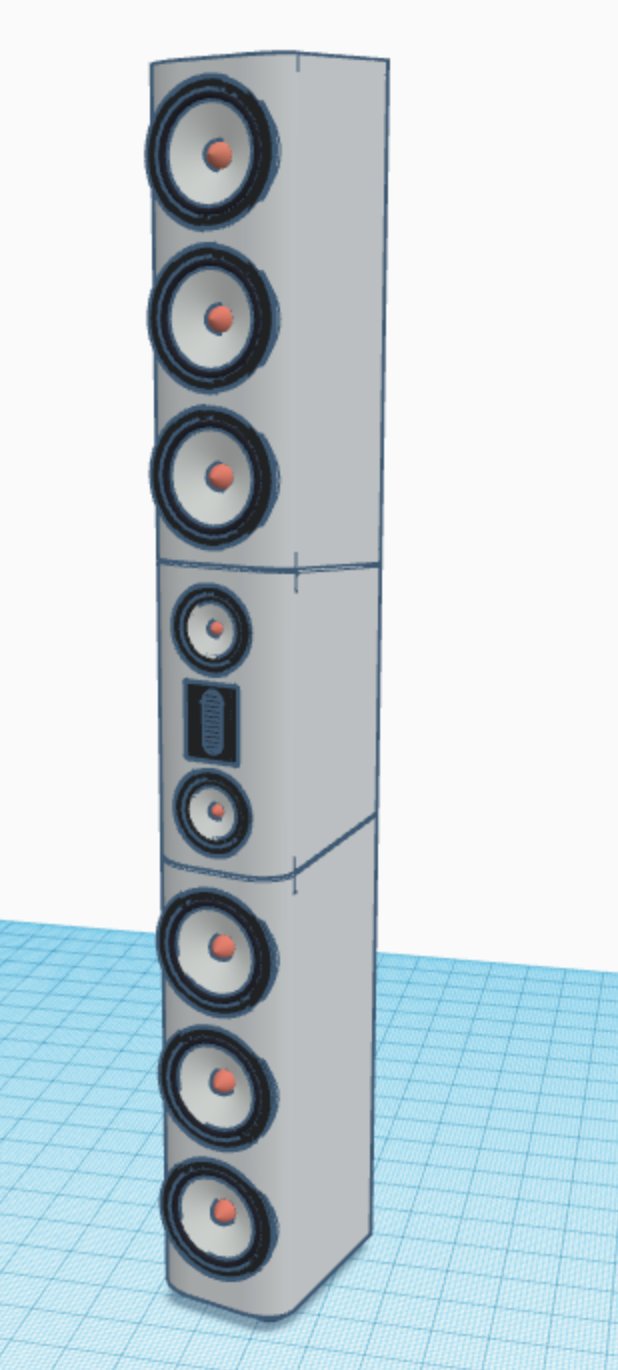

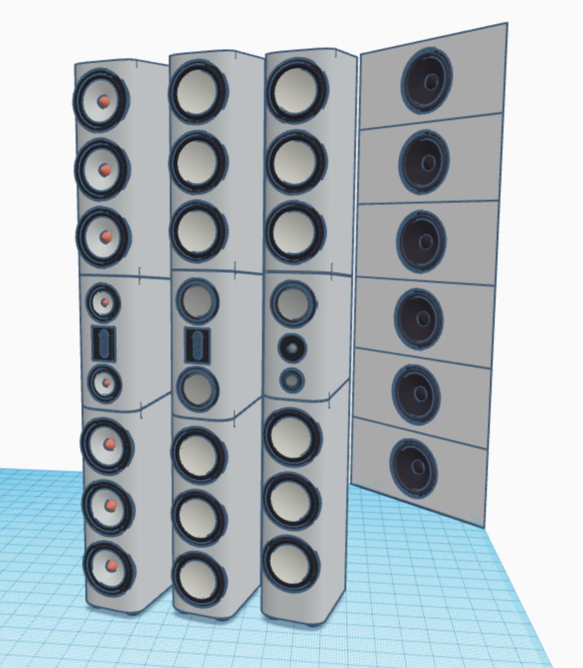

So, well. Points have been made. Measurements don't say everything. Though the Accuton drivers might not have such great distortion graphs as one would expect, pretty bad actually, let alone for the price. They do still have their qualities being the advantage of the ceramic cones and their speed. In real life they will still sound exceptionally good. Especially considering distortion will be significantly lowered because of the large number of drivers, especially for the mid bass. Though, I've worked out the concept with Seas Excel drivers anyway.
I think six W22EX001s will be a better choice than four W26FX001s. The total length across which the drivers will be spread will be taller with six W22EX001s than with four W26FX001s, making for a better spreader radiating front in the room making for a better line source effect. Also, six W22EX001s and four W26FX001s have exactly the same Sd, so excursion for moving a certain amount of air will be exactly the same for both, though the four W26FX001s have about 1-1/2 as much moving mass as six W22EX001s and while they also have about 1-1/8 times lower force factor. And also in simulations is visible the W22EX001 have a quicker inputs response than the W26FX001. So, because the required excursion for both will be exactly the same, six W22EX001s WILL be quicker, make for a better spreader line source, and allow a more slender, more eye-appealing cabinet.

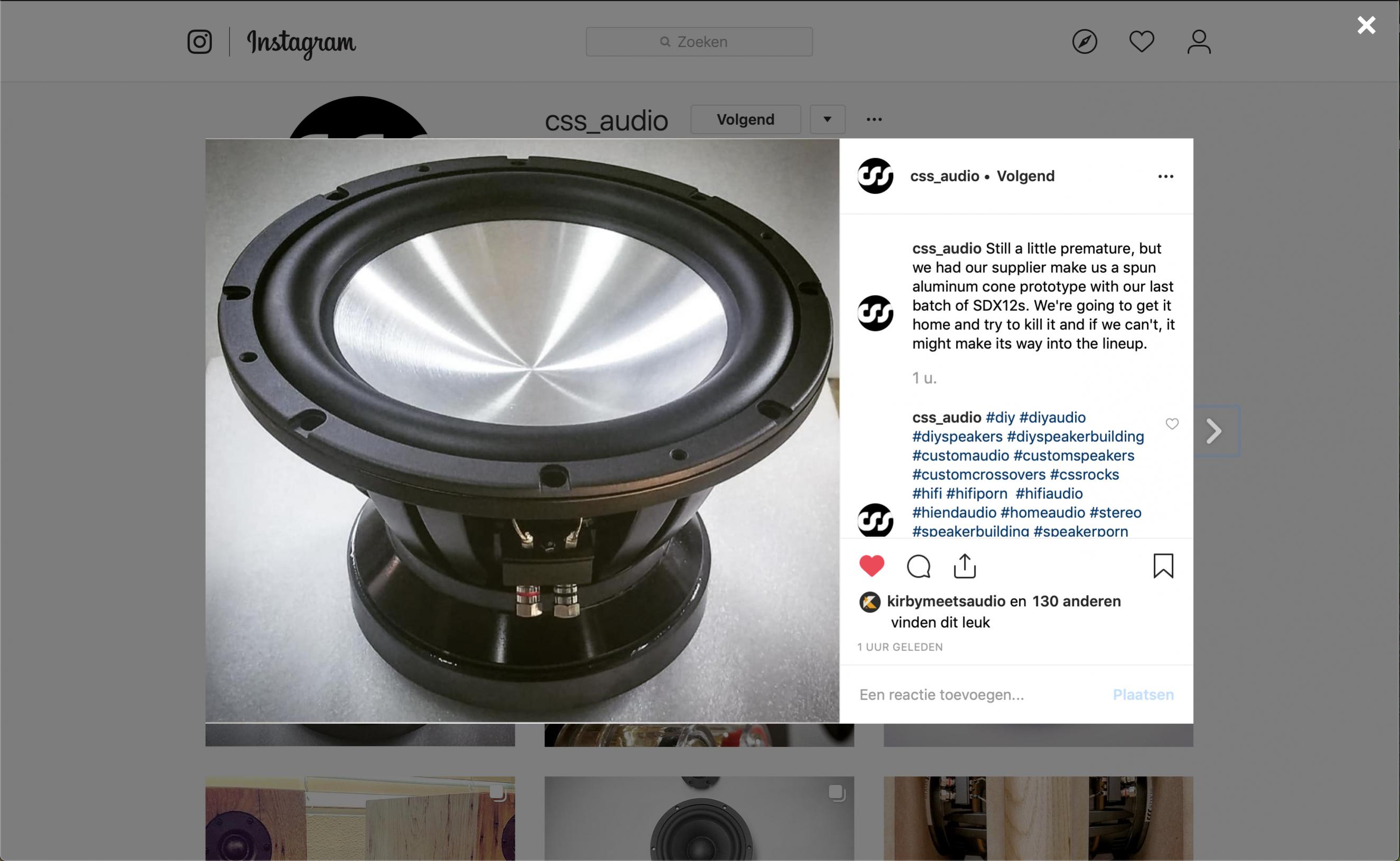

Holy balls. Look at this! CSS just released a picture on their instagram of a prototype version of their SDX12 subwoofer with spun aluminum cone. This is gonna replace the Scan-Speak Revelator 32Ws. I already really liked the SDX12 and it's from pretty much the same price and performance level as the Scan-Speak. Though, in a battle of paper vs paper cone, I still thought the Scan-Speak will be slightly better than the CSS. But now that the CSS has aluminum cone, it has quite an advantage over the Scan-Speak. The aluminum cone will blend in better with the rest of the hard cone drivers in the system and I've been led to believe that metal cones in general can be slightly better at reproducing bass because of their higher strength and stiffness.
I kind of like your stubbornness 😱
Just because that CSS driver has a metal cone doesn't give it an advantage over the scanspeak driver. At low frequencies pretty much any decent cone is operating as a piston. There is no break-up to speak of, paper, poly, alu, ceramic, titanium, carbon fibre, whatever doesn't matter. It's higher up that the material makes the difference.
The scanspeak Revelator 32Ws are actually one of scanspeaks stand out products. Although all of scans drivers tend to be good some of them really hit a home run compared to others and this is one of them. I'm always about price/performance and usually advise people use more cost effective drivers but in the case of the 32Ws...there simply is no comparison, if you have the money to spend then spend it because you will not find better*. Caveat - providing its parameters suit your application.
*There could very well be better out there, but I have not seen measurements for it. Plus the scanspeak is so absurdly good better is relative in that performance-wise you can't really do better unless you can find the same performance for far less price.
I am of course speaking of the subwoofer optimised version with the +-14mm of xmax.
Having said all of that, and rather ironically, if scanspeak changed the cone to one of aluminium it would improve the drivers performance but only at high frequencies.

Just because that CSS driver has a metal cone doesn't give it an advantage over the scanspeak driver..
Isn't the Scan a paper over oriented foam-core design? 😕
If so, the metal cone won't be as rigid.
