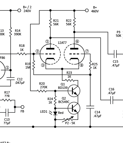

I guess I'll put the BJT CCS back under the 12AT7. I'm not ready to start designing tube circuitry yet, and nobody is chiming in with a current regulator diagram.
The only downside to the BJT CCS (that I'm aware of) is that it's less P2P wiring friendly than the current regulator. But a small vero board will simplify that I suppose.

Here's an updated schematic. It's no different than the original circuit, it just has the power supply added to it.
I've added another section to the power supply for the heaters and the CCS power. I don't know if the CCS supply needs better filtering. If so, let me know what to add/change.
There are a bunch of question marks still (FB component values, mains fuse size for example). Please provide answers if you have them.
TubeMack, I'll create a separate call out to show how to wire the input without the pot.
Again, let me know what needs changing. I'm no electronics whiz.

Dumb question (which might have come up earlier in the thread, if so, my apologies): why not lose the -7.5V supply, return the CCS to ground, make R20 about 270k, and bring R20 up to the B+? That will reduce the parts count and make the current through the LED more constant. That also allows you to bias up the heaters to +50-75V, which will reduce heater-to-cathode voltage on the 12AT7 and potentially reduce noise.
That sounds wonderful to me. I'm not clear on how that's wired...
Just move the power connection to ground, then change R20 to 270 and send it up to the 460v B+? That's it? (and lose its rectifier circuit obviously).
see attached..
see attached..

The heaters can run off AC. A center-tapped transformer would be ideal- set up a divider string from B+ to ground, sized to pass a couple milliamps. Tap the string at (say) 60V, bypass that to ground, then connect the heater transformer centertap to the 60V point.
You'll also want to have some 0u01-0u1 ceramic disc caps (600V or more) from each heater pin to the chassis- this will reduce a lot of common-mode HF line noise that will happily couple through the transformer into the tubes.

Already are. The rectifier was just for the CCS supply. The transformer has a 6.3v winding. You definitely lost me with the rest of that.

Your diagram is showing the heaters running off of AC, but the center tap of the 6.3V winding isn't grounded......
Sy is suggesting biasing the 6.3V heater voltage of the 12AT7 up to 60 V or so. This is done by a simple 2 resistor voltage divider from B+ to ground that will pass a couple of ma, and connecting the CT of the filament winding between the R's, so the 6.3v heater is referenced to 60v instead of ground.
