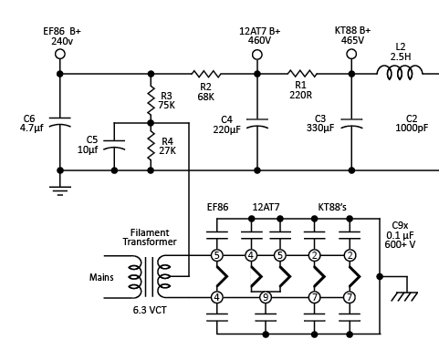

You'll also want to have some 0u01-0u1 ceramic disc caps (600V or more) from each heater pin to the chassis.
I need clarification on this. We need a cap on EVERY heater pin? 9 total?
And when you say "to the chassis", are you implying the ground line on the secondary of the power transformer is not acceptable for this and we need to create a separate line going to the chassis earth from the IEC power connector?
..Todd
..Todd
Well, not from the ones shorted together- they'll just need one. So for each monoblock, you'll have 8. They go right to the chassis, not to the ground wire. That's usually easy to do, since the tube sockets are generally mounted on the chassis, and you can either add a solder lug under one of the mounting screws or use the type of tube socket that has integral solder lugs.
..Todd
See Morgan Jones 'Building Valve Amplifiers', page 117. Decouple the heater to the chassis with 10nF capacitors wired between the valve pin and a solder tag mounted with a star washer at the valve base mounting screw.
I think that's how I got 9. I guess you mean to also short pins 4-5 on the 12AT7 and use 1 cap for them?

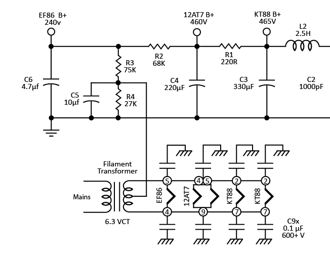

Yeah, I realize that. I was thinking more about to how to draw it on the schematic. See attached pic.
..Todd
Yes, with the understanding that each cap is individually returned to chassis, not to a common lead which connects to the chassis. The Building Valve Amplifiers reference will illustrate this beautifully.
