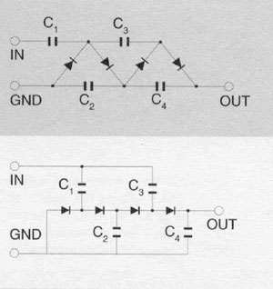

Look at the graphic I've uploaded. It was "ripped" from VMI. The 2nd schematic is the subject of interest. That's for a positive setup. So, turn everything upside down, to get a negative setup. IMO, it's self evident about how to squeeze 1 or more negative voltages out of a single low voltage winding. That 1/2 wave parallel topology places equal stress on all the diodes (Schottkys please) and increasing stress on the capacitors.

That could be one good idea as the Antek toroids are missing the big negative voltage winding!
Another way to get the negative supply is to add windings, toroids in particular comes in very handy for that simple mod and would be more stable and cheaper.
I have done this and it works perfect, here is how you do to find out how many turns are needed:
Make 10 turns with an arbitrary wire temporary, plug in the transformer to the mains voltage and make a VAC measurement with your multimeter, let say you got 4 Volts from the temporary winding, now you know for every turn you get 0,4 Volts (4 Volt / 10 turns.. easy).
Next you have to set for a negative voltage you want, let's say 55 Volts...
now we have to remember that when we measure with a multimeter it takes the RMS value which means its not the peak voltage, BUT when we rectfire and filter the ripple voltage the filter capacitors charge up to the peak value.
For sinus shaped waveforms such as the mains voltage the peak voltage, Vpk = Vrms * 1,414 (the 1,414 is the square root of 2 and applies only to sinus, not triangular or square waves or other shapes)
Back to the equation, we found that Vrms for one turn is 0,4 Volt, so Vpk would then be 0,4 * 1,414 = 0,56
Next step is to obtain the final amount of turns to get 55 Volts for our negative supply, and we calculate it as follow.. 55 / 0,56 = 98 turns
but we make it 100 turns to compensate a bit for the diode voltage fall and for a nice and even figure.
Now we just have to add a rectifier bridge and one filter cap and we are done, Voi la!
Tried to be as pedagogic as possible so even noobs could do it but ask if something wasn't clear.
