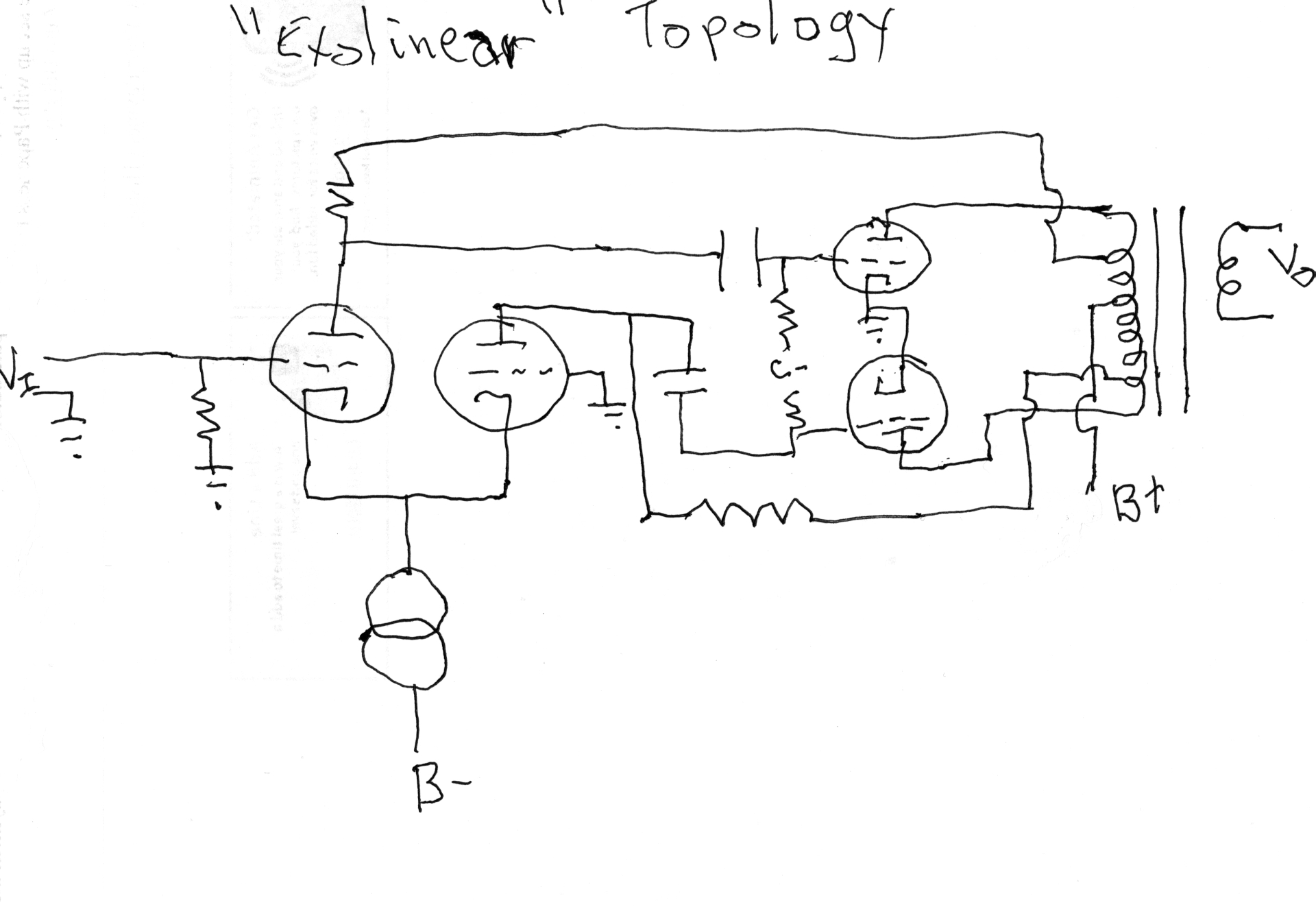

I don't know if a 6GK5 pair LTP produces the gain needed to drive KT88s. I've uploaded a CRUDE schematic of "exolinear" topology. You'd have to use cascodes in the LTP, but the high gm of the 6GK5 makes it an excellent choice at the bottom of a cascode. Perhaps "Bandersnatch" will post in this thread. He has experience in constructing hybrid cascodes and such an "animal" might be best.
Thanks Eli! unconventional use of the screen taps..........hopefully bandersnatch will chime in here..

Yeah, it's a "sneaky" way of implementing short loop plate to grid NFB. You'd use regulated g2 B+ in pentode mode and take your Hashimotos to their limit.

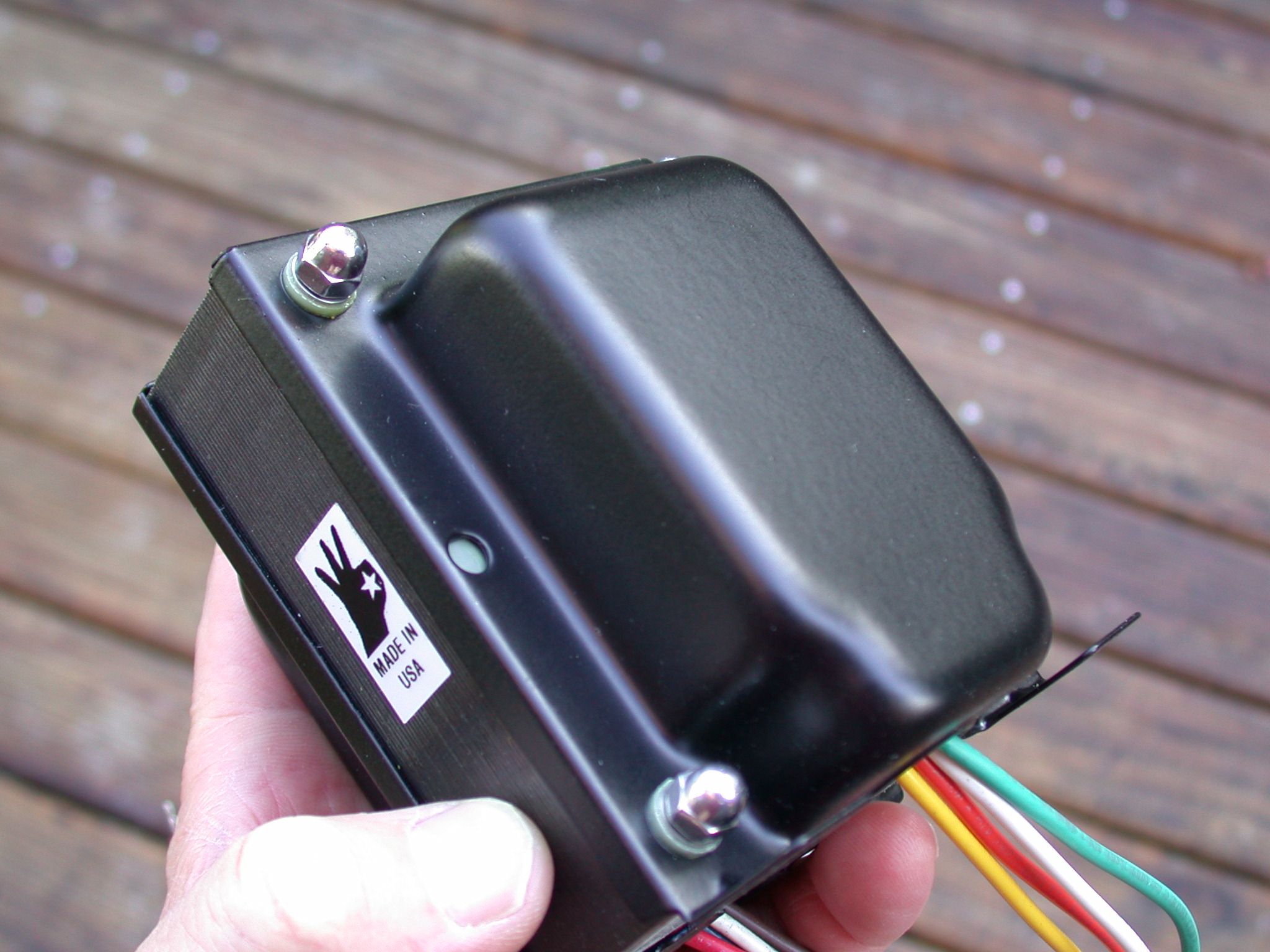

I wonder if they would do them in black?
Like this? Removed the end bells, bead blasted the blue (to remove the gloss), then sprayed with Rustoleum satin black. Finishing touches were stainless screws, with stainless acorn nuts. Kinda looks like an electraprint now..
