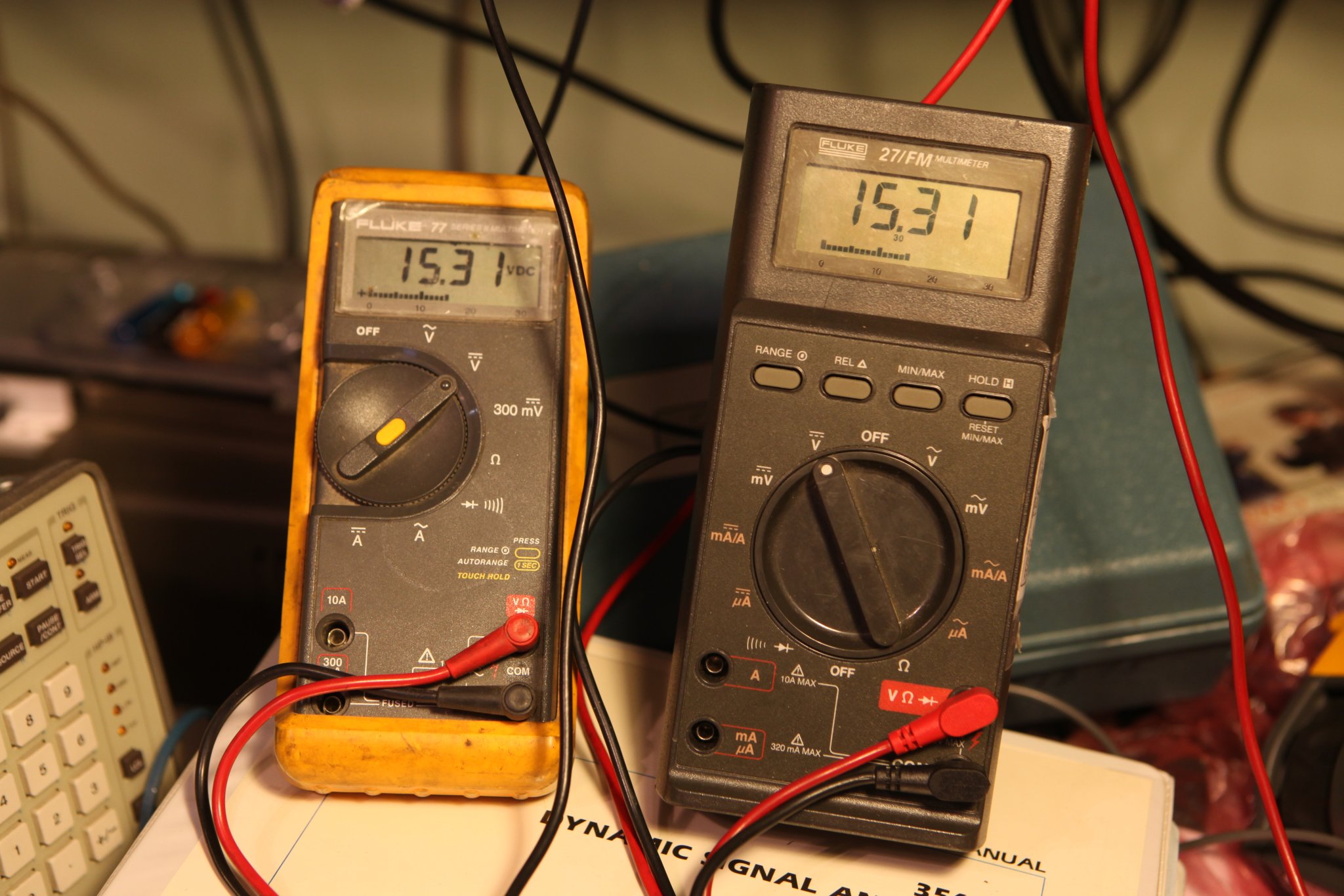

Surplussed a few about ten or so years ago 🙂 I bought my ex US military Fluke 27 for £40, 27 years ago and have been using it ever since 🙂If you're ok with used, why not get a Fluke? Look on the Bay of Evil for a Fluke 27/FM - the US military surplussed a few zillion of them ten or so years ago, and there are plenty available for well under $100. It's about the size of a brick, and can double as a blunt force weapon in a pinch, but is a very reliable meter.

I had a look on eBay and yes, there are quite a few for sale in the US (the 27 I mean). Postage/shipping is always too high nowadays though, at least to us here in the second most remote city in the world!
