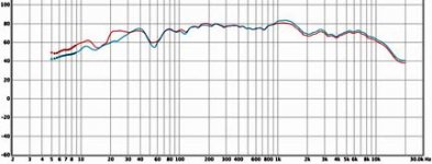

In the attached acoustic measurement, the orange trace is with two subs playing: a corner Klipschorn and a giant OB midwall (Stephens 150W, around 1960, has a resonance at 20 Hz).
The darker trace is with the OB off.
The addition of the OB, perhaps just by luck, results in flatter levels esp. at 20, 40, 55, and 110 Hz.
Taken with REW software, 1/6 8ave smoothing, Radio Shack meter correction, one mic location at listening location.
My impression is that diverse mix-and-match of auxiliary woofers is good policy.

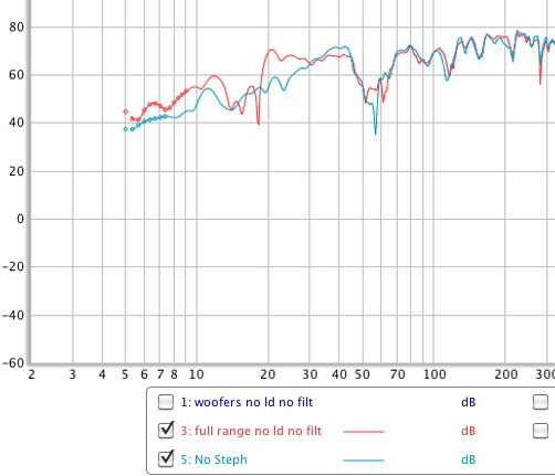

One problem with this type of measurement is how much of the output is doubling and how much is actually fundimental bass. Despite Klipschorn's huge size, I'd expect that below about 35 hz, its response would fall off a cliff. AR1W by contrast is designed for a system F3 of 42hz with a 12 db per octave slope. At 30 hz, it's about 5% THD, still very respectable. Its relatively gradual slope makes it equalizable. How does AR1W compare to the Klipschorn within AR1W's power handling capacity? I'd expect it would do better especially when equalized. What's your opinion?
Much too coarse. If you want to show performance at low frequencies then frequency resolution should be 1 Hz, i.e. smoothing 1/24 octave or better. Showing the response up to 150-200 Hz is sufficient.

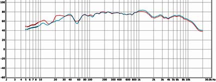

Too coarse? Smoothing is there to create a picture that illuminates some issue not to "hear by eye."* But, attached are unsmoothed curves. I patiently await learning from Markus what the earlier, 1/6 smoothed curves may have concealed (and what insights are now revealed to him) by unsmoothing the curves, apropos this discussion.
The longer curves were presented to foster (and illustrate) the matching of the with-Stephens and without-Stephens curves.
Soundminded points out,
"One problem with this type of measurement is how much of the output is doubling and how much is actually fundimental bass. Despite Klipschorn's huge size, I'd expect that below about 35 hz, its response would fall off a cliff. AR1W by contrast is designed for a system F3 of 42hz with a 12 db per octave slope. At 30 hz, it's about 5% THD, still very respectable. Its relatively gradual slope makes it equalizable. How does AR1W compare to the Klipschorn within AR1W's power handling capacity? I'd expect it would do better especially when equalized. What's your opinion?"
Traces were made at pretty low levels like 70-80 dB and so no doubling likely. But as the level goes up, chotchkas in the room do start to jiggle. On the other hand, you can see the levels are well above the noise floor. I don't want to over-sell the enduring significance of these quick and crude little curves. They illustrate one point suitably and that is all. That is what good experiments do.
Yes, the Klipschorn (the bass unit of which is not terrible "huge") does "fall off a cliff"... exactly as my curve shows. But I was quite surprised at how much oomph there is low down. And even more surprised at the low bass of the OB!!! I sure don't know what is going on when I look at the response below 20 Hz.
Only Klipsch and Stephens in light trace. The dark trace is only Klipschorn. No AR-1. I haven't done measurements with the AR-1 and my new REW software. But the AR-1 with a bump around 42 Hz is a great, full-sounding woofer. I've been arguing that except for fans of earthquake movies, there's not much on recordings much lower and few speakers make organ music (esp. Saint-Saens 3rd Sym) sound as good as the AR-1 with the 12-Hz driver.
The curves have EQ so they don't represent any kind of natural response of those speakers. Also, as mentioned previously, the RS meter correction (LF only) is present. They do represent the very salutary effect of adding a second, profoundly different woofer to the ear-location results.
*Evaluating by eyeball the terrible visual effects (but trivial aural effects) of comb filters is an example of that fallacy.
What's the frequency resolution of the unsmoothed data?
Modes can have a very high Q so our eyes need to be able to see what our ears hear, hence 1/24 resolution is needed.
In your graph there's a huge 25 Hz wide "hole" around 50 Hz which I would fix. These kind of holes are tricky because something that cannot be heard can't sound bad. Beside of that, this another example why measurements are vital in order to improve sound reproduction.
