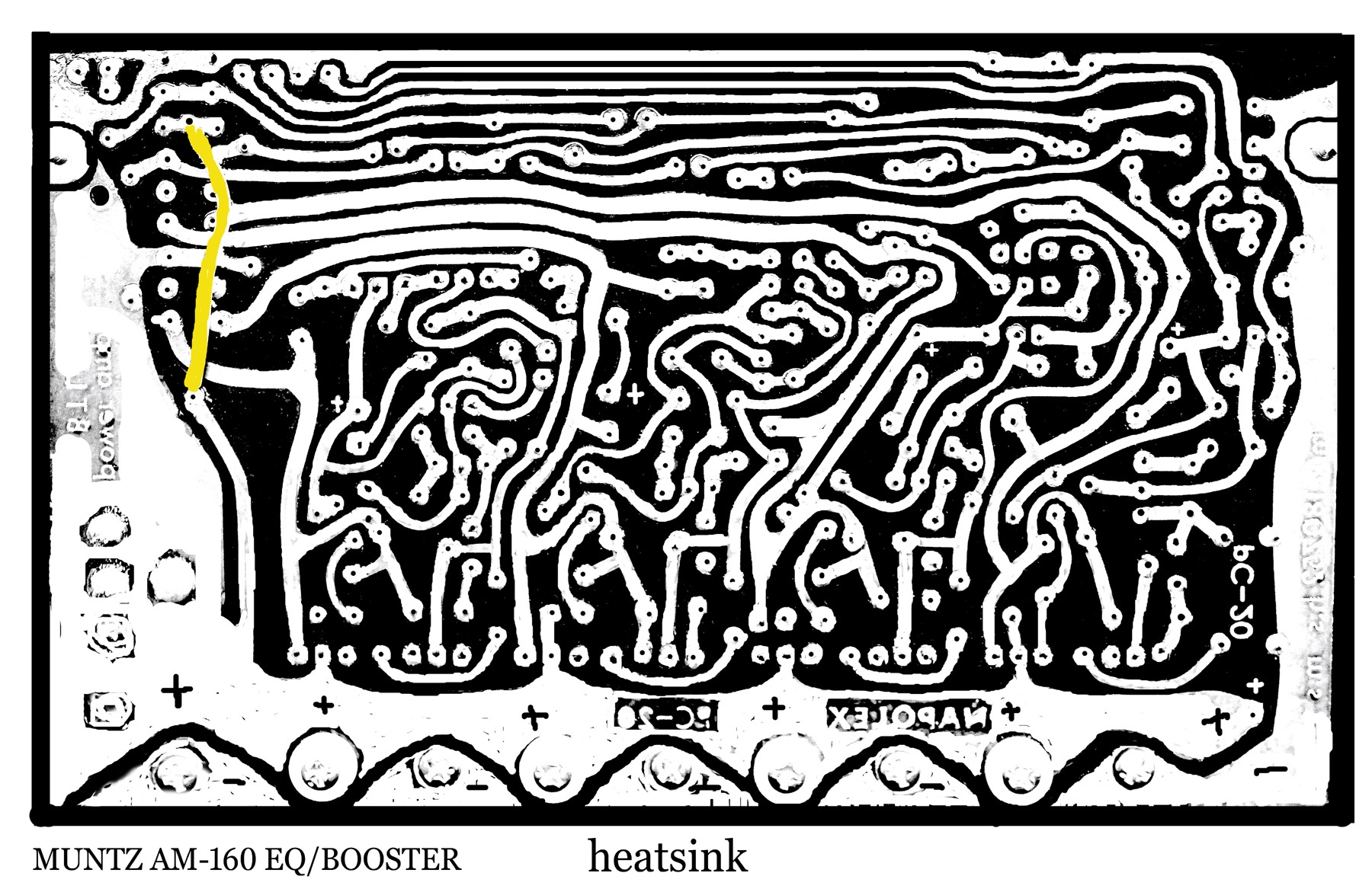

That image there is still being massaged... I have yet to actually examine the BOARD to get the final product, then superimpose the component side onto it in several directions.... FULL COLOR too.... I am Adobe Certified... CISCO too... BDBD/2022

the Turtle won the race.... I have nothing BUT time Perry.... waiting for the Grim Reaper here so... no rush, instead an EXERCISE... I will use my Degree for this schematic, exercise my brain and learn from doing so. Perhaps a pencil drawing would help me compartmentalize this layout, I get that. My PENCIL WORK in Art Class was among the worst. In a BOX of HAMMERS, I am the SLEDGE. BIG... hands... THAT BEING SAID, I purchased a CLASS D "SPL GORILLA 2400 watt" amplifier... 35 bucks on ebay, It hits PROTECTION upon power up and my LIGHTBULB lights up so.... NEXT!!!!.... I start to apply what I have learned from your SITE on something more along them lines. Thanks again for your inspiration... FUN FUN FUN...BDBD/2022Wouldn't drawing a diagram be much quicker?
upon first examination it appears that BOTH rectifiers died as well as a SINGLE output transistor. So far thats what my meter tells me. The MAIN POWER INPUT is not shorted, no BEEP when i checked for that. I am sure once ya POWER IT UP, them power inputs will short as they LIT my headlight nice and bright. Time to buy some more Transistor stuffs.... Keep ya posted, BDBD/2022the Turtle won the race.... I have nothing BUT time Perry.... waiting for the Grim Reaper here so... no rush, instead an EXERCISE... I will use my Degree for this schematic, exercise my brain and learn from doing so. Perhaps a pencil drawing would help me compartmentalize this layout, I get that. My PENCIL WORK in Art Class was among the worst. In a BOX of HAMMERS, I am the SLEDGE. BIG... hands... THAT BEING SAID, I purchased a CLASS D "SPL GORILLA 2400 watt" amplifier... 35 bucks on ebay, It hits PROTECTION upon power up and my LIGHTBULB lights up so.... NEXT!!!!.... I start to apply what I have learned from your SITE on something more along them lines. Thanks again for your inspiration... FUN FUN FUN...BDBD/2022
Ahhhh maybe rectifiers are OK... I get a short BEEP but no real short to the center leg on either outer legs, which do short as you mention as a result of the transformer they are attached to. OK... rectifiers appear to be OK, ONE output transistor is surely bad and I am probing the POWER SUPPLY transistors and some seem to have a short between the center leg and one outer leg. Only a couple, the rest are NOT shorting between any legs. I will triple check your SITE and recheck them transistors a few more times before I warm up the soldering iron. Hope its only transistors..LOL... BDBD/2022upon first examination it appears that BOTH rectifiers died as well as a SINGLE output transistor. So far thats what my meter tells me. The MAIN POWER INPUT is not shorted, no BEEP when i checked for that. I am sure once ya POWER IT UP, them power inputs will short as they LIT my headlight nice and bright. Time to buy some more Transistor stuffs.... Keep ya posted, BDBD/2022
Likely 3 bad output transistors... the HOT side of the amp it appears as theres a temperature heat switch on that side but not on the other. I will pull these and see what I can find online... ONE QUESTION... do I change all 3 OR all 6.... Hmmmmm..... BOTH SIDES. One side appears fine, other side has some shorted transistors for sure. OK.... BDBD/2022Ahhhh maybe rectifiers are OK... I get a short BEEP but no real short to the center leg on either outer legs, which do short as you mention as a result of the transformer they are attached to. OK... rectifiers appear to be OK, ONE output transistor is surely bad and I am probing the POWER SUPPLY transistors and some seem to have a short between the center leg and one outer leg. Only a couple, the rest are NOT shorting between any legs. I will triple check your SITE and recheck them transistors a few more times before I warm up the soldering iron. Hope its only transistors..LOL... BDBD/2022

ahhhhhhh maybe just ONE output transistor... I PULLED the OBVIOUS bad one and then tested them others and NOW they are OK... no shorts. I BET this cheapo amp has a mismatched transistor set from the factory. Thats what makes better products is that MATCHING of components. CHEAPO.... they toss whatever they have in there and if it passes the test its out the door.... Premature blow up, like a ticking time bomb. WELL who am I to bump heads with them TECHS...LOL...... SO I gonna order ONE FB31N200 transistor and install it in that spot and see if it powers up.... if it does then check for HEAT.... no heat.... HAPPY AMP.... OR... buy a whole set of 6... These are sorta difficult to remove from the board I have found REALLY just want to get this thing to operate.... CHEAPO Learning Experience.. Uggggg.... Just another day.... BDBD/2022Likely 3 bad output transistors... the HOT side of the amp it appears as theres a temperature heat switch on that side but not on the other. I will pull these and see what I can find online... ONE QUESTION... do I change all 3 OR all 6.... Hmmmmm..... BOTH SIDES. One side appears fine, other side has some shorted transistors for sure. OK.... BDBD/2022

ALRIGHT...... Managed to replace ALL the capacitors. Each and every time I changed something there was IMPROVEMENT in sound BUT... STILL one side DISTORTED.... Ugggggggg..... Maybe RESISTORS?.... I went and checked all them resistors and they all seem to measure OK.... Hmmmmmm SO... PROBE A MANIA. ... as it turns out a POWER TRANSISTOR was showing a strange reading in comparison to them others so.... MORE TESTING.... I THINK I FOUND IT... Transistor SEEMED to be working IN CIRCUIT but upon removing power there was a OPEN LUG... Not that obvious BUT upon REMOVAL I found it to be BAD. Bad transistor right next to that one that was OBVIOUSLY blown. SO... ORDER another transistor and HOPE for RELIEF........ I been at this MUNTZ now for over a month..... GREAT LEARNING EXPERIENCE. I am getting much better at soldering etc. Cant Wait till the transistor arrives and see...... I HOPE i can finally get this EQ to operate and sound good..... I have the GORILLA Class D amp transistor on its way tomorrow so.... More to do. I WILL get this done. BDBD/2022
