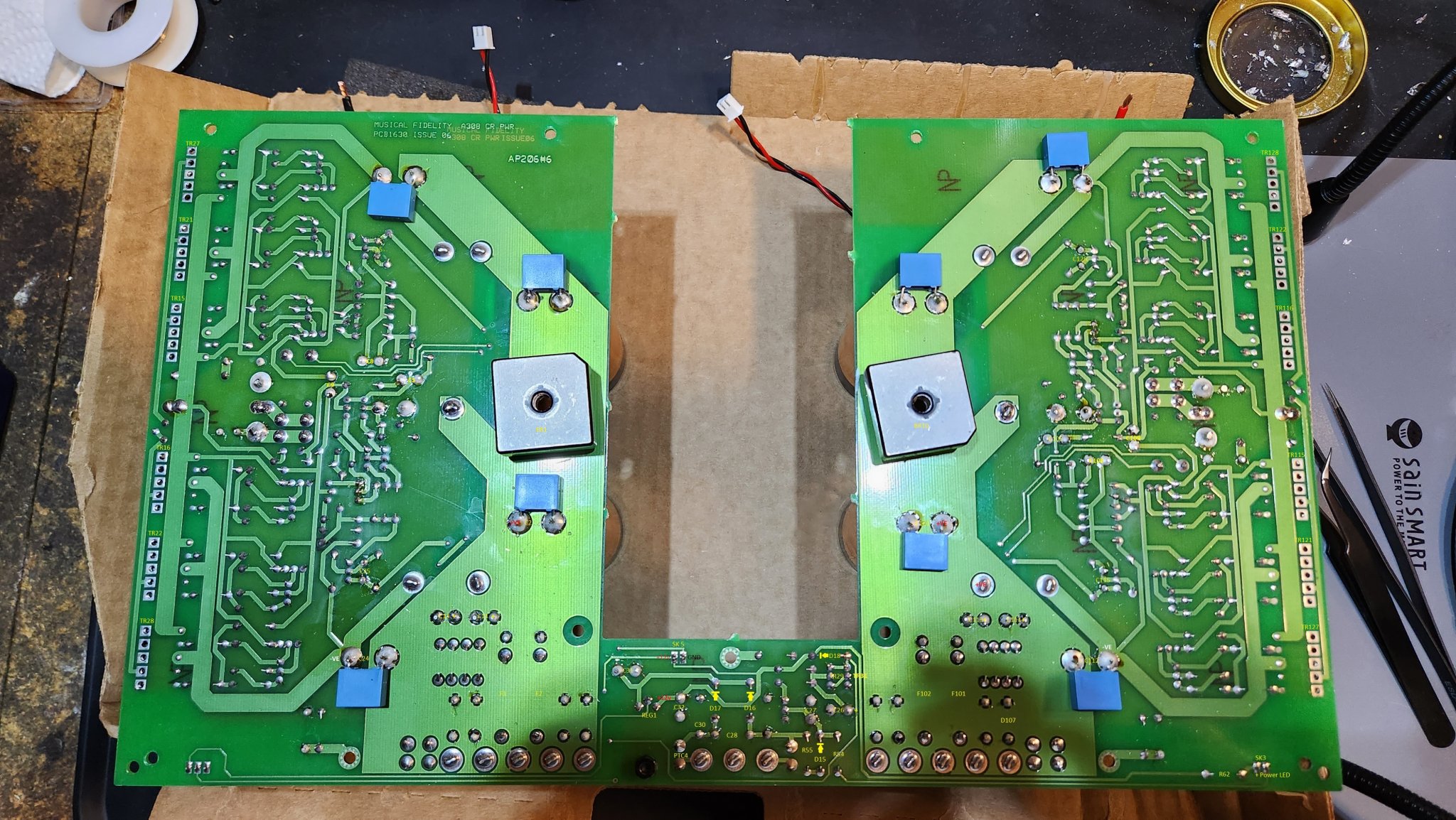

I will check everything you've mentioned but while you were posting that, I went off on a tangent following something I thought was unusual. I checked the AC section, specifically the power distribution board and measured for continuity. My multimeter went off showing continuity between live and neutral.
I checked to see if all three toroidal wires were shorting somehow and it turns out it wasn't the wires, it is the toroidal transformers that show continuity between the neutral and 120v wire. The two large transformers are showing around 1ohm reading, which I assume is fairly normal. The third smaller transformer is showing 36 ohms. This is with disconnecting all the additional wires going to the main board. I'm going to assume that isn't normal and could very well be the problem of my issues. Luckily it's the much smaller toroid of the two, but now I have to worry about sourcing a proper replacement. What do you guys think?
![cQsZiJC.jpg](https://i.imgur.com/cQsZiJC.jpg)

NickKUK, yes I figured that. I just wanted to show the board and wiring where I showed measurements of continuity between live and neutral wires. I did not realize it was normal for Transformers to show this reading. I'm assuming the 36ohm reading on the smaller transformer also checks out? If so, I'll reassemble everything back and continue to diagnose with yours and Protegimus' suggestions.

They were Nick and I've already mentioned that, however thewiredninja did bypass the board completely with an input and said he still experience the same symptoms.
I've asked him to take a look at C27 and C32, C32 was
replaced with
metal film. C32 is the REG1 +12v regulator reservoir capacitor, metal film are not usually recommended for this purpose as their very low ESR can cause instability. 12v rail does measure 11.9v, don't know if AC has been checked through a 0.1uF. +12v regulator supplies the input PCB, not sure what else.
I raised this as from the photo's that's the only thing I've spotted so far that looks incorrect.

Image is with replaced component numbers overlayed:
More the buzz is the concern, which does sound like a grounding issue or shielding issue. I see the wires to connect input to mainboard have been replaced - were the original wires shielded?
