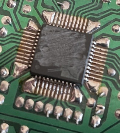

This is a TEAC CD-P3500 with a fancy box and a tube output stage (x-10d?) I find it interesting to compare reviews of the two, and lose all faith in 90's hi-fi rags... the evidence is there "MAIN PCB 9155118101" - hats off Mr Michaelson, well played sir!
Also grinding the chips but not the board markings? Come on... OK this was before the internet but surely any idiot reviewer would be able to spot the chipset from it's layout? why the effort? - apparently it was enough :D
Not to be defeated MF both put a shield above the board and used security torx before you got in :-D I'm laughing because it's not hard to listen to is the truth. I don't know, there maybe something in the; 'huge (valve) input impedence makes op-amps work better', claim...

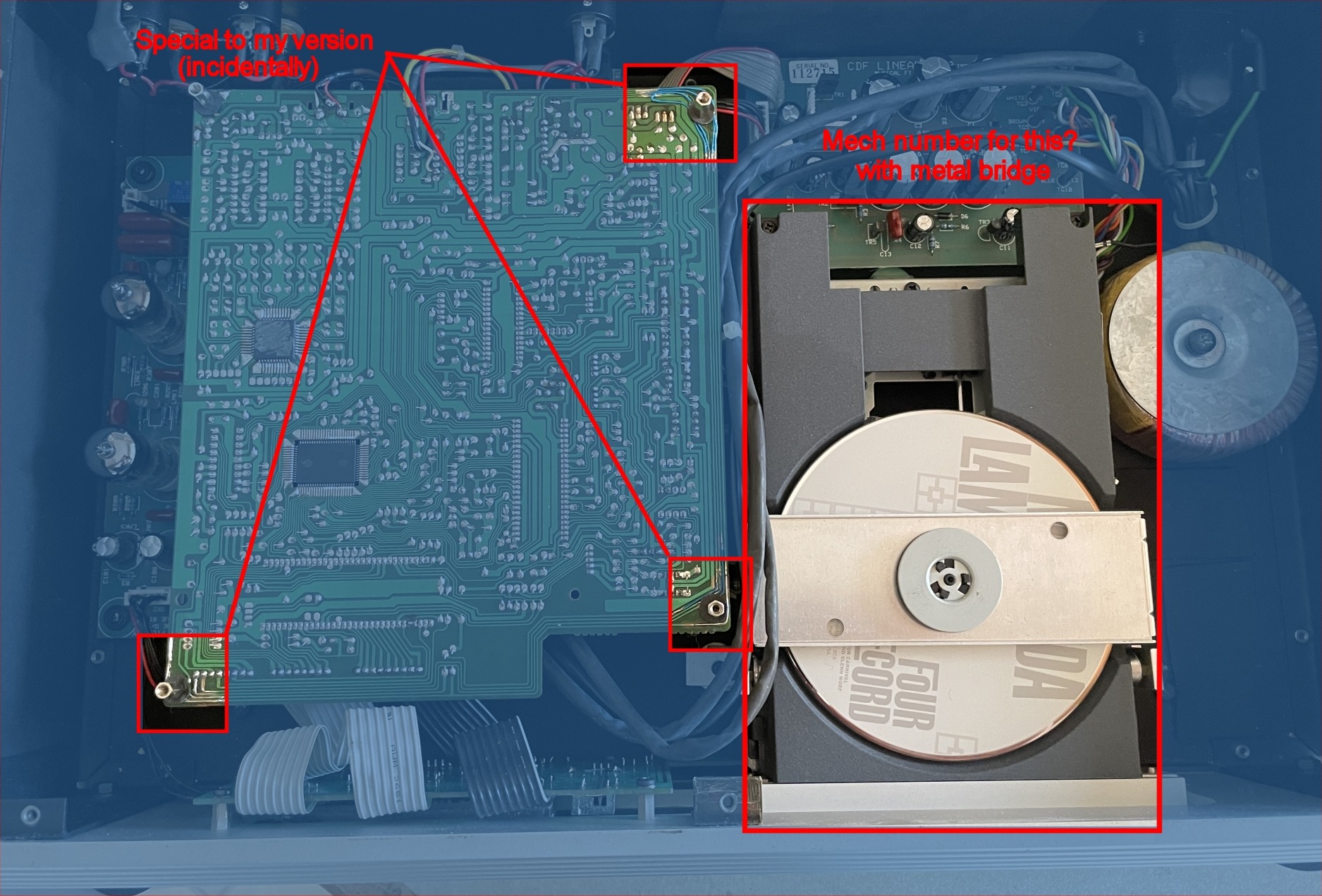

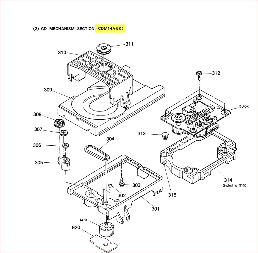

Looking for a bit of help - the FCD has a KSS210A pick up, attached to KSM210 mech then attached to a what?? Looking for a code for the whole assembly. I'm sure this must be child's play and I'm being dim, but I can't see it. I'm not talking about the laser 'block' or the sled mechanism, but the whole bit with the drawer etc
For example, a CDP-M18 has this clearly listed as CDM14-5K - so in that case a CDM14 with BU-5K sled right? But what about this one with the metal arch? See pic.
As is my weird trait :geek: I'm modelling these up in 3D for 'reasons' Starting with that CDM14. at least until the CD-P3000 carcass arrives :devilish:

Turns out, its often printed on the mech KSL210AFM

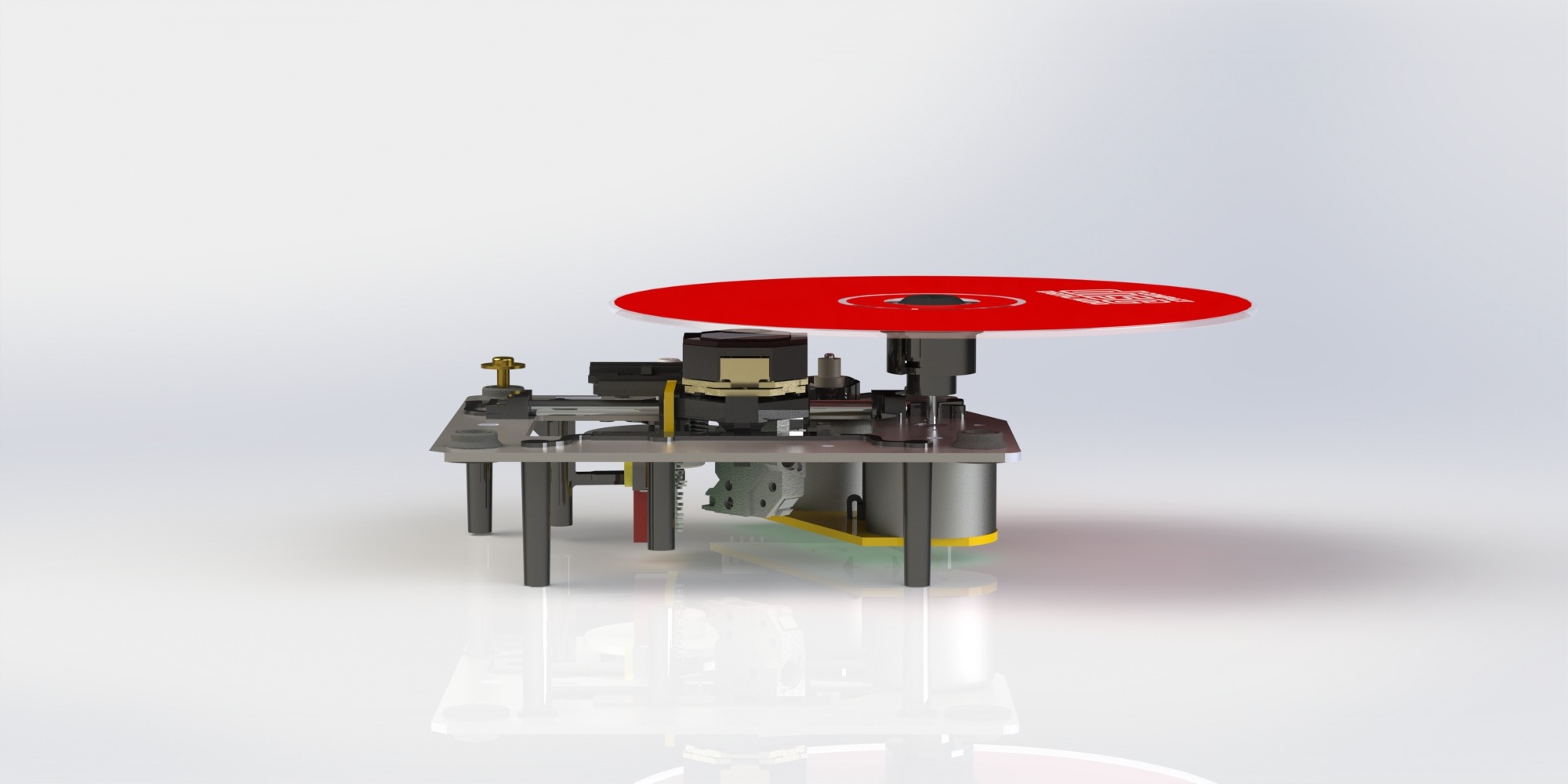

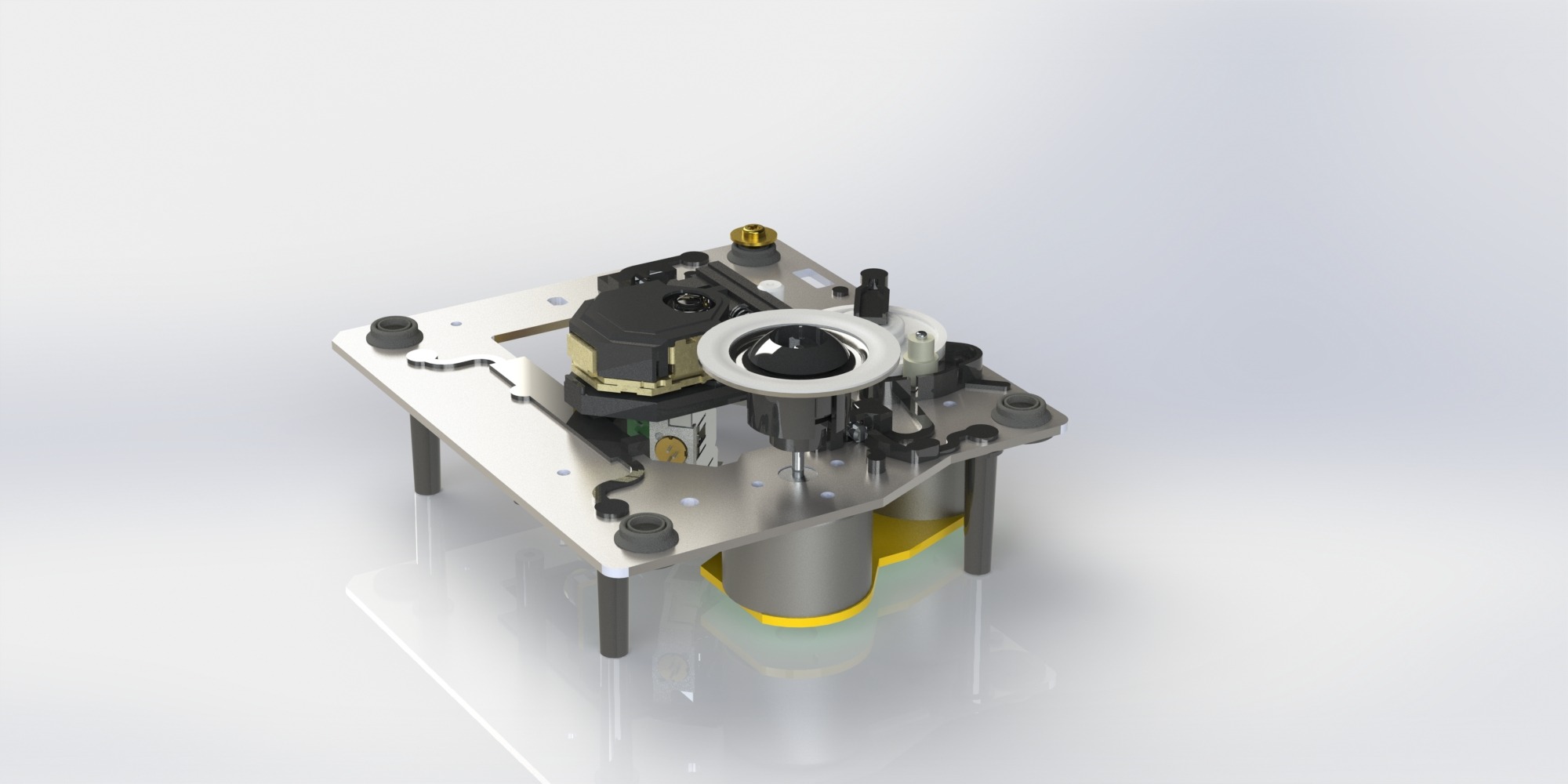

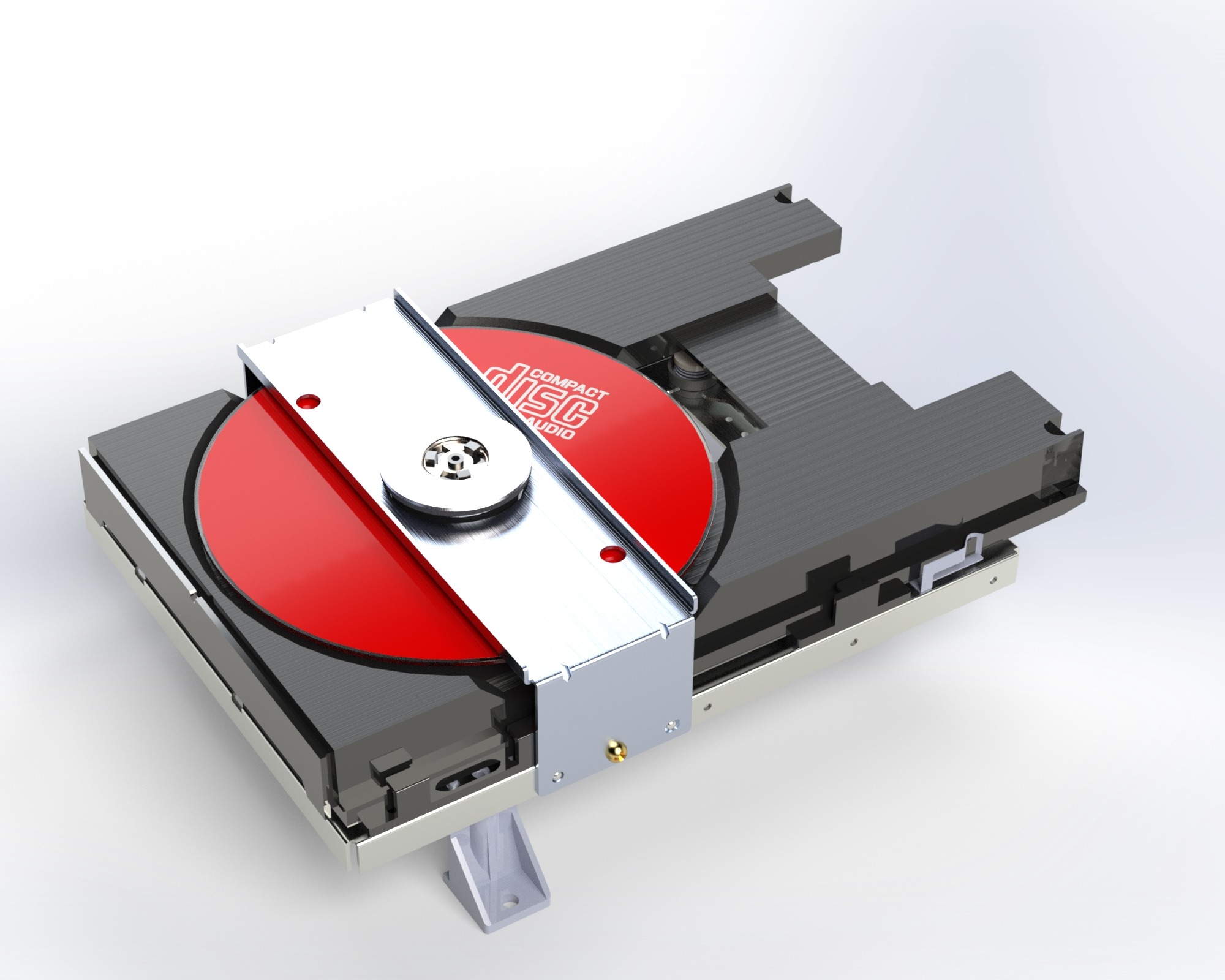

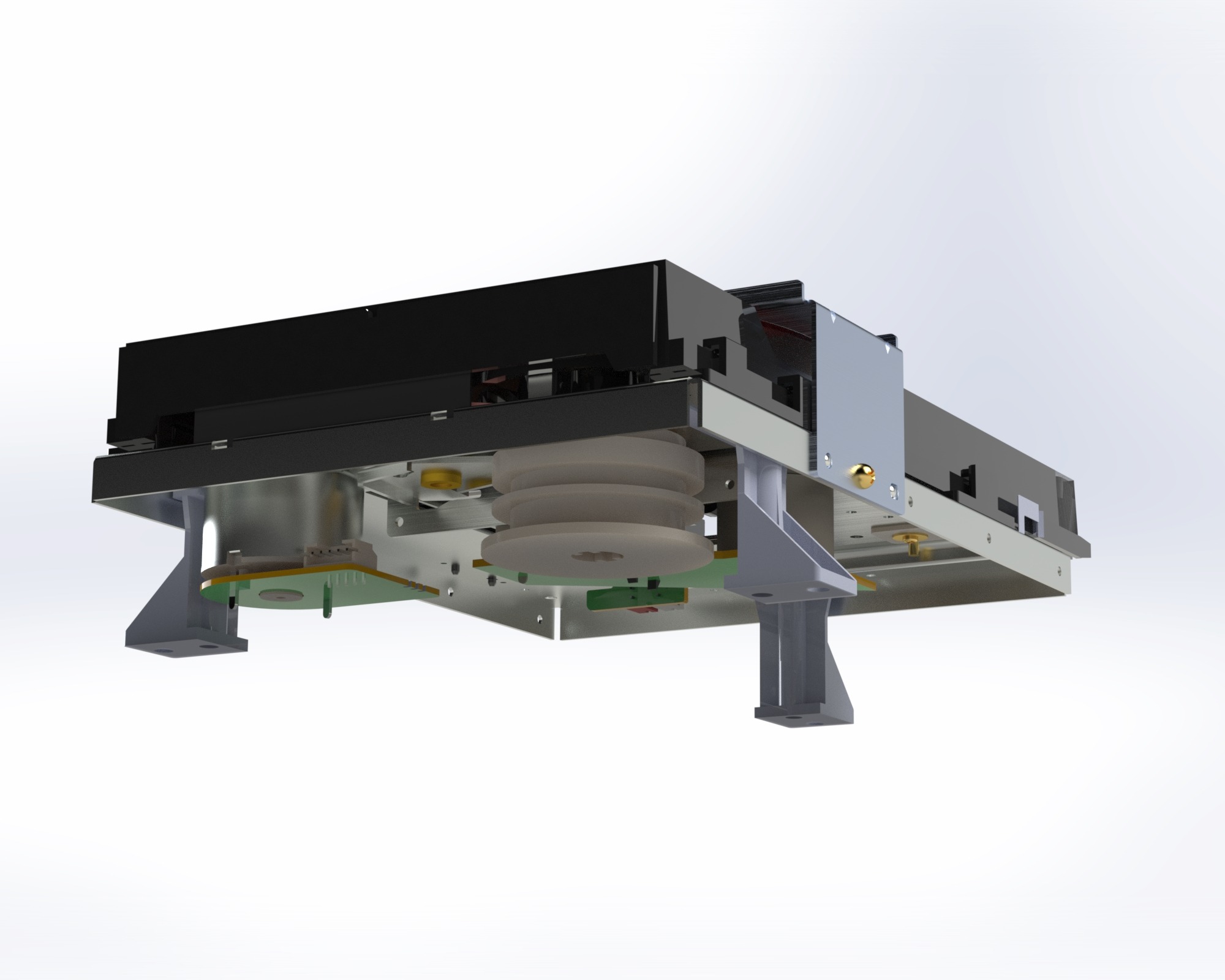

In anycase I also did a thing with CAD, look at the pictures of the KSS150A model Yes I KNOW its very niche but for a work in progress I'm happy.
Now on to that KSS210, hope that some parts are the same :/
Also a suitably low bow to the Sony engineers. The baseplate itself is a masterpiece in value engineering (anyone can be clever with a limitless budget, MUCH cleverer to achieve the same but so people can afford it). The laser diode assembly feels like you have something from NASA in your hands tho :D

As a mechanical engineer, It might be lost on the wider audience here explaining how much fun there is to be had in the cost VS functionality journey between the KSS150 and later KSS210 mechanisms :)
its especially fun as the '150 can have a plastic loader and the '210 has a shiny metal one. you'd be looking for the KSL150 which is "best" all round I think

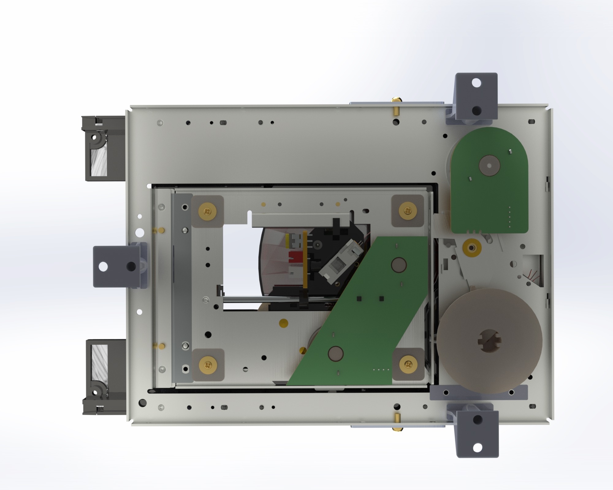

Slowly zooming in on this project though, slowly being the word
Andy
