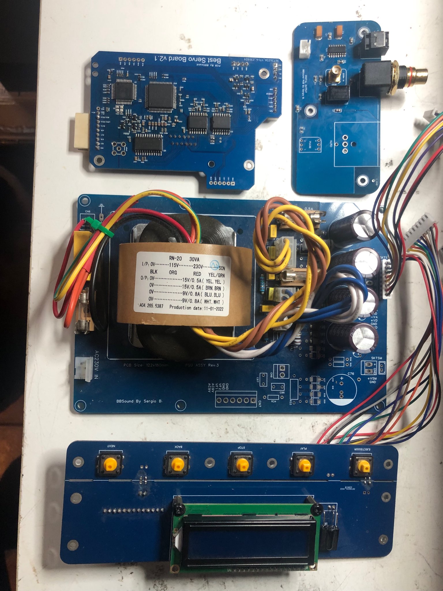

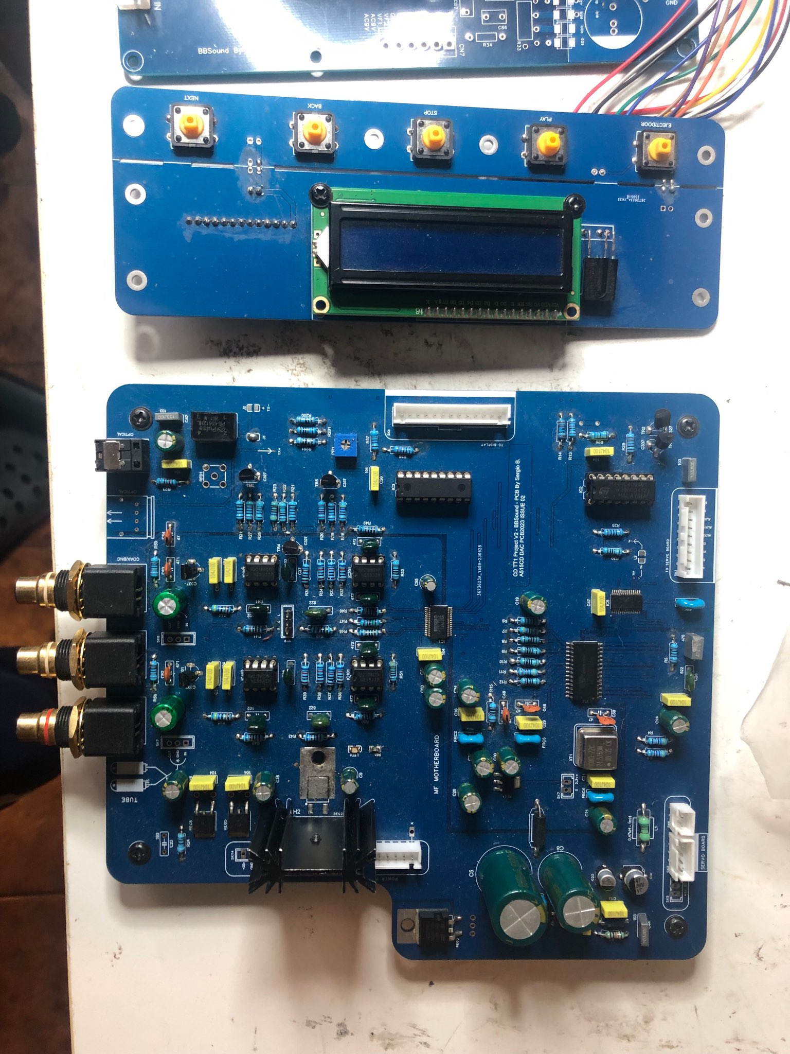

The fact is that you should focus on one thing, the mechanics are controlled by a servo board, and the servo board is not easy to find. I would have solved this problem by recreating the servo board for the CDM12xx so I would have solved this problem, also I would have used a Musical Fidelity A3.5 CD player and completely redesigned the boards, boosting the power supply and creating various connection options, including the possibility of connecting a tube card or an external DAC. In this case the CD player firmware is stored on a PIC16F88 and therefore copyable and that's what I did. In practice I created a CD player complete with controller, servo board and various options... everything works very well.

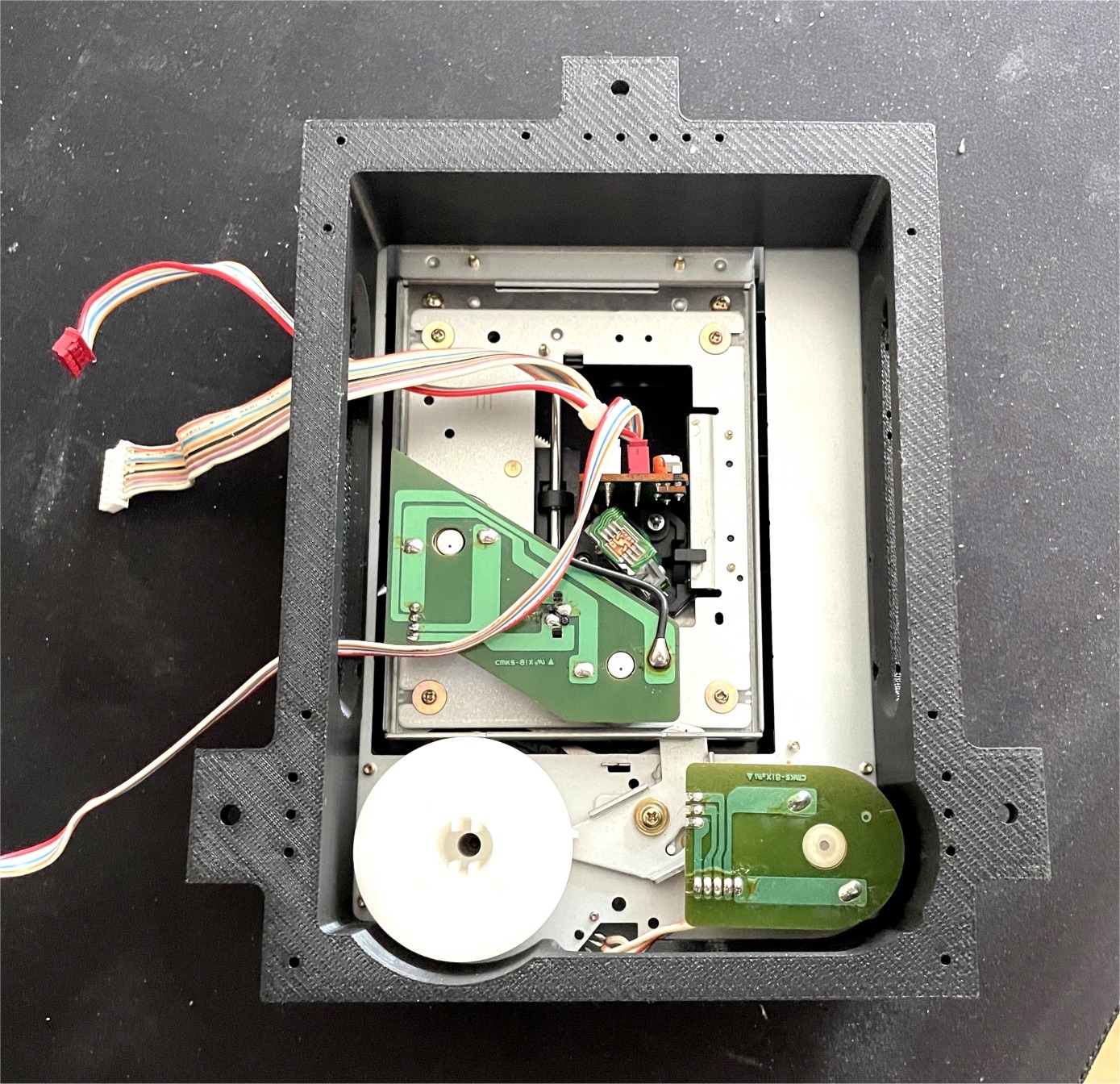

I made a brace for the mech with an eye to stiffening / damping the steel chassis - see pictures. Slightly smug that it fit first go to be honest, but I'm also aware that if you think everything is going well its a sure sign you've missed something
This is a dead mech BTW don't panic

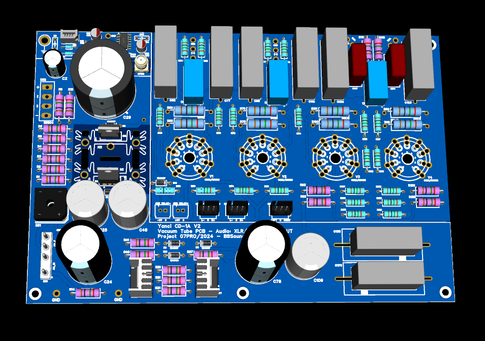

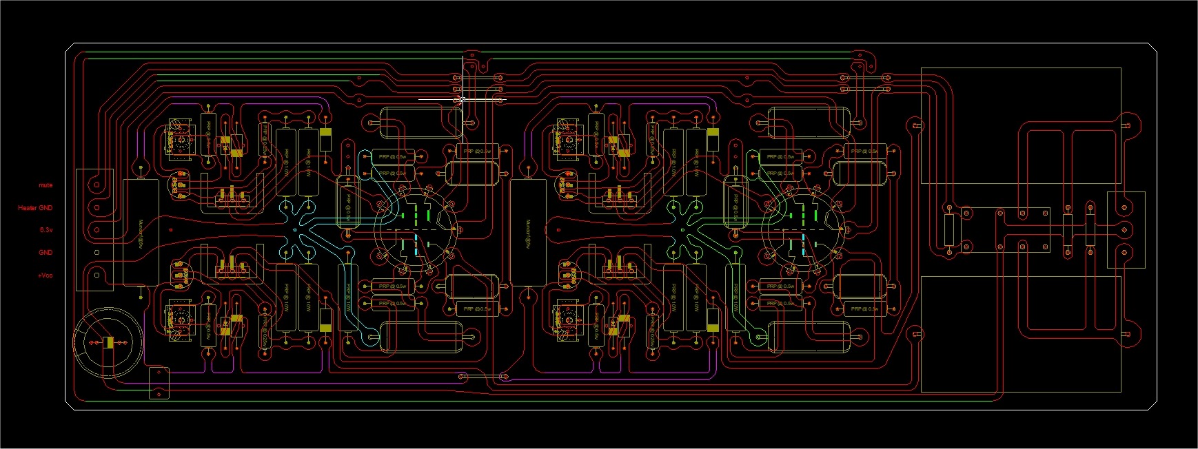

Another bit - Buffers because why not start at the end and work back??
Taking shape - needs dimensioning. It's just a directly coupled buffer stage with some 'sand' in it.
The associated PSU that I still need to look into, will supply the tube heaters in parallel and much more than 24 volts for the B+ supply!!
Andy
Andy

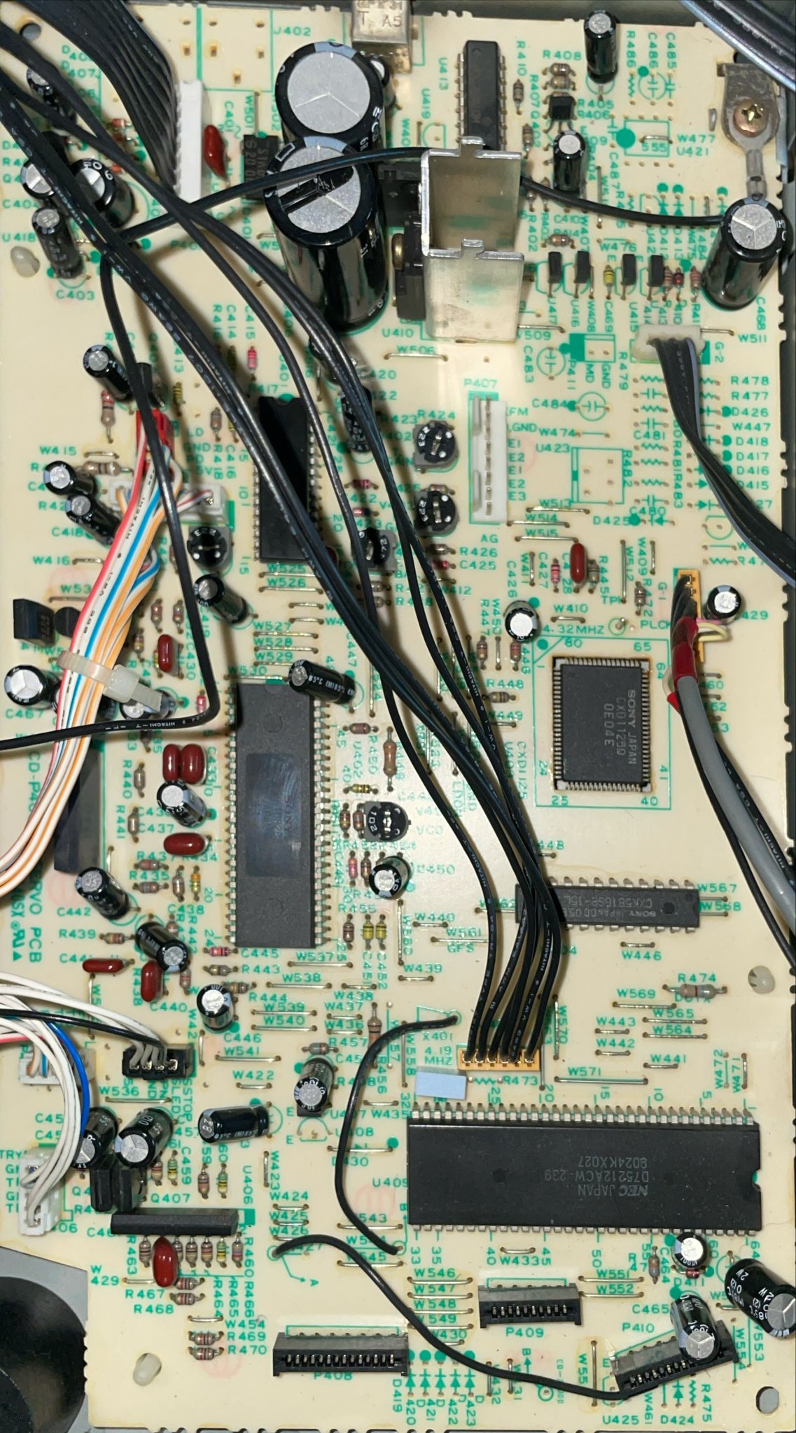

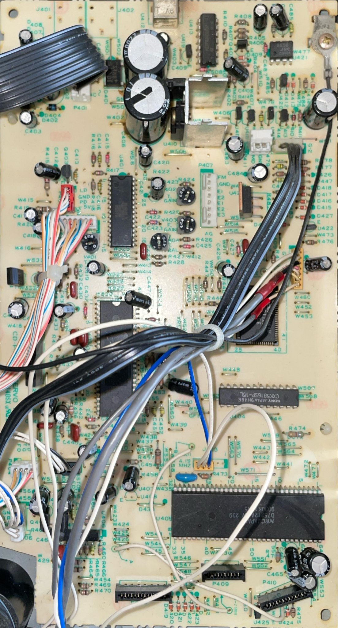

So another tangent to wander off on - a "side quest" as the youth might say: converting CD-P4000 to Z5000
Turns out the way the clock is handled is different but it should just be a case of adding a handful of diodes (D419-D423), a resistor (R473) adding some links (w472) and moving the 'B' link wire around the microprocessor (D75212ACW)
see photo's. P4000 is the one with empty sections
There's quite a lot missing from the P4000 servo board and I do wonder if it's just be easier to replace the mech rather than the other way around (how hard is it to adjust focus gain and so on, seems 'not novice')
Otherwise P4000 is missing a 555 timer circuit that's seemingly devoted to turning the display on and off, as well as a regulator and circuitry for motorized volume control, neither of which I need.
