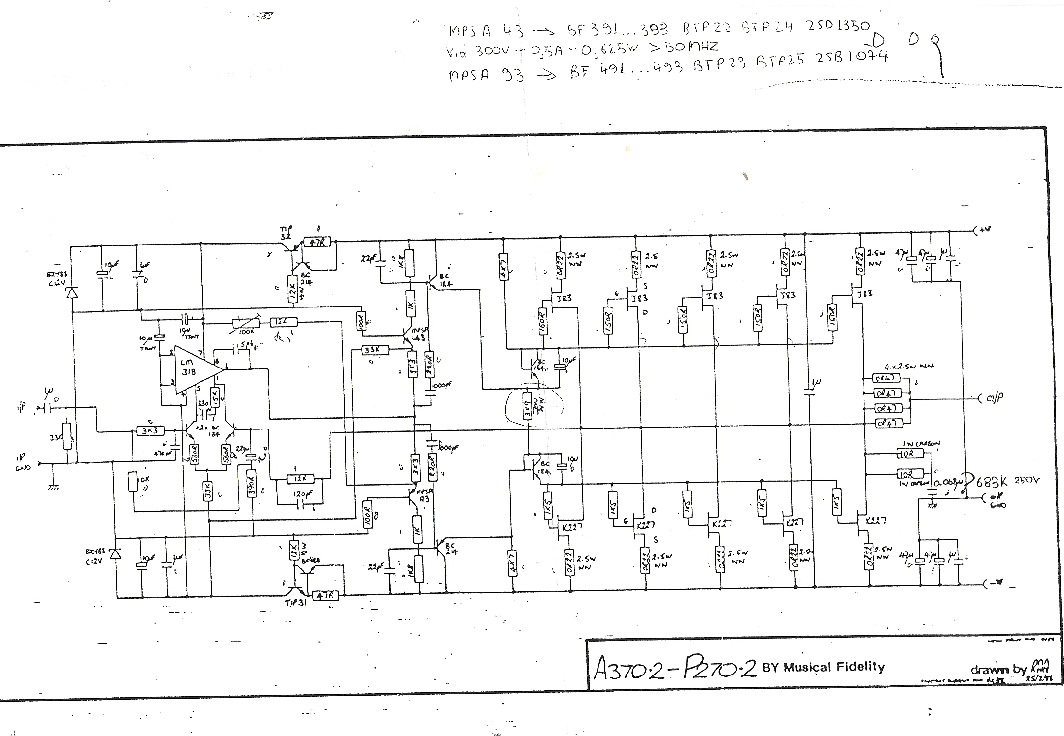

On the p170 and P270Mk 1 the LM318 is the input pair. On the P270 Mk 2 the input pair in the lm318 is disabled and replaced by discrete transistors. I think you will find the lm 318 sounds very good in its own right as it is a high speed op amp. I have still to find an advantage in changing it out - and I have tried a lot of alternatives.
For the burned out voltage drop resistors on the rails I have swapped the original 5w resistors for 25w resistors and the temperature is just ok then. Later models use a pass transistor instead of a resistor to eliminate this problem.

You know, the sad thing is that there is no reason at all to run them that hot. A simple transistor regulator will do the trick nicely. I used to do the same thing you did. Mount new resistors to the chassis or heat sink assy. You are further ahead just not dissipating that much heat to begin with.For the burned out voltage drop resistors on the rails I have swapped the original 5w resistors for 25w resistors and the temperature is just ok then.

P170 temperature measurements
My first post .
I recently acquired one of these and heard that they ran hot . so I measured the heatsink, driver transistors and an internal with various scenerios Lid on/off and also raised off the deck by 100mm and a fan cooling the internals - results are in the attachment.
- measured the 1k5 resistor which drops the @60v to 12v - and after 60mins with the lid on they measure @ 68c at 20c ambient (lid on) .
The bias was left at 61mv - my main concern was to see the effect of various thermal scenerios.

I have found this schematic for the A370.2 and P270.2 - it includes the current mirror circuit to reduce the 60v down to 12v .
And I think that the 4 x 1k5 5w resistors from +60v to Gnd are only there to aid power reservoir discharge - I'd imagine that without them there are dc thumps galore on switch on/off.
