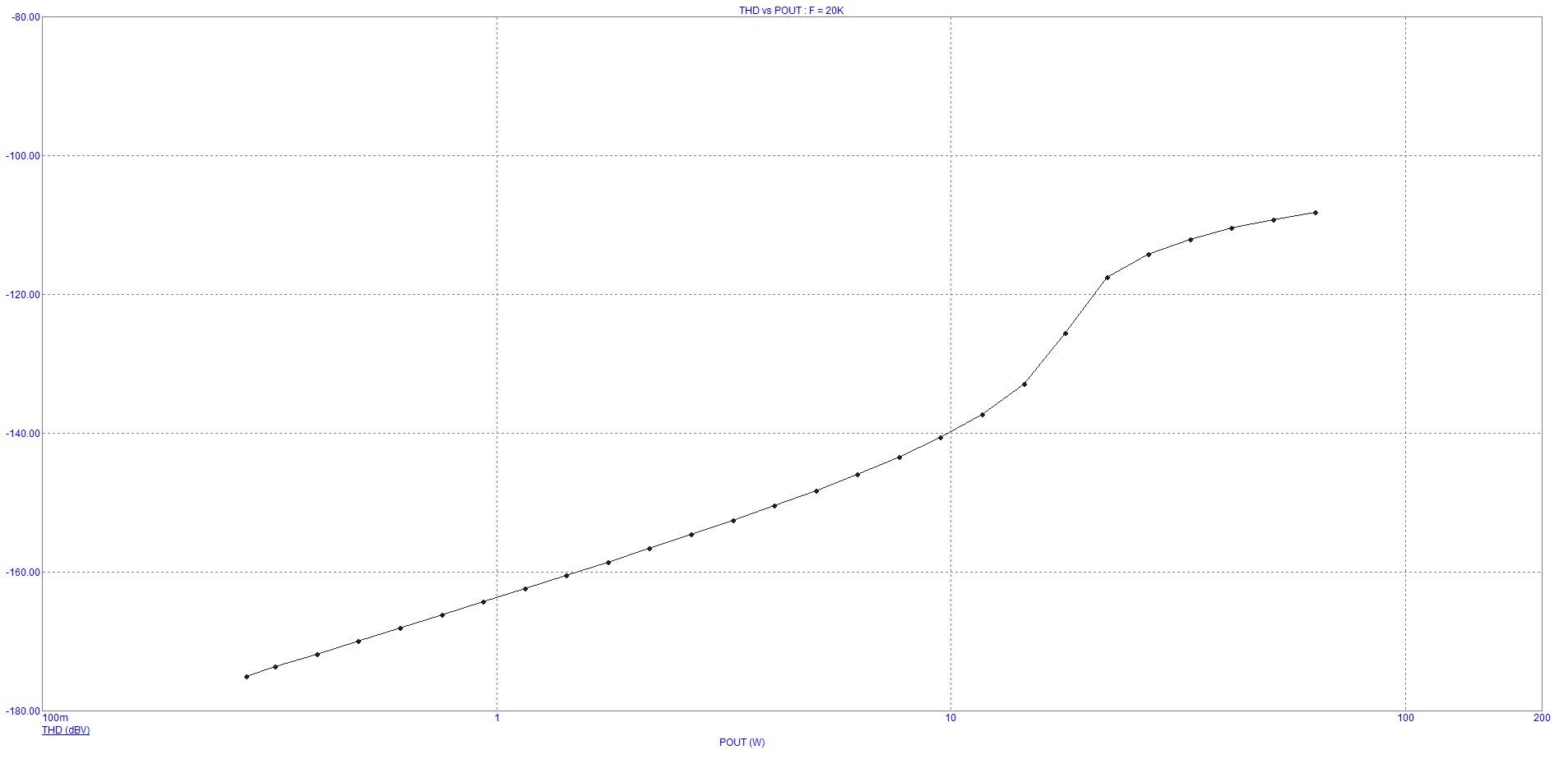

Very impressive. Did you already built this amp ? Would be nice to compare these results to a real test.

How do measurements compare to simulations, of course when also using this simpler model for the simulations.
The reason I ask because IMO Microcap for whatever reason produces figures way below LTSpice. My experiences with LTSpice are quite close to real circuitry.

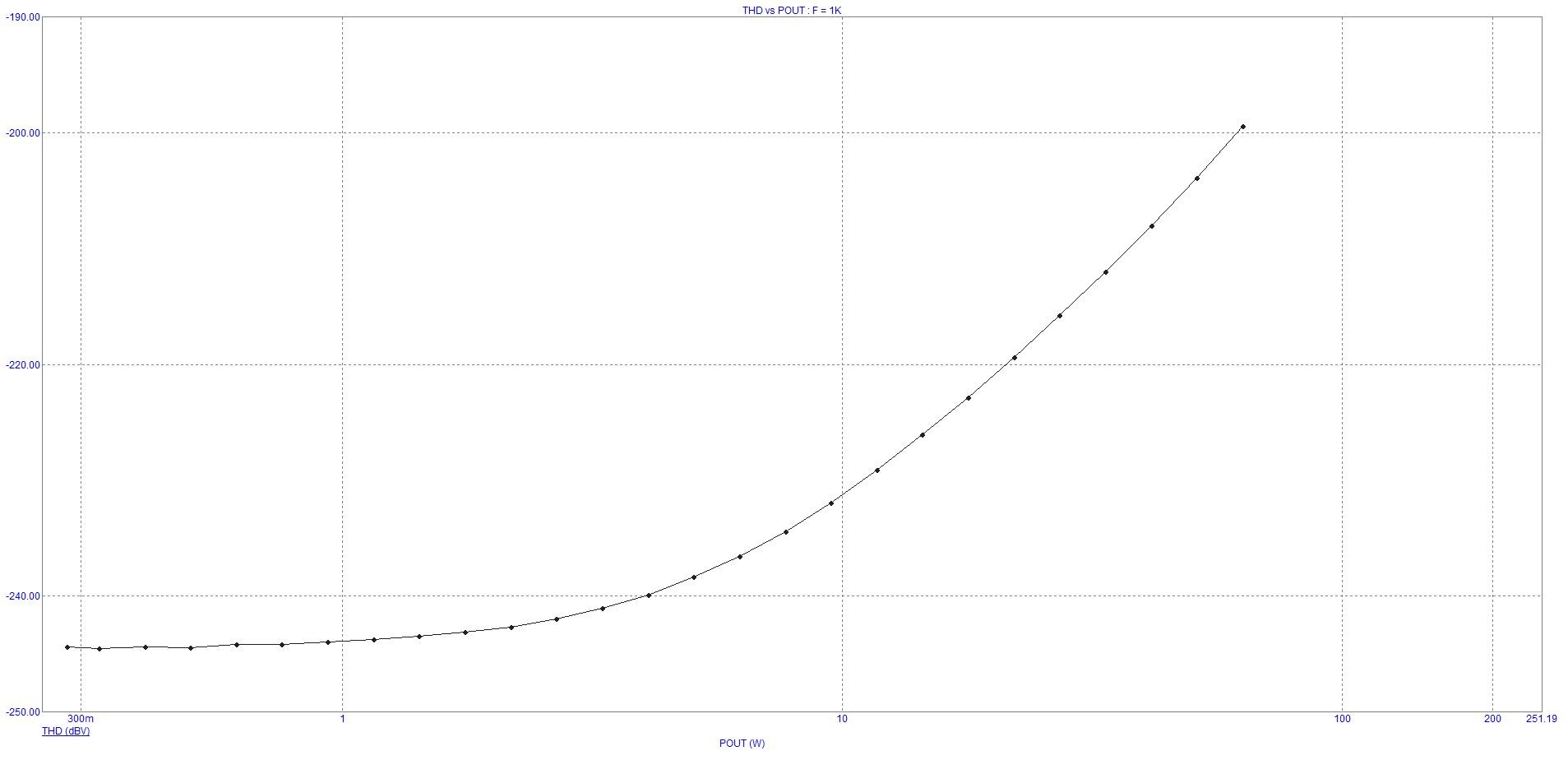

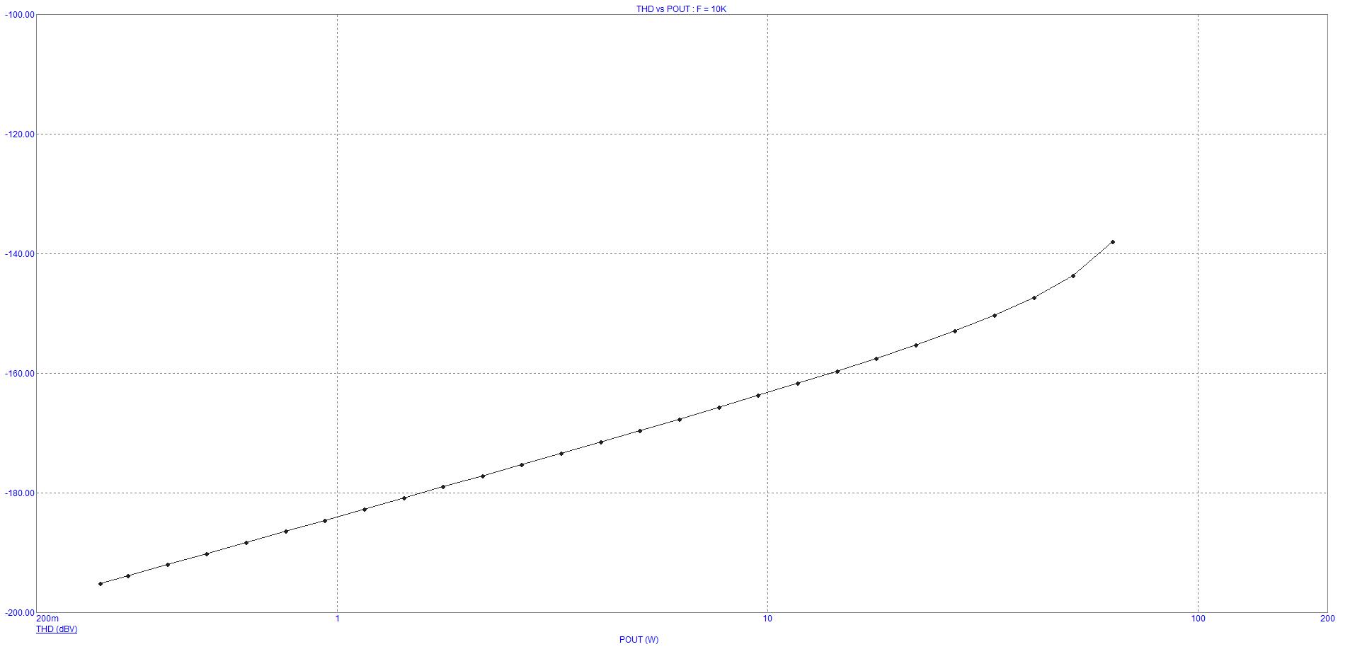

Bernhard, that looks very good. The difference with the 1k plot suggests an opamp and in the case of discrete semiconductors, compensation that doesn't include the output stage.

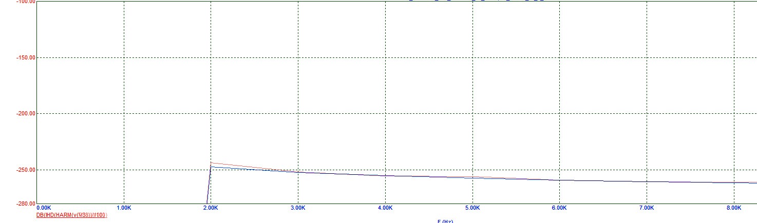

Indeed interesting what the difference between sim and measurement will be. In some cases with tube amps I ran just the FFT in a transient analysis and the results were in agreement with the direct THD sim. BTW to get identical results for "periodic steady state" and "unticked", often 500 cycles are needed at 1k.

Yes I can see you are using Microcap, that’s why I was curious to see how this compares to a real life measurement.I built a bit simplified circuit because at the time the schematic was just like that, less refined.
Never used LT spice but the Microcap simulation resulted in a working amp...
Simulations showing less than -140dB distortion are IMO too nice to be true.
