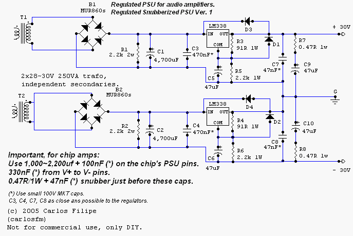

DcibeL, Thank you for your advice.
I have a further question for the transformer and shall be grateful if you could help me.
If I use that transformor for the Mauro"s Lm3386 with the attached PSU, can I do that with just one transformor?
I have some doubt of the output in V if I just parellal the output. Will it became +35V 0V- 35V?
I have not make any diy for almost 15 years and all memory are gone.
Accept me my silly question.

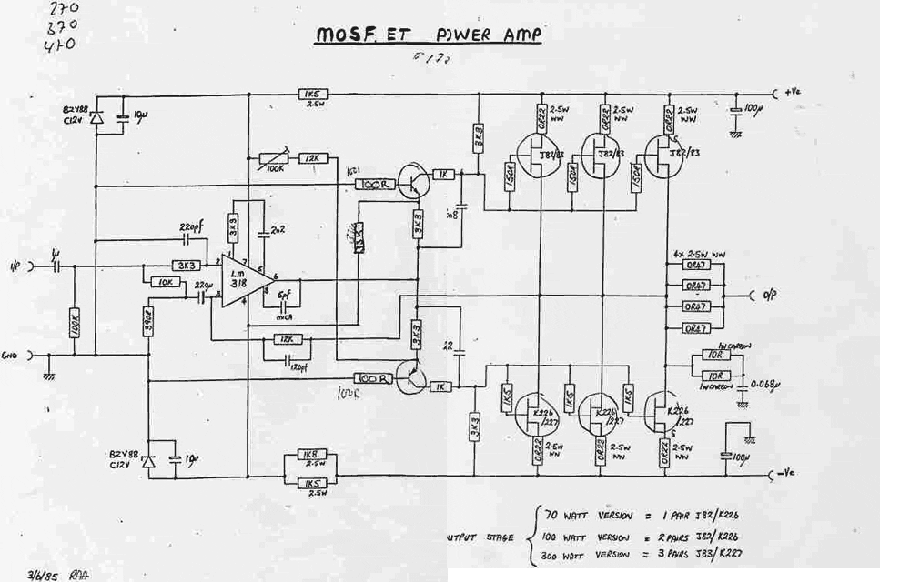

Hi All
Mauro did mention right in the beginning the inspiration for this little amp was the MF A370. after some digging (i was looking for circuit to replace my existing mosfet amp's circuit "kraftwerk clone") i stumbled on this circuit. and we can also see where he is comming from.
something i am going to build just to compare if it has the same signature
Cheers
Rudi

Hey Rudi,
I think that schematic is for the P170/P270/P370
I'm not exactly sure what the difference is between an A370 and a P370. Maybe Mauro can say if he heard this one (A370.2):
Or something more like this (P180):
I have a P150 and P170 in various stages of renovation (they are '80's amps) My P150 is a very nice sounding amp, and I aim to compare them all (RevA, RevC, P150, P170) when I get a chance.
Michael

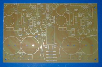

PCB ready gold plated
Just arrived the PCB from Mauro's Rev.A gerber.
Slighty mods:
reduced spacing between board edge (side LM3886) and Lm3886 pin to avoid interference with heath sink: tested ok, PCB does not touch heatsink with Lm3886TF (isolated)
Added a extra hole for mounting
Added wire connection on silk layer and AA BB letter to facilitate the individuation of point to be wire connected
Added few pad for SMD 0805 Rev. C component mounting or helping to solder the trditional one on solder (copper) side.
No solder so all the trace are available to solder some future components or mods
70um copper
Gold plating to avoid oxidation and make better contact.
Top view:
