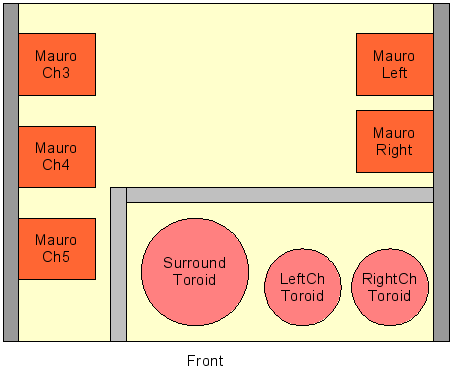

5 channel amp layout
Hi.
I'm beginning to think about my 5 channel power amp layout, and need some feedback.
What I'm thinking is to have a pair of Mauro monoblocks each with their own toroid for the front stereo channels, and 3 Mauros as surround channels fed from a single toroid.
This should give the best of both worlds if I do it right. I'm thinking of having 2 powerswitches - 1 for the stereo amp, and one for surround, so that I can eliminate current draw and heat from the surround amps when listening to 2 channel material.
Layout attached, feedback welcome...

Just to be controversial, I would question whether you really need the metal between the transformers and the PC boards. I have my toroid on the Ref_A about a half inch (~10mm) from the edge of the board and the amp is still dead quiet. I like that the layout that uses the capacitors as a shield between the power section and the signal section and it seems to be quite effective. And I won't even start on my leanings towards symmetry that would put the center channel amp in the center. Only opinions, so no offense intended.
hayenc,
No offense taken
I'm sure the layout will get pushed around quite a bit, it's probably a couple of months away. I could run the toroids down the centre of the case, and I had drawn that at one stage, maybe that's a better idea, it would certainly make it more balanced to pick up and carry. Of course your symmetry instinct is important, it should sound and look good. I'll keep tinkering with the layout, I need to do it to scale.
Michael
No offense taken
Michael
We also have the option of orienting the boards vertically rather than horizontally as is typical....or anything in between....
Barredboss will cut heatsinks to your specified lengths. This will promote a taller case if you wish.
Interesting, I hadn't considered that. So, if I were to pinch the spacing down to 60mm per board (I think the 10,000uf elcaps are the highest component at 50mm), I could fit 5 channels in 300mm... Boards down one side, trafo's down the other. Would probably need a ventilated case to go that dense unless the revC doesn't heat those resistors like the revA...
Would packing them in like that impact the sound at all?
Michael
Hi Michael,
What difference is ? you speak of the 2W res. in place of 1W (more warm) ?
I suggestion to use always chassis with ventilation holes (on 2 sides, top and bottom), to have a good air exchange. The heat goes always toward on top, and everything that is over to the heat sources ( power res, LM3886, zener ) suffers the heating.
The components the more sensible to the heat is the ELcap...
Ciao
Mauro
