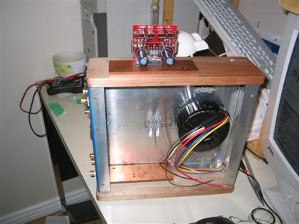

I recently completed my tripath TK2350 and all I can say is that it outperform anything else.
I encourage people to mess with the current design because improvements are always welcome. I am currently working on something that might be interesting to some of you and I will share it as soon as I have completed the build and done some listing.
basis for my new experiment

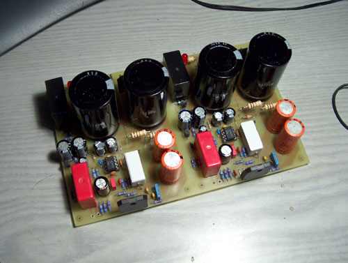

Here is the new boards for my Ref C. as usual I like to use the dual bridge rectifiers.
But as bonus in the name of "experimentation" and to evoke comments I would like to add the following finding from NAIM. For the next finding to be true you need two bridge rectifiers per channel.
Naim found that if you swap the phase of the one secondary in relation to the other then you get a much better bass note. (Why this is I do not know) but I am going to try it on these little amps. Now it could be true that the change is significantly more noticeable when you use two bridges feeding a stereo pair. (As I have done with my Tripath, normally thin in the bass region, but now it is phenomenal deeper and tighter than any other amp I have listened to)
The other option that I have with my configuration is to use a trafo secondary per rail (one trafo supply just possitive and one just negative.). In effect giving each rail its own transformer.
just some food for thought
Rudi
