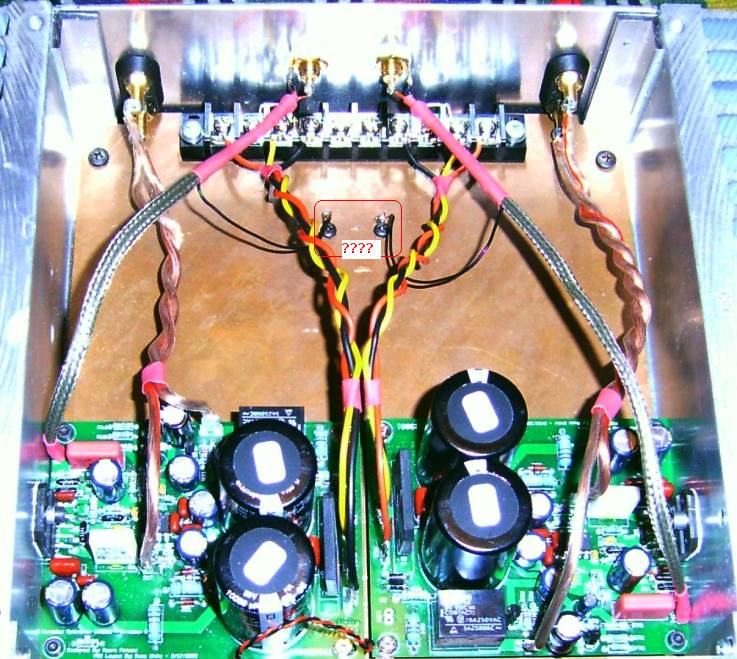

Well, that (nearly) did it. All what´s left with open inputs is a little, but clearly aubible hum. With CDP connected I got to put my ear at the speaker to hear it. I´ll try conventionally shielded input cables and shielding the wires from trafo too. Tinker, tinker ...
Russ White said:It looks like you have your shielded cable attached to your case which is attached to mains GND. As a test try leaving mains GND unconnected and see if the hum goes away.
rabstg said:Is your trafo center tap connected to the chss or pwr grd?
It´s connected to power ground. trafo has 4 secondaries, I use 2 of those per mono-amp.
Beleive it or not, you can connect the pwr grnd from the AC to the chassis, and NOT connect the secondary cntr tap ground to it. Then there will not be a grnd loop between earth and pwr.
As long as the input AC grd is tied to the chassis the cahssis can't become "live", and any pwr issues in the chassis will be grnded out to the AC input grnd.
The cntr tap grnd should remain "floating" from the chassis and AC input grd. As should the signal ground from the RCA's.
If that is done, I would then tie the signal sheild you have to the chassis again. But only once the AC grd and the secondary grd are seperated.

By "floating" you mean the center tap ground isn´t connected neither to chassis nor to AC ground. That´s what I did before. RCA jacks are fully insulated. HUMMMM !!!

Regarding you amp, it looks like you are using the shield of the signal cable to connect to the chassis, and at two different points. (!)
Am I right?
Disconnect those wires from the chassis.
I mean these two wires I'm pointing out on your pic.

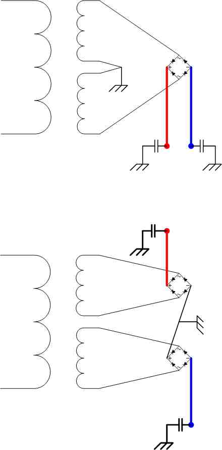

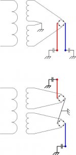

I see a dual secondary trafo... I can only ASSUME you are using 1 bridge rectifier and are paralleling the pwr leads from the supply to the two broards.
I ASSUME the first configuration correct?

carlosfm said:Regarding you amp, it looks like you are using the shield of the signal cable to connect to the chassis, and at two different points. (!) Am I right? Disconnect those wires from the chassis.
I tried that before. No cure. Btw it is not a coaxial cable; it is a twisted pair. So signal ground is not connected to the chassis.

rabstg said:I see a dual secondary trafo... I can only ASSUME you are using 1 bridge rectifier and are paralleling the pwr leads from the supply to the two broards. ASSUME the first configuration correct?
Nope. Any board has it´s own rectifier. Power grounds are not tied to the chassis.
rabstg said:I just assumed he had 2 wires inside the shield, and the shield was only connected to the chassis. Can you say if there is 1 or 2 wires in the shield, and is the shield tied to the grnd signal wire under the red heat shrink?
I can say that there are 2 wires in the shield and signal ground is NOT tied to the shield or chassis.
