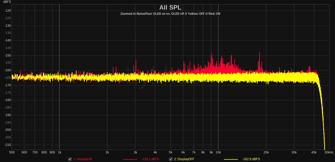

The fast transistion for all those functions get into everything. You may need a shield container for them or even a seperate box. Displays are notorious for noise. Tek used to provide metal screens for the scopes to deal with noise radiation. I suspect LCD OLED could be worse than a CRT. And you are way down in the noise with this stuff.

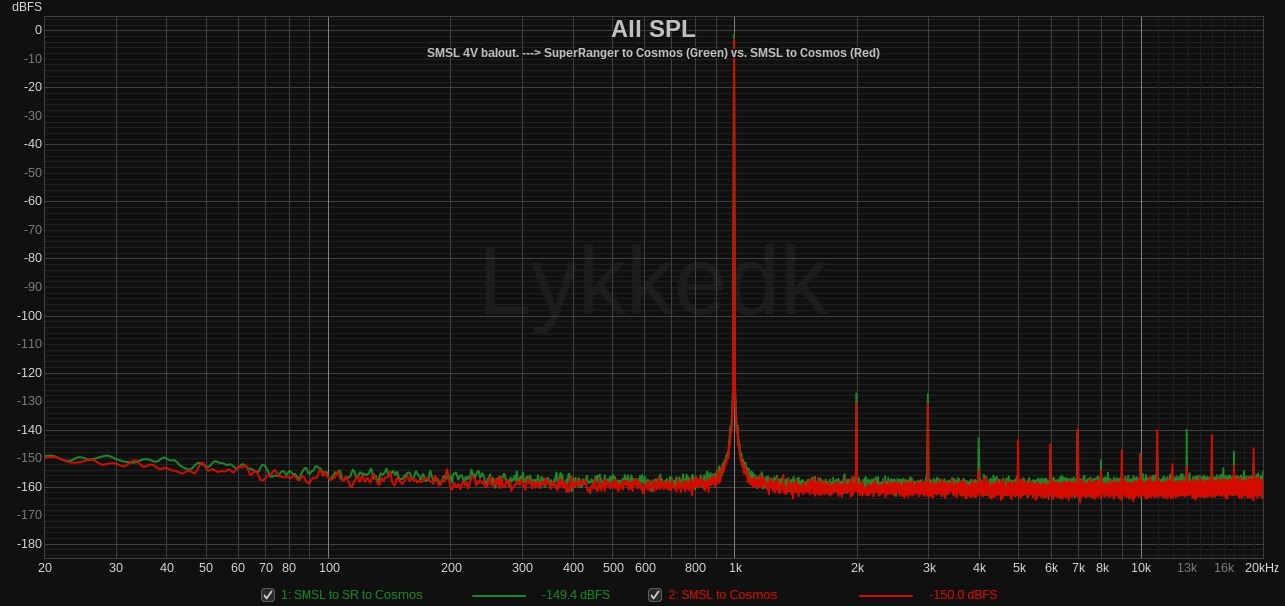

The screenshoot is taking without warming the SuperRanger and Cosmos for say 15min. as usual, but it's sure looking good.
Gain is unity when all relays are off like this screenshoot below ::

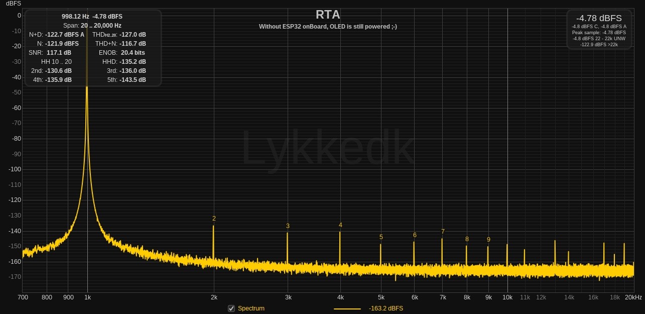

So it did actually trick me figuring out if I could remove the noise by setting the ESP32 into deepsleep mode.
It showed that the processor was not the main cause of this problem.

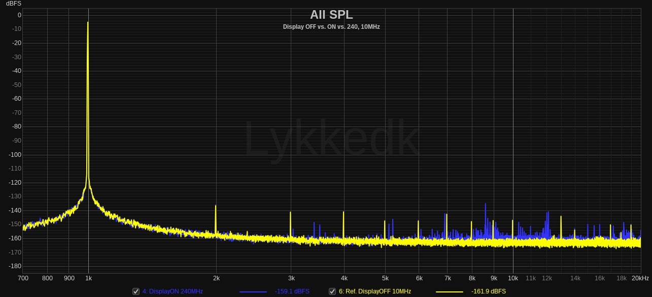

The difference between 240MHz and the 10MHz and completely off is not that big, but there is some noise/grass. The MHz is lowered into 10MHz as soon as the measurement is "stable" (fast enough for stepped sine)
The cause for the 9KHz bump was the OLED screen's charge pump, and as soon as I in software turned off the screen, the bumb was gone 😎
