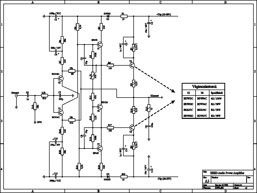

Hello
These was my first DIY amplifier , I built about 20 years a go .
Now I think to rebuild it . From beter quality parts .
Any comment welcome .
When firs I built it I used one pair power transistors but after I added one more pair which brought a lot of improvement in the sound .
More dynamic , more bass , I used +/-56V power supply with two pair 50 000uF Mepco capacitors .
I post the schematic you can take a look . No need for preamplifier , just a 10K pot. . On the input is better to use a bit higher value capacitor .
One more time any comment ,advise welcome
Greetings

looks like what I call emitter feedback (curr-fb )
but I have never seen this very type before
something new to me = more interesting
practically all transistors can be upgraded, improved
personally I should start with +-30 Volt
and try to make it work/sound perfectly with one output pair
another thing
these type often benefit much with separate power supply for output stage
and the input/driver part a well regulated own supply

Hi gaborbela,
Nice amp. Interesting.
It looks almost like a unity diamond buffer, but you are modulating a "current sources" for gain. Interesting.
From my work with similar circuits, the doubled outputs will give better damping and life to the music. It probably sounds slightly compressed at higher levels, but with good detail. Can you stabilize the bias with lower value emitter resistors? Say 0.22 R? Even 0.33R would be an improvement. Adding more outputs will improve the sound also, not for heat spreading but to lower the range of current each output gets.
Coupling the bias transistor thermally to the drivers should help to control the bias current a little better than if they were on the heat sink. All you can do is try this. You will want to keep the input pair as cool as you can. Getting the bias to stay right is a balancing act sometimes.
Running the voltage amp stages (from the fuses back) off regulated supplies might help with any interference from the outputs, but your diodes will at least decouple from sudden drops in the unregulated voltages. You were thinking of this I bet.

Yes the amplifier is very stable firs we used .33R emitter resistors but after we doubled the output the amplifier designer advised to us to increase a bit those resistors .
Of course the BD136 must be on the main heat sink .
It need a bit larger heat sink than the usual classic Class A/B amplifier , somehow the Darlington tend to run hot .

Hello Anatech
I just reread your post and now I understood your advise about the bias transistor .
I think is a good idea because how I wrote the power transistors tend to run a bit hot .
Before the bias transistor was on the main heat sink .
I will ask my friend when he design the PC board to design that way so we can use a small heat sink for the drivers and the bias transistors together .
Before it was on the main heat sink .

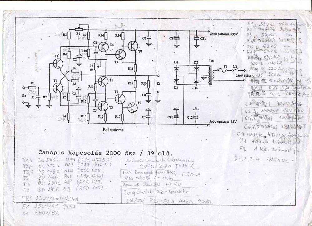

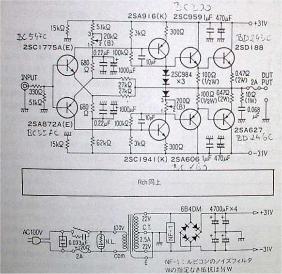

Hello
The first schematic the original with the Darlington transistors !
I had the same schematic with the fuses but I took those stupid fuses out with the 1uF capacitors .
I'm still mad about those fuses .
It degrade the sound badly and in case for some reason one side would blow up your speaker go with .
I know it happened with me .All the 56VDC ended up on my speaker coil . Is a very bad idea . To protect a max $3 value transistor which can take 10A with a 2A fuse and let your speaker blow up instead!!!! That is very stupid. So I took out both fuse after I payed the heavy learning price for .In another way more safe with out those fuse . 10A give you more protection than 2A.
And if we double the output transistors ....we just need the right size heat sink .My friend has the amp from that time ..
I meet with the designer about 20 years a go when he gave me these schematic . He just took a piece of paper and scratched on these schematic at the front of me from his head .I still have it but now hard to read . After almost 20 years ..
After he gave me the second schematic to , after I told him the amp took my speaker out (which you say orig) but he warn me the first one much better amp .So that was the reason double the power transistors .
I did tried the second version which you posted as original but to com pare with the Darlington heaven and earth .

Hello
I should correct myself .I built the firs schematic posted by Ferencz and the second amp it was the third schematic .
For me that amplifier Canopus sounded horrible .So after a few tests and modification I decided that is not even a HI-FI amplifier category .
To be clear I didn't tried the Japanese version .
Out of my experience I'm only interested the Darlington version amplifier !!
