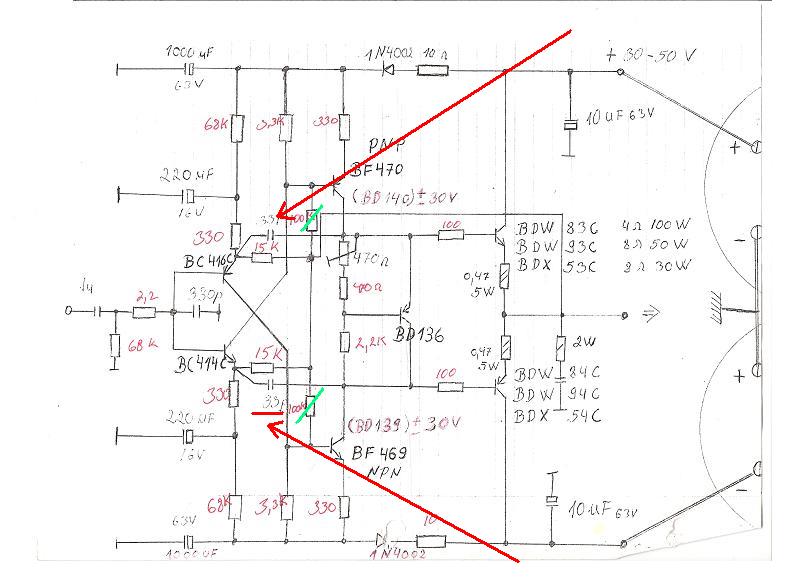

Lets go back to the mentioned problem why I got a thermal runaway.
The two 100K resistors was removed ( marked with green) (they does not much in the circuit), that is how the original was drawn.
With that the Miller capacitor (marked with red) become total noneffective.
I forget to correct that in my previous layout and that led to almost burn my Visaton speakers to.
IT is corrected now, should work properly.

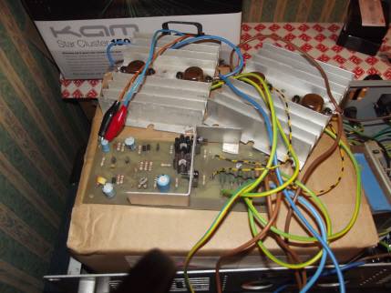

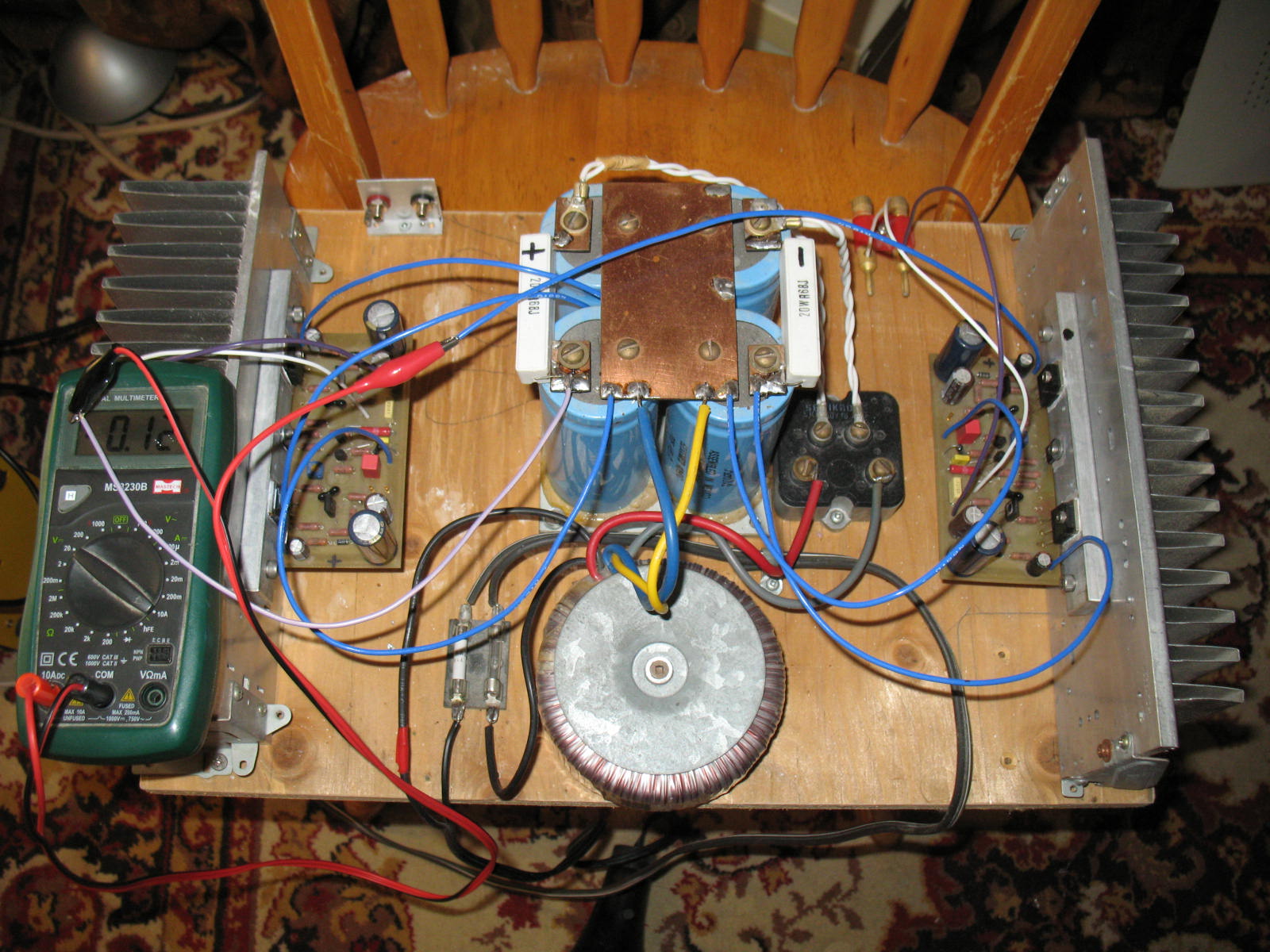

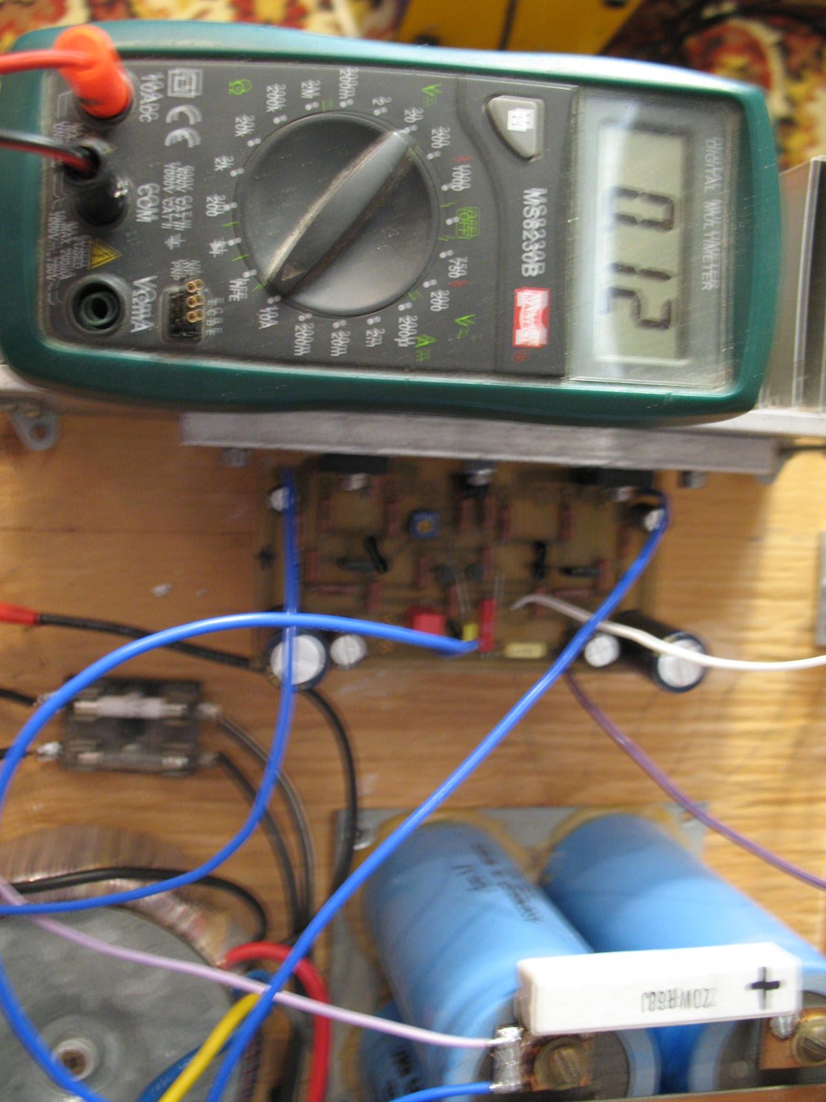

Here we go again.
Last week I put together two channels of this amplifier. I used some of my old PCB but corrected the previously overlooked errors.
I powered up one channel and set up the bias to 120mA (it is high but for testing) too see if is stable. (around 40V rail voltage)
The amp is on about 3 days continuously and rock solid, no movement or bias wandering like before.
I did not listen yet, I will have to ad some volume control and some RCA connectors.
The side now is on it uses a pair BDW83/84D type from ISC.
It used to blow up after I powered up with those transistors. (The amp was oscillating that much)
I always thought because fakes all do it was ordered from Reichelt Germany. (I do not own a scoope).
Again one more time the amp is stable with those power transistors which used to blow up at power up or less than 30 minutes after power up.
The other PCB uses Sanken power Darlingtons, soon I power up that side to. (Gareth ask me long time ago to test those transistors).
Some picture, I use large can caps even for testing, it is my set up to test different amps.

Hi gaborbela,
Very good! I'm so happy for you.
You really do need an oscilloscope! An analogue, dual trace, 100 MHz is not expensive these days. A digital scope has toys but they are not as good. Please try and get one, it will make your life much easier and more enjoyable.
When you change output types you can get stability problems (that's why you need a scope). Same for some other circuit changes that may change the bandwidth of some stages. Between that and your layout issues you mentioned, you got it working. We still don't know how stable it is though. You do need to watch the bias current as it runs. Sometimes amplifiers can look fine for a bit, then "take off" once things warm up and the bandwidth and beta shift in some devices. Also watch heat sink temperatures.
So ... what are your plans going further? Probably want to drop the bias current a bit. A distortion analyzer and oscilloscope are so valuable here. If you are very careful, you can use your sound card and something like ARTA to look at distortion. But remember, sound cards often have a 5 volt limit on the input before damage. You need to figure out what your peak voltage is (not the rms value). You would probably want to use a resistive divider on the input. There are some "front end" circuits and projects on here for that purpose. I would maybe start with a -20 dB pad for starters (that's a 10:1 divider). You do want to load it resistively for testing. You can get 8R, 20 or 50 watt loads from China pretty cheaply. Mount those on a heat sink.
Good going, and good luck!

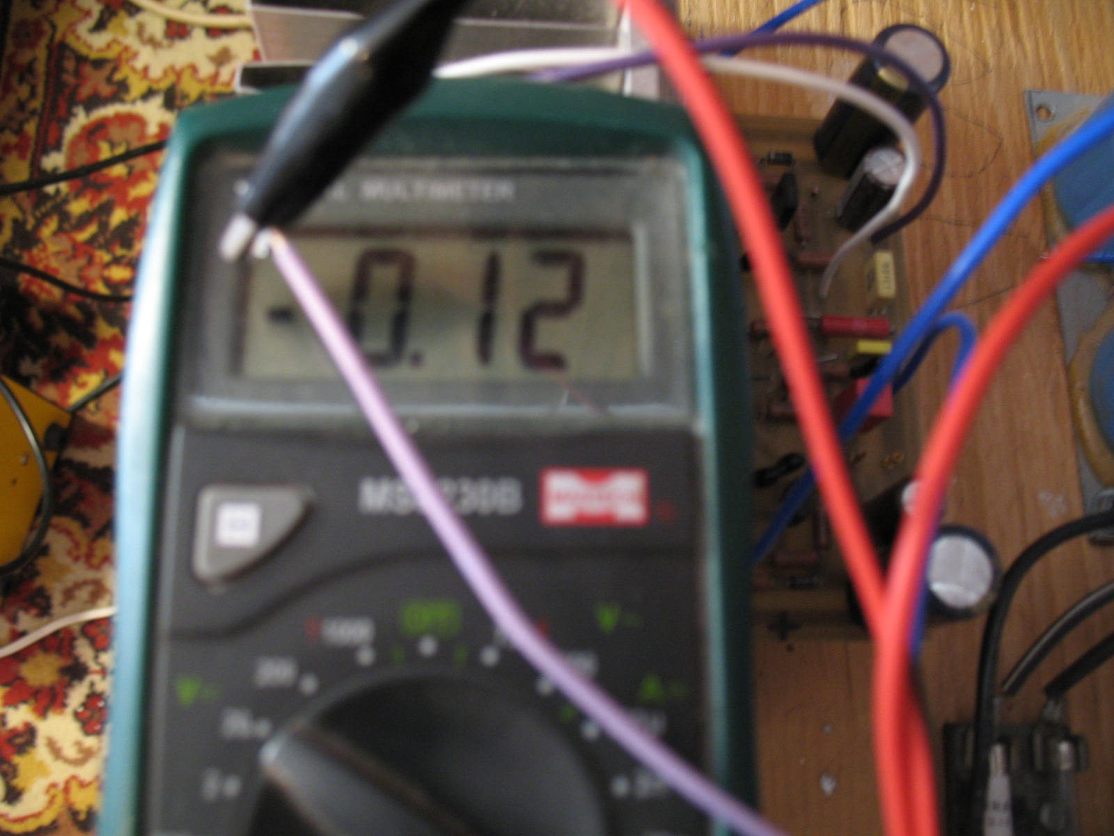

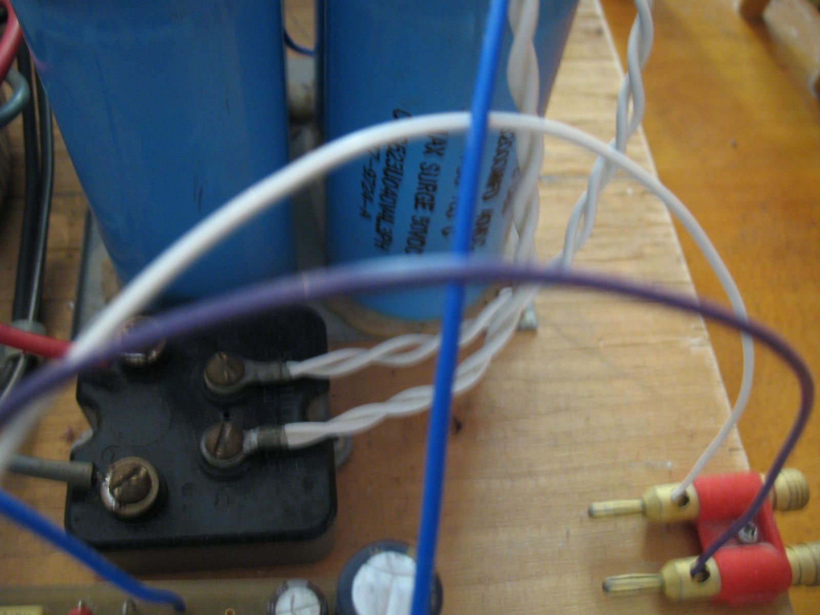

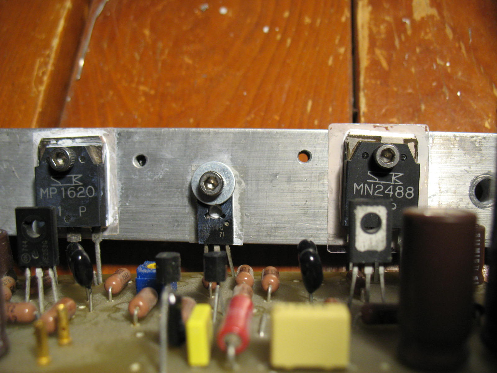

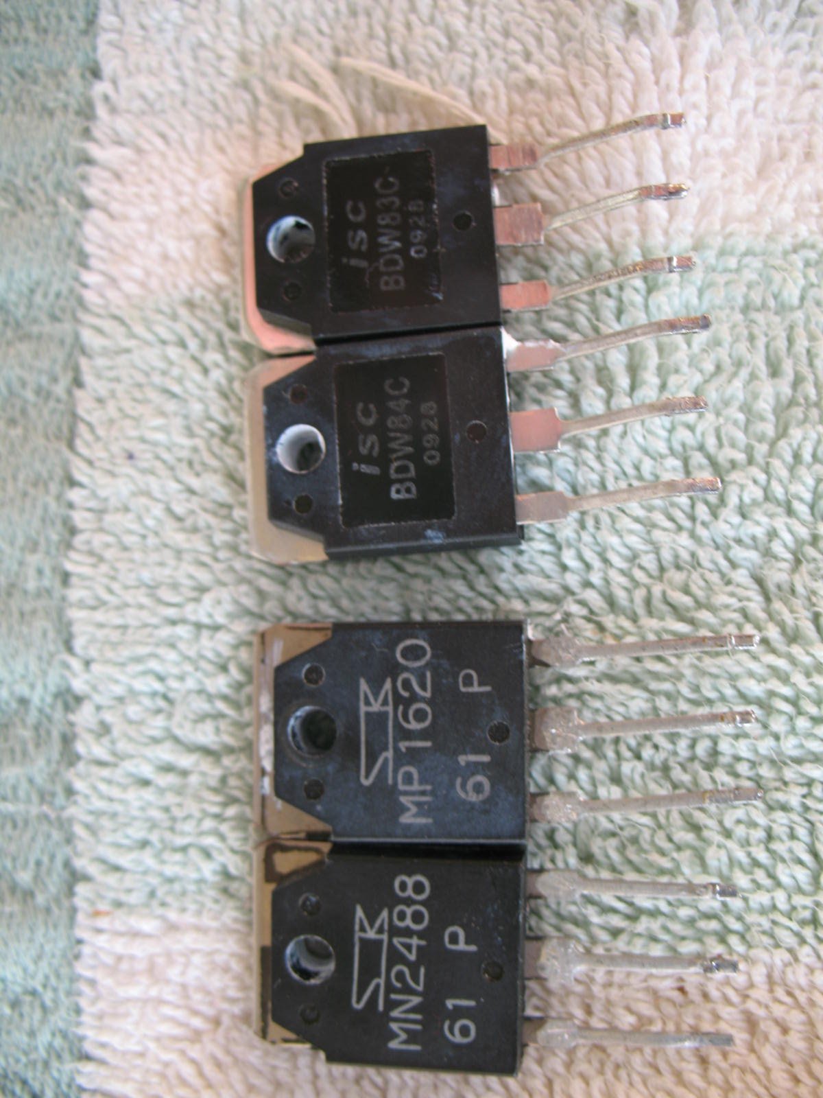

Finally.......
I managed to power up the other side, it was not easy.
First I already soldered a pair Sanken darlington (I made a promise to Gareth) I will test those in this amp.
It did not work out. After power up with a 40W light-bulb I got 400mA bias which I could not adjust and the light bulb was on full power.
If not the bulb I would experience the magic smoke escape from the parts.
Interestingly I did not got any offset (DC) voltage on the speakers terminal even with that high bias. There is a reason I mention this.
So I removed the Sankens and the (BD136) TRANSISTORS.
I chose a pair BDW83C/84C in place of the Sankens and a new BD140.
I checked all the solder joints and everything was fine.
I powered up and I ended up -19.5VDC on the speakers terminal. About half the rail voltage (?), I could not find any error. Now I can adjust the Bias but that high voltage on the speakers terminal not OK.
I dismantlement again, I took out all the transistors, including the VAS transistors.
I replaced again the BD140 with Philips. I replaced the BDW-s with TIP-s.
Now It is working, I powered up, I set up the bias to 120mA and will leave it to see the stability or the bias drift if any.
I think tomorrow I will ad a par RCA connectors, a volume control and I will test it the sound.
It should be as good as last time.
When I measure the Sanken or the BDW darlingtons with a DMM it looks like they are OK.
The Sankens were savaged from a Sony home theater receiver which was working OK.
I do not understand, neither the BDW's why acted so weird. I will test it once again later.
Just wanted to be sure I can power up this amp also.
The other side after 3-4 days was rock table I turned down the bias to 50mA. I will do the same with this side also.

Hi gaborbela,
Transistors can be faulty and test fine for low voltage gain or diode junctions.
Coming from a hobbyist background, I tended to try and use used parts for my own experiments. I learned the hard way that, although many times it was okay, many times it took days of troubleshooting to come back to a bad part I saved and used. You only use good parts right?
Today, I only use new parts in my experiments. I do not have the time to waste.
Reactions: gaborbela

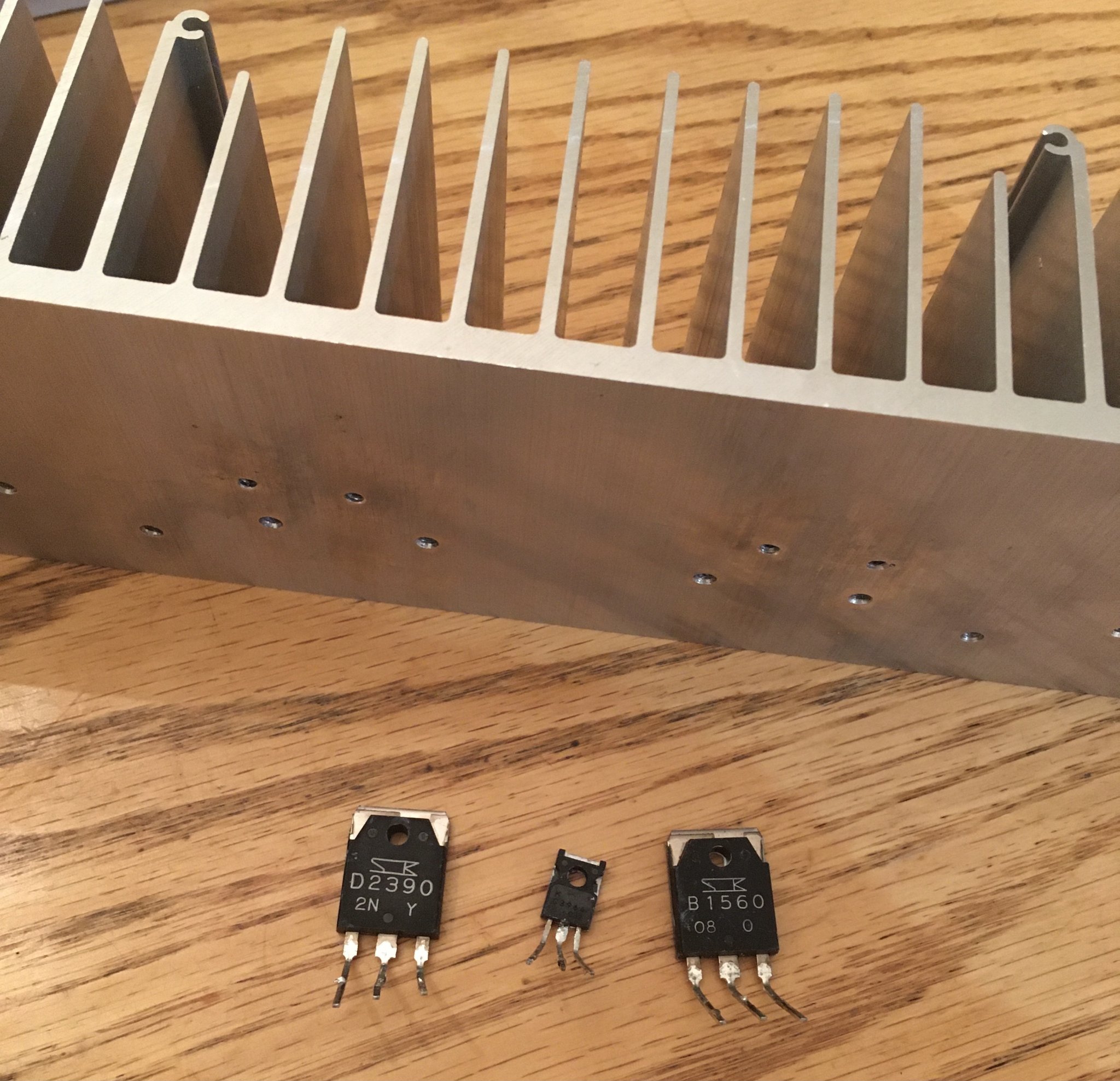

I found a thread, where it is claimed that those particular Sanken parts are very hard to bias. This is what I found:
“Yes, they're sonically very good, especially for darlingtons. They're very fast and have reasonable SOA. Darlingtons in a Class-AB/B Emitter Follower have a relatively small Vbe-biasing sweet spot, and Sony apparently uses a carefully-controlled Sziklai Vbe multiplier with a hi-beta (>1000) master to achieve this.” https://www.diyaudio.com/community/threads/sony-5-1-output-transistors-repair.36422/
So maybe not any fault of your circuit, just not suitable.
I just went to my basement and found these objects, I feel very attracted to this amplifier. I am so busy these days but if I can find some time I would like to see if my Sanken devices could possibly work….🙂
I will test it one more time later. Mr. N Pass has that Class A-B AMPLIFIER schematics with TIP 142/147 Darlingtons. Some DIY-ers built it with the mentioned Sankens and they work properly. That has a similar VBE as this amp if I remember well. I also want to test it for myself I have at least 10 pair or so at hand and I still have a cheap Sony receiver one channel dead with the same Sankens.
