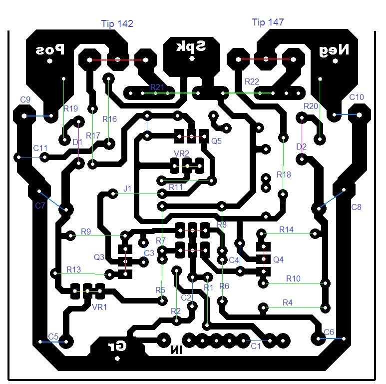

For coupling caps I do not like large value caps, that would be my correct statement.
If the PS built on a PC board like many commercial amp we have to use what ever need for there.
If you look at my layout you can see if I rotate the capacitors (next to the power transistors) I can use even 2200uFt to.
There is room enough there.😀
I will see if really necessary to go over 470uF what I think is a decent capacitor for that position.
By the way these is the final layout what I will use at my tests.
The size of the PC board 86 X 82mm
86 wide frame to frame and 82 long.
Greetings

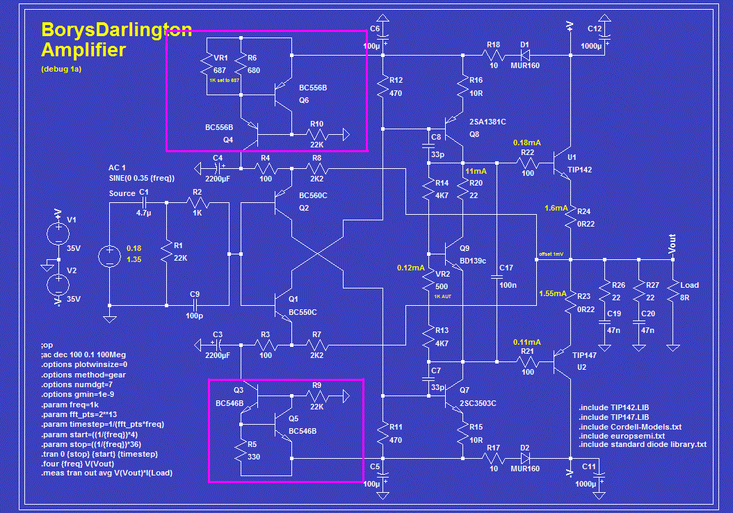

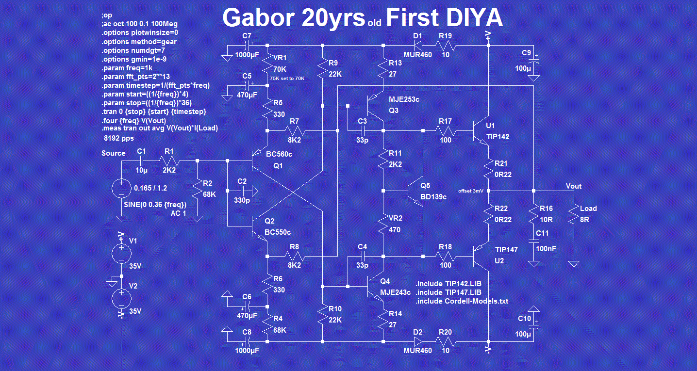

Bigun or anyone else who interested please take a look at the latest circuit
Thanks 🙂

Still, I suggest somebody should run quick Spice sim with "TEMP 30 40" to see how stable is bias of output power devices with temperature. More sophisticated simulation needs control over individual devices of course but it's simple enough to do global test whilst you begin some real soldering!
I like this topology and I have reserved many pairs of Sanken Darlington devices for when time is available !
Perhaps good to add a capacitor across Vbe to ensure good a.c. Behaviour.
Hi
Bigun I agree with the capacitor across to the VBE🙂
Very likely next to the VR2 we will need a resistor, one side it has 2K2 the other side only a 470VR.
At least for test I made the room for the mentioned components
The resistor marked as a J jumper the capacitor not marked but is there in the layout
Greetings

How to provide thermal stability for Gabor's amp is the question. I think the issue as always is the VAS, the current through it increases with temperature and this simple Vbe causes increase in OPS current. The VAS emitter degenerate helps but may not be enough and increasing it will reduce OLG. Other option is to make the Vbe multiplier immune to VAS current using solution like my TGM5. Or add some temperature variable element to the input stage like VSSA. What other ideas - there are more options?

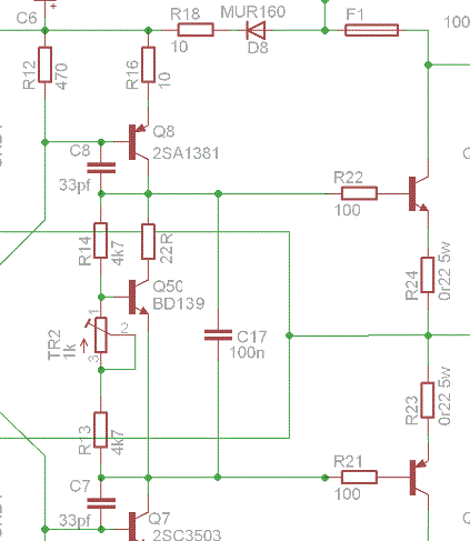

R20 is the Hawksford/Hagerman/Self added resistor to compensate the Vbe multiplier for variations in multiplier current.
As such the tappings to feed the next stage are connected to the emitter and collector of Q9.
The sch shows the upper tapping connected to the wrong side of R20.
C17 & R22 should connect to the bottom end of R20.

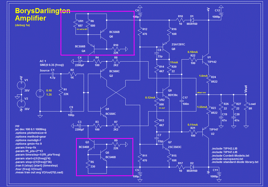

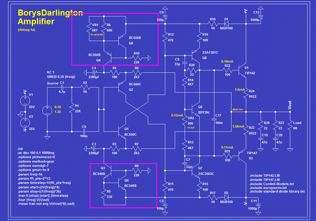

Thank you Andrew
Three variation is possible but very likely only one is correct because You did not mentioned Q8 & Q9 Collector how to connect together...........
I had something similar earlier (a few page back) with a extra diode together, at the simulation it did not work at all
These circuit was made by Borys and in real life it performed very well, that not mean everything was connected correct!😀
Here is the modified circuit
Please let me know which one you think out of the three version is more acceptable
Thank you very much🙂

It looks like it can be some controversy about that..
It would be nice to clear that out. I can not ask you please simulate all 3 so see which would be the right connection.
I know Bigun also advised something like the first out of the three I posted with an extra diode but that simulated bad.
Maybe because the diode 🙄
I don't know
Lets wait if someone has more idea
Greetings
I'm in Paris (the real one, not Ontario) at the moment with no access to simulations. If I remember correctly the Haggerman simulated just fine for me with the right choice of resistor values. He has a websit that shows a few Vbe variations.
edit: http://www.hagtech.com/pdf/vbe.pdf
The key with the CCS front end is to thermally couple ONE of the transistors of each CCS to the power output devices; you will see how I did this very neatly with my TGM7 amplifier PCB. It would be helpful to simulate first, alas I can't at the present time.
You may not need both design elements and I suspect the thermally coupled CCS is the better option.
