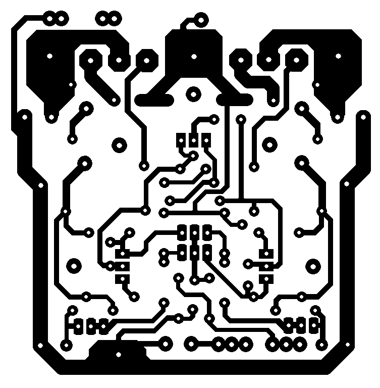

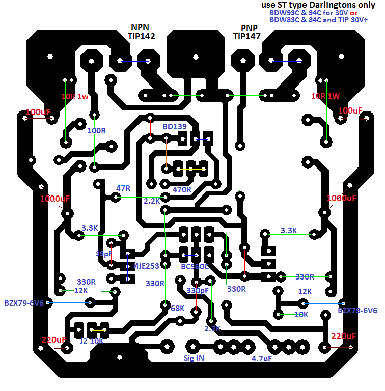

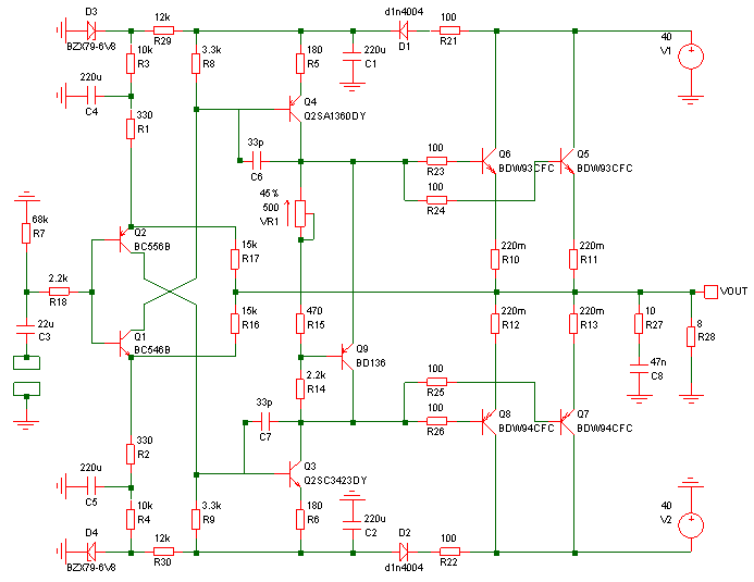

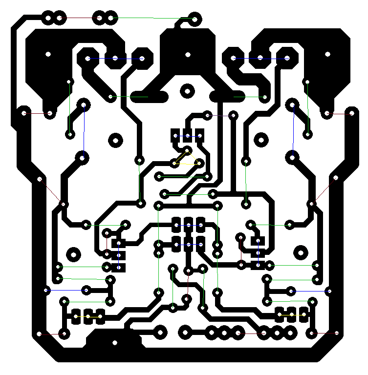

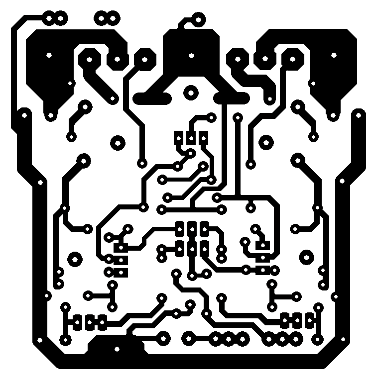

I just made a evaluation layout, for a single pair power darlington pc boards.
I want to test deferent darlingtos and also I try to improve the over all stability of the amp.
Sorry guys I was sick for a while and did not had time to be here or do anything DIY progress.
Also I have the high power mosfet amplifier which came together nice by the help of Mr. Wahab. I have to test that to.
I ashamed and feel embarrassed because of that.😡
Such a great project, and laying on the shelf.

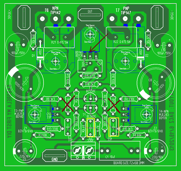

For the layout I used Dacz layout with some mode and I corrected one important mistake.
The connector of the BD136 not connected to nowhere which is a mistake.
Also I use the 33pF on the Vas as a compensation, I have the feeling with certain type of parts (semis) the amp oscillate.
I ordered ISC produced darlingtons BDW83D-B4D from Germany Farrnel (can not be fake from such a distributor) and it blew up one after other at very low level.
That has twice the power then the ST BDW93C-94C.
I removed the 2 100K resistors.
Some small changes like one layout has the zeners at the front and I added two trimmer so I can adjust the offset.
Greetings Gabor

looks very nice!
do you need pot for dc offset ?
and I guess easy to add pcb mounting holes.
I am v interested to hear you impressions of different Darlington devices.

Yes I will use holes to mount the transistors.
I can get read of the trimmers or only use one, the problem the huge beta difference between the MJE243/253 somehow I have to compensate otherwise I end up with offset..
I want to use these complementary for VAS I do like them a lot.
Other option I have to select the signal transistors to get read of the offset or increase/decrease the voltage on the signal transistor selecting the right value resistor..😕
I know only one trimmer would do the job.
What is your advise, some simple solution?
After set up I can replace the trimmer with the right value resistor and use jumper on the trimmer place.
These for board evaluation.
Greetings

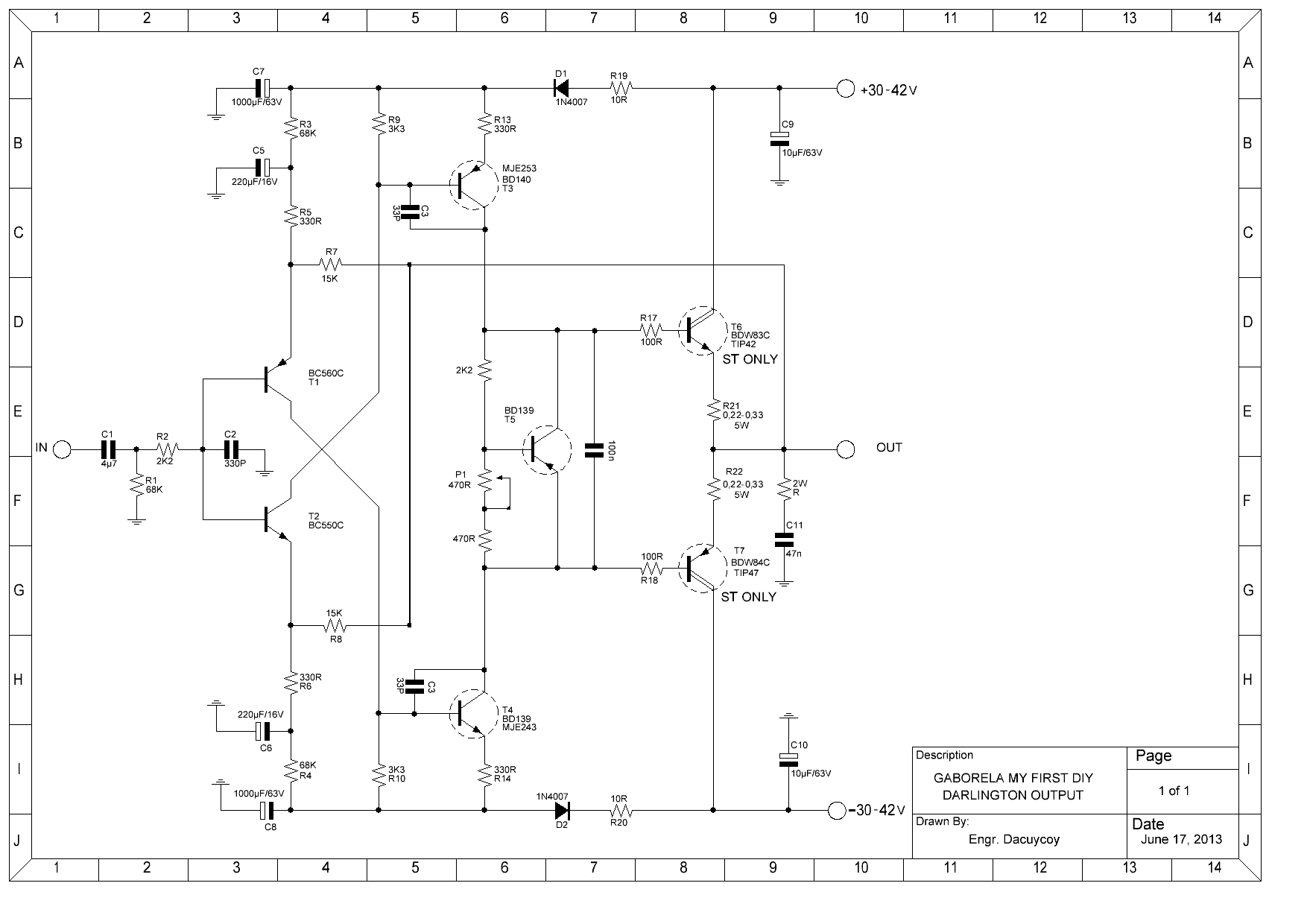

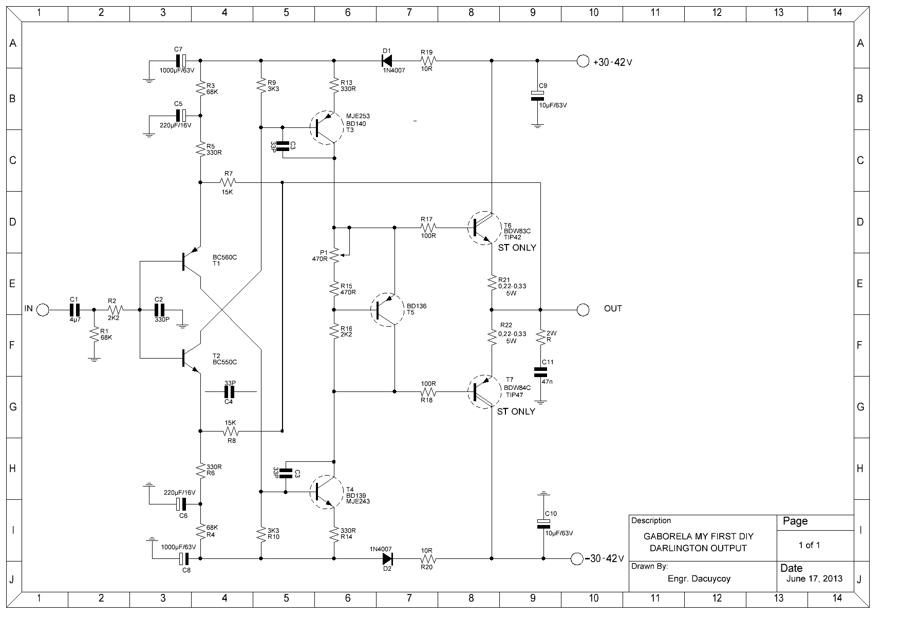

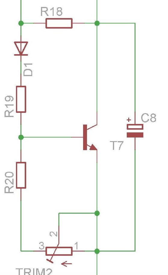

I made some basic mode
Someone advised (I think Asok) to change the VBE from PNP to NPN, I don't think that would give more stability but let try it, so BD139 instead BD136.
Also I added a 100N capacitor across on the VBE.
The basic problem here I do not own a scope so I have to be very careful to do bigger mods.
I do not want to invest into scope, can not do DIY all my life,😀
Here is the two schematics one with the NPN type of VBE.
If you guys think these better I will mode the layout to.
Greetings Gabor

This type of Vbe is no better or worse in terms of sound but it is more stable with changes in Vas current. Do look at the TGM5 thread for the link to Hagerman website as it gives more information, perhaps an even better version. I remember that you can optimize the performance of the version I used by adjusting the resistor (R18 in my TGM5 that you showed) so that it keeps stable bias in your particular circuit, which may require some trial and error. The emitter degeneration of the Vas devices also helps to reduce Vas current variation with temperature, with higher values are more stable but distortion is higher because it reduces open loop gain. I think it is good to start with the values you have chosen and try maybe 1k only if you need to. Use a good size heatsink for the output power device adds further safety and put Vbe device onto the Darlington power device instead of the heatsink also gives better thermal feedback without lag from thermal capacity of the heatsink.
I can think of no significant benefit from changing Vbe between pnp or npn but for some implementation it is beter to use high beta device because base current is smaller. I am not sure if it is a significant factor if using the superior Hagerman design. Do use the Hagerman (he has good information on his website).
Perhaps for offset adjustment R3 could be a trimmer ?
Make C9 and C10 as large as possible, they carry speaker return current so are v important. C7 and C8 can be smaller and rail resistors can be a bit larger ?

Hugh doesn't use push pull Vas so his comments do not apply to your design, which has inherently less stable current through the Vas.
If you can not put the Vbe onto the power device then you have to keep it on the heatsink unless you sandwich the Vbe between the pcb and power device like I did on the TGm7 and the TGM8 but why not keep it on the heatsink for now.
A Vbe multiplier is a voltage regulator. A Shunt Regulator.
It does not need exemplary AC performance because the AC passes through the capacitor that is fitted across the bases of the next stage.
All it has to do is hold a constant DC voltage.

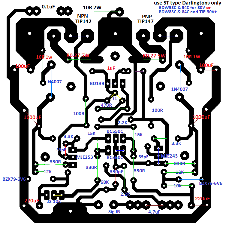

Here is the silkscreen with the pars on it. I did include Wahab mode on the front!
Bigun I left out one of the trimmer and the other side the extra resistor, I hope like these I can adjust the offset..
I will mode the VBE - will test something similar to yours
The funny thing with LatFet the amp rock stable, adding extra 4 diode with Toshiba 2SK1530 & 2SJ201 also fine.
These will be a test board , want to test some Sanken and other darlingtons to.🙂
I ordered some clad board from epay, I hope arrive soon so I can start it
Greetings
Bigun

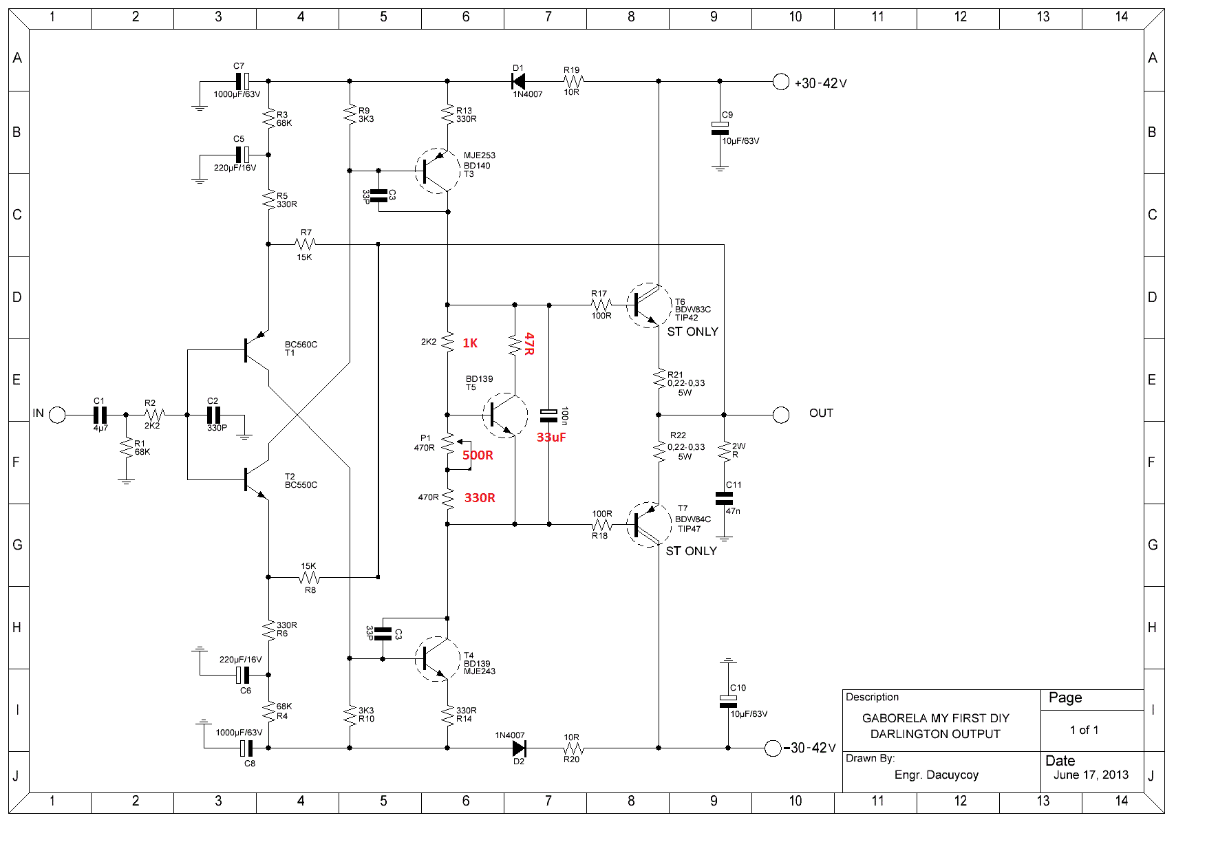

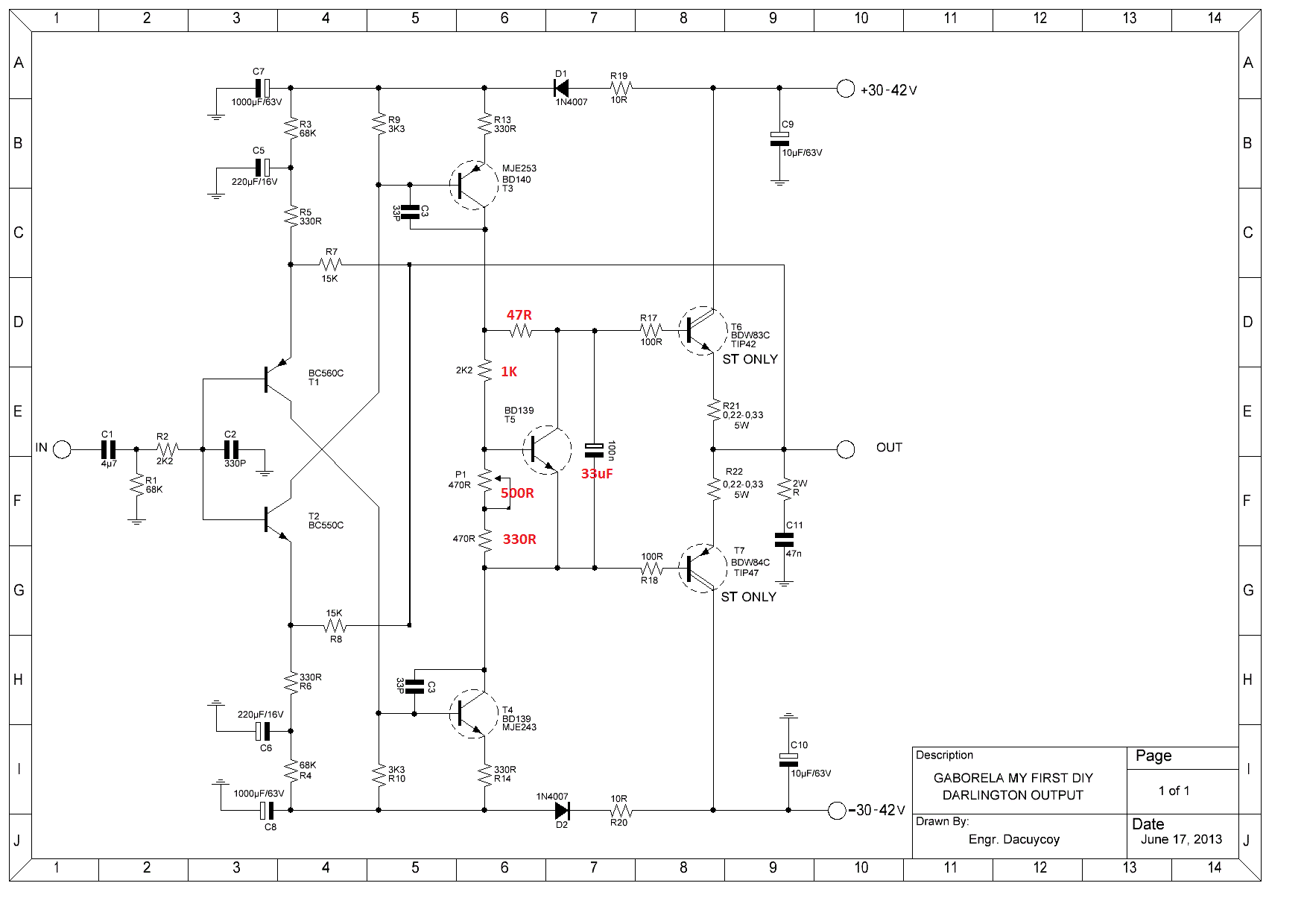

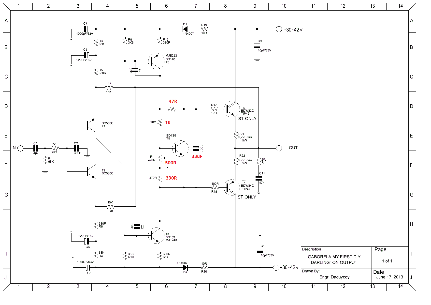

Here is the VBE U advised , from your TMG5
Those red are the new values plus the 47R extra resistor!
What do you think, can I test it how is it😀
If is OK just need the values to be adjusted I will mode the layout....
I will look for darlington transistor in the same package like the BD139, so I use faster device..
Greetings
Greetings
Hello
Bigun or anybody expert would you please take a look at the schematics and let me know which VBE solution is better
There is a small difference how the 47R connected
At the schematic already posted the 47R is in series with the 100R to the base of the darlington.
I see you connected the same way at your TMG5😕
I just realised that I moved it so only effect the VBE transistor collector.
Would you be so kind and take a look so I can mode the lay out.
Of course the 1K resistor value must be adjusted in real life, before it was 2.2K, if I remember well you wrote at least start with 1K.
Thank you🙂
Greetings
Thank you🙂
Greetings
First drawing is correct.
Second ( right) will do nothing !🙂
You can check it in Bob Cordell's book. Page 291 Fig 14.9 (c)
Also in Self's Power Amp book Chapter 22 page 530 ( 6th Edition ).
the 47r is used by D.Self.
He and Feucht describe how it works.
You will have to adjust the 47r to suit the VAS current you plan to use.
expect a much lower value 12r to 22r usually covers the range of VAS currents found in most amplifiers.
You could assemble the Vbe on a plugboard and apply a fixed current from an adjustable CCS. plot the Vbe voltage against current. See plot in D.Self's book and website.
Hello
Thank you Andrew. I think for start I will pick a 22R resistor. Also the 33uF capacitor may be to high.
Almost I needed need to redesigned all the layout because I replaced the Vbe PNP to NPN type.😱
Same time I removed the power transistors from under the PC board so I can month the VBE on the top of the darlington (not direct to the heatsink)
I just finished
I purchased some clad board from ebay (so expensive at the local store) when it arrives I will do one board and test it.
If it works out the stability fine finally I can build it.
I do love these little amp a lot.
Greetings Gabor
I just finished
Greetings Gabor
