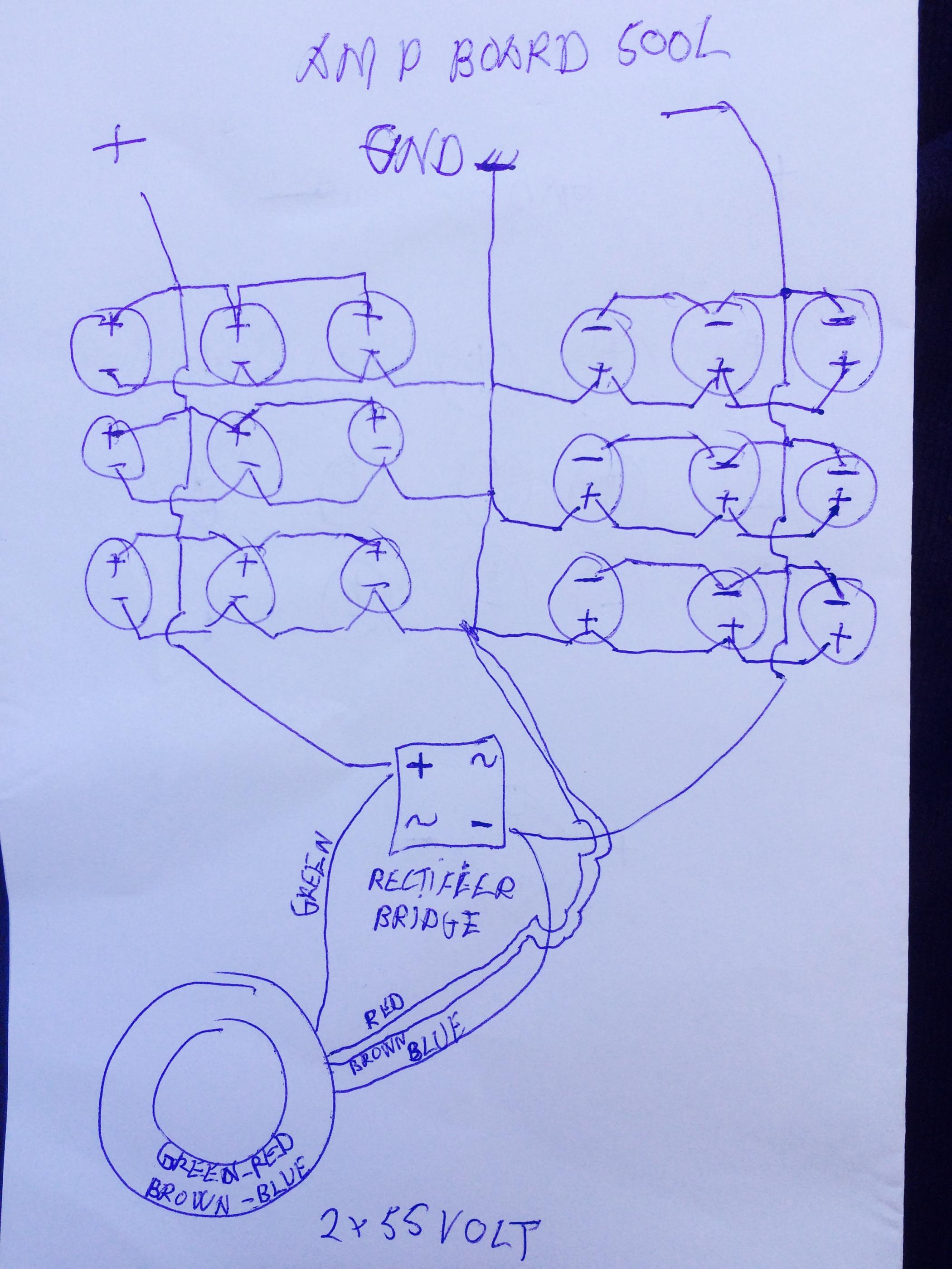

Bridge 50L boards. 2 boards for one channel using xlr innput.

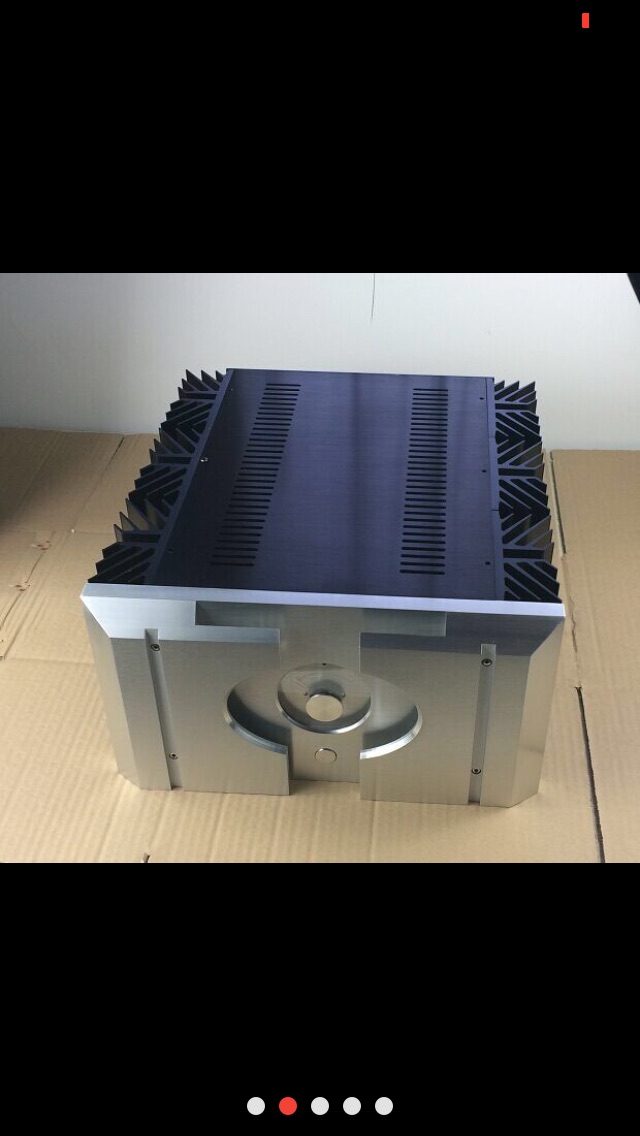

2 monoblocks with some pass look chassis.

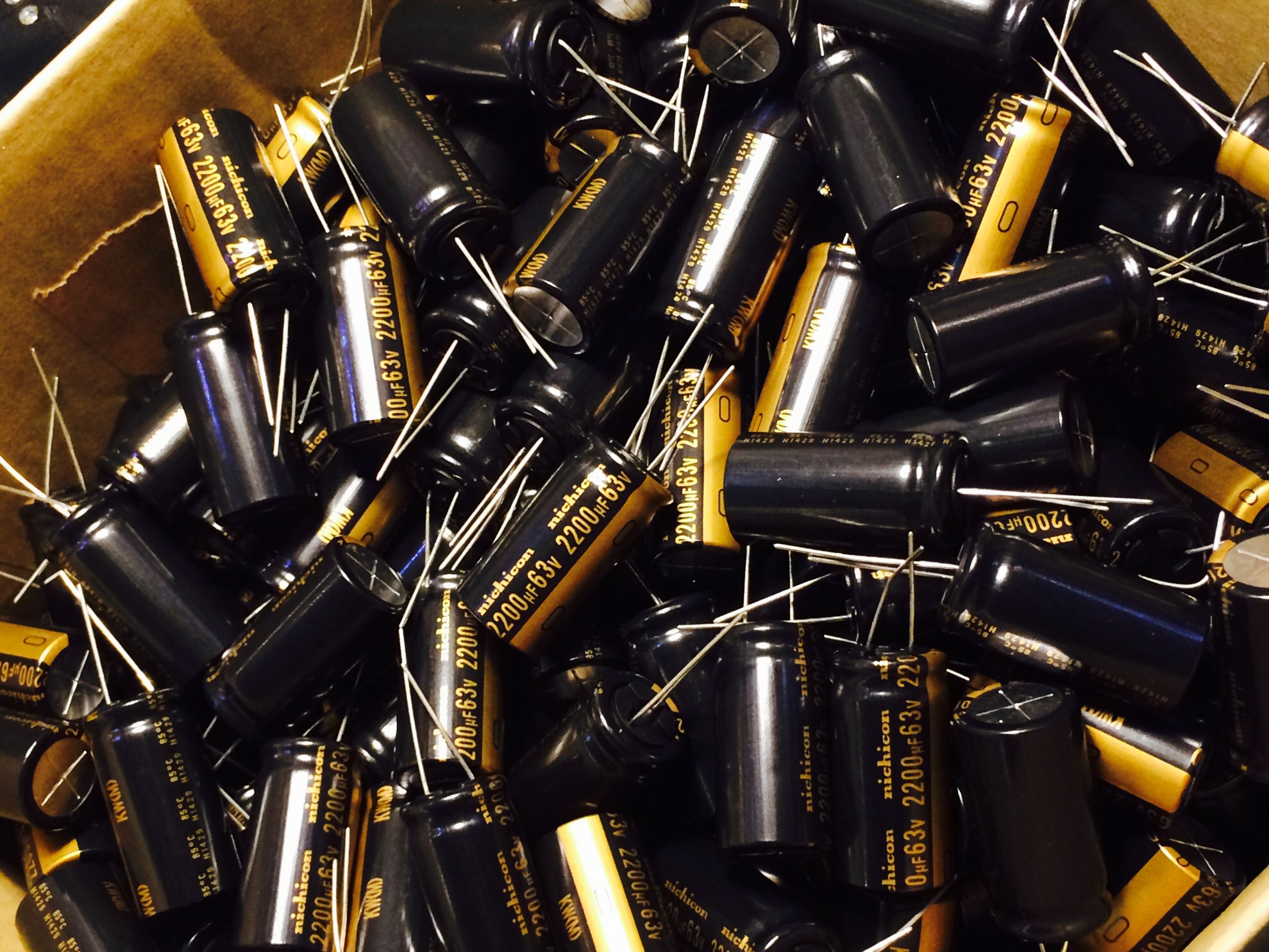

Alot of Nichicon KW 2200uF 63 volt caps is ordered.
One special ordered toroid 630VA 2x25volt, built on 800VA core, can deliver totaly of 18 A.
For the innput 120VA 24volt.
Around 60 capacitor for each channel. Making 66000uF.

I love the new case you got Oyvind
Where on earth did you find a Pass Clone chassis?
Cheers Anthony

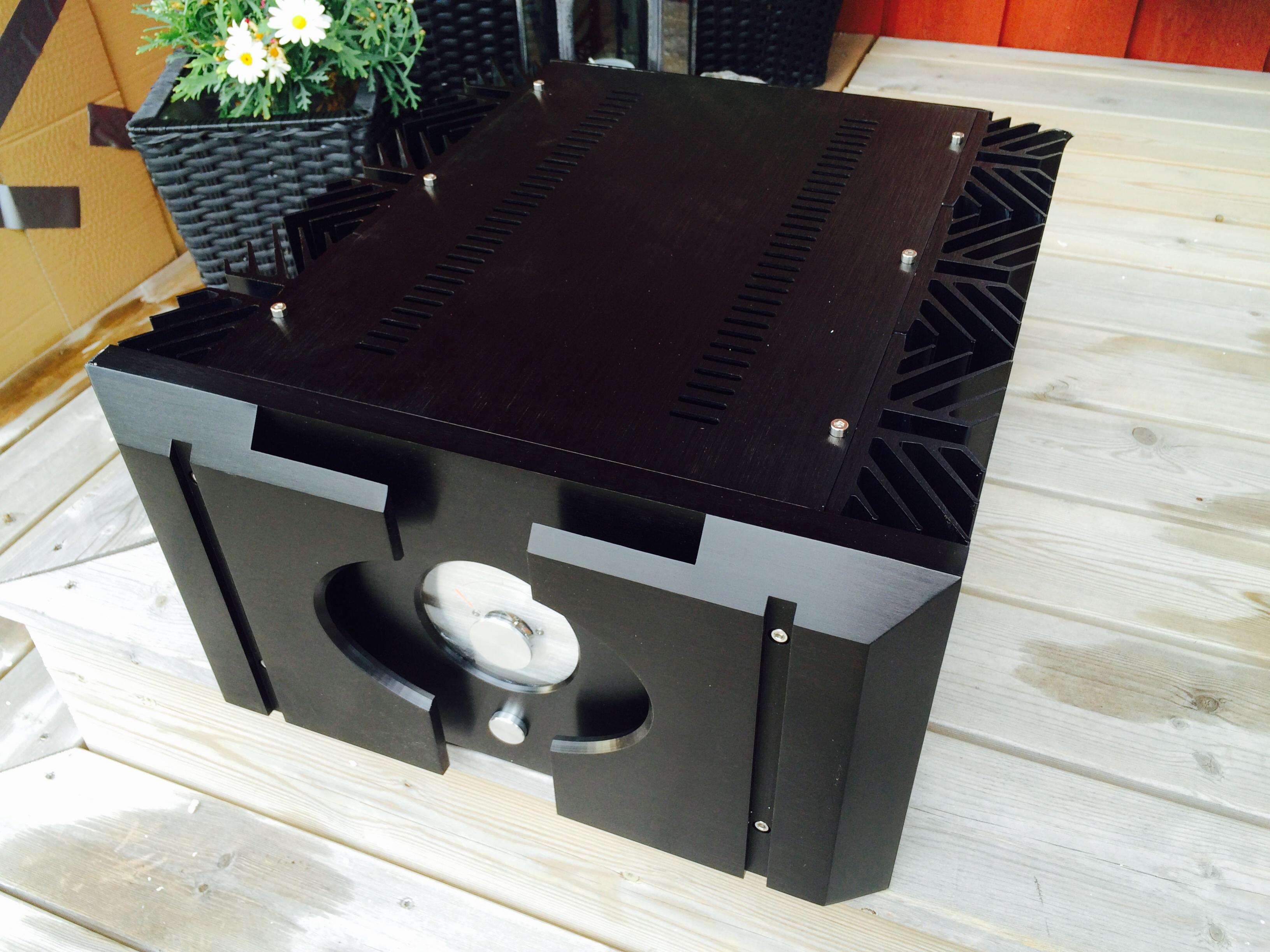

Realy looking forward to get it. This is the smal version, they have a larger one to.
Its from china where they clone everything
Ali express, seller Breeze audio. I baught mine with black face plate.
First chassis arrived, like it alot![]()
Oh my god must have been exspensive.
This is the smal version, there is a big one to.
This one cost me around 450 euro wit taxes, when i baugt 2 pc
