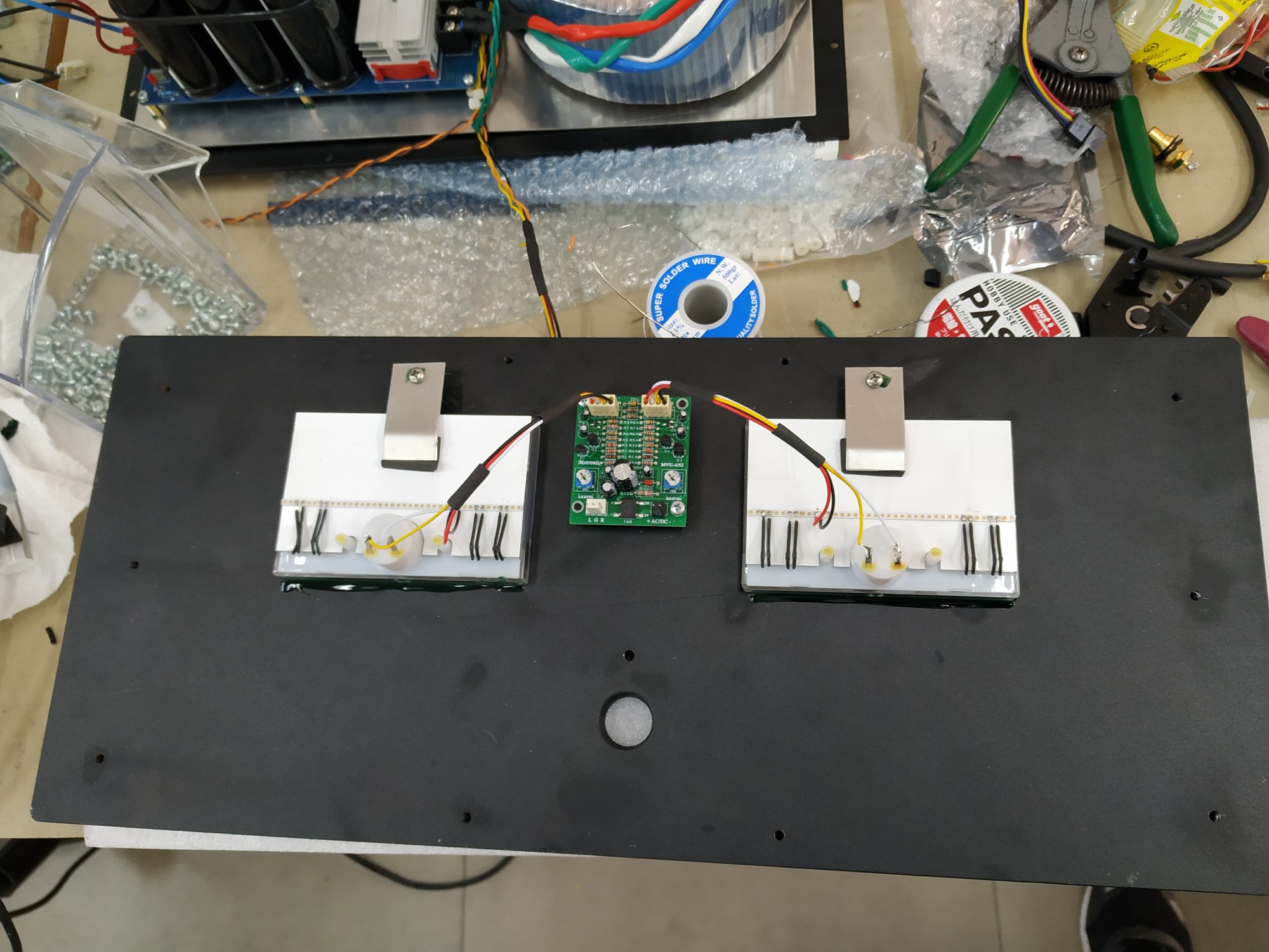

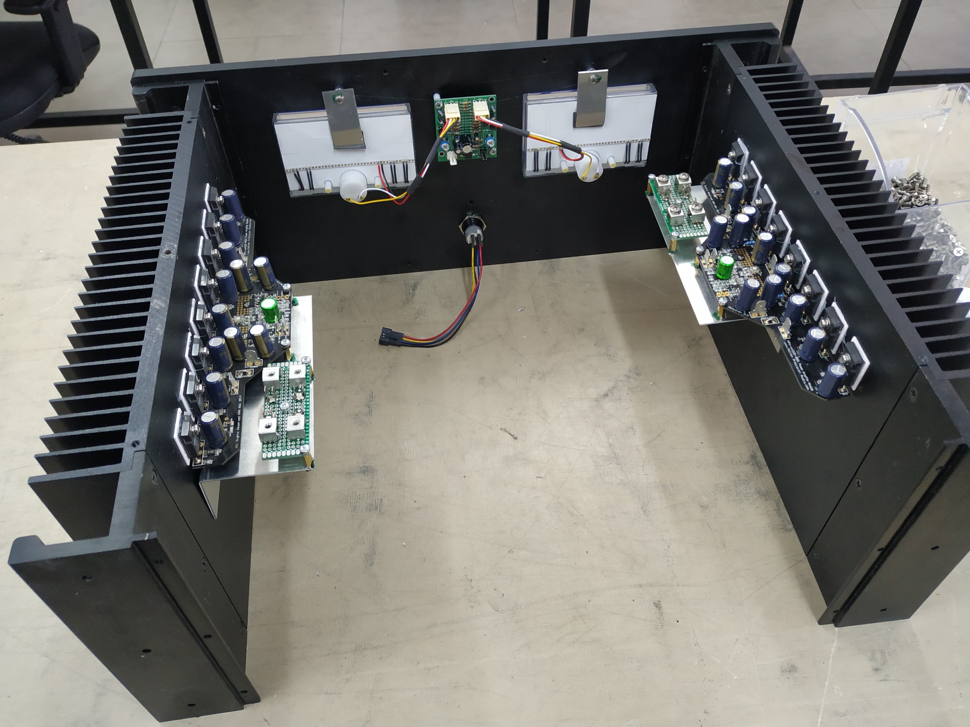

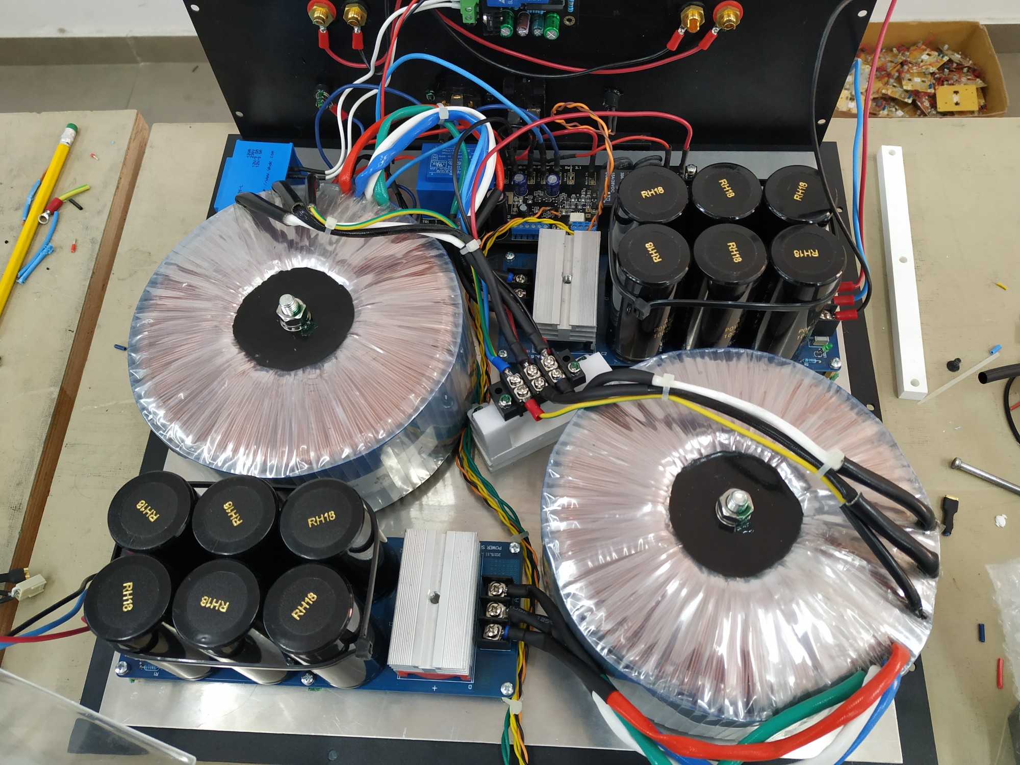

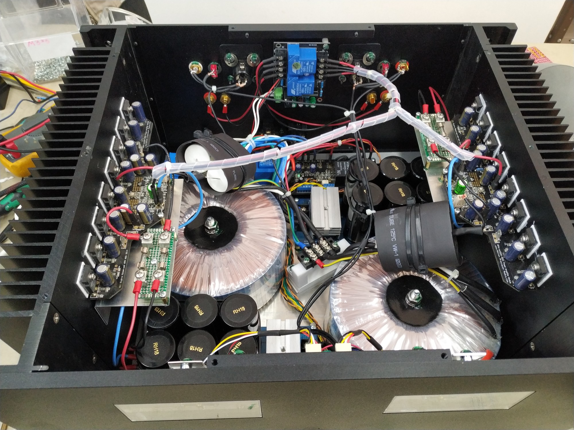

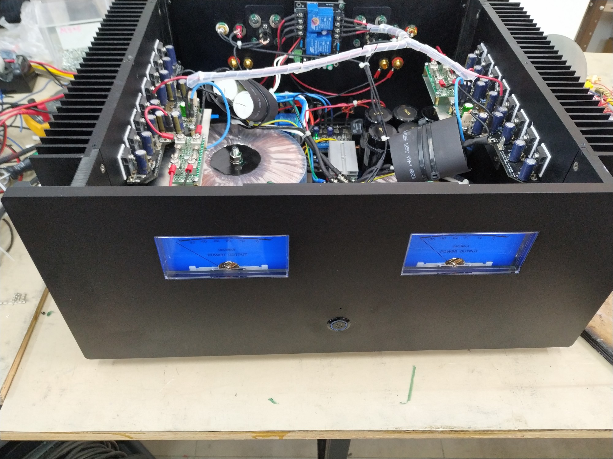

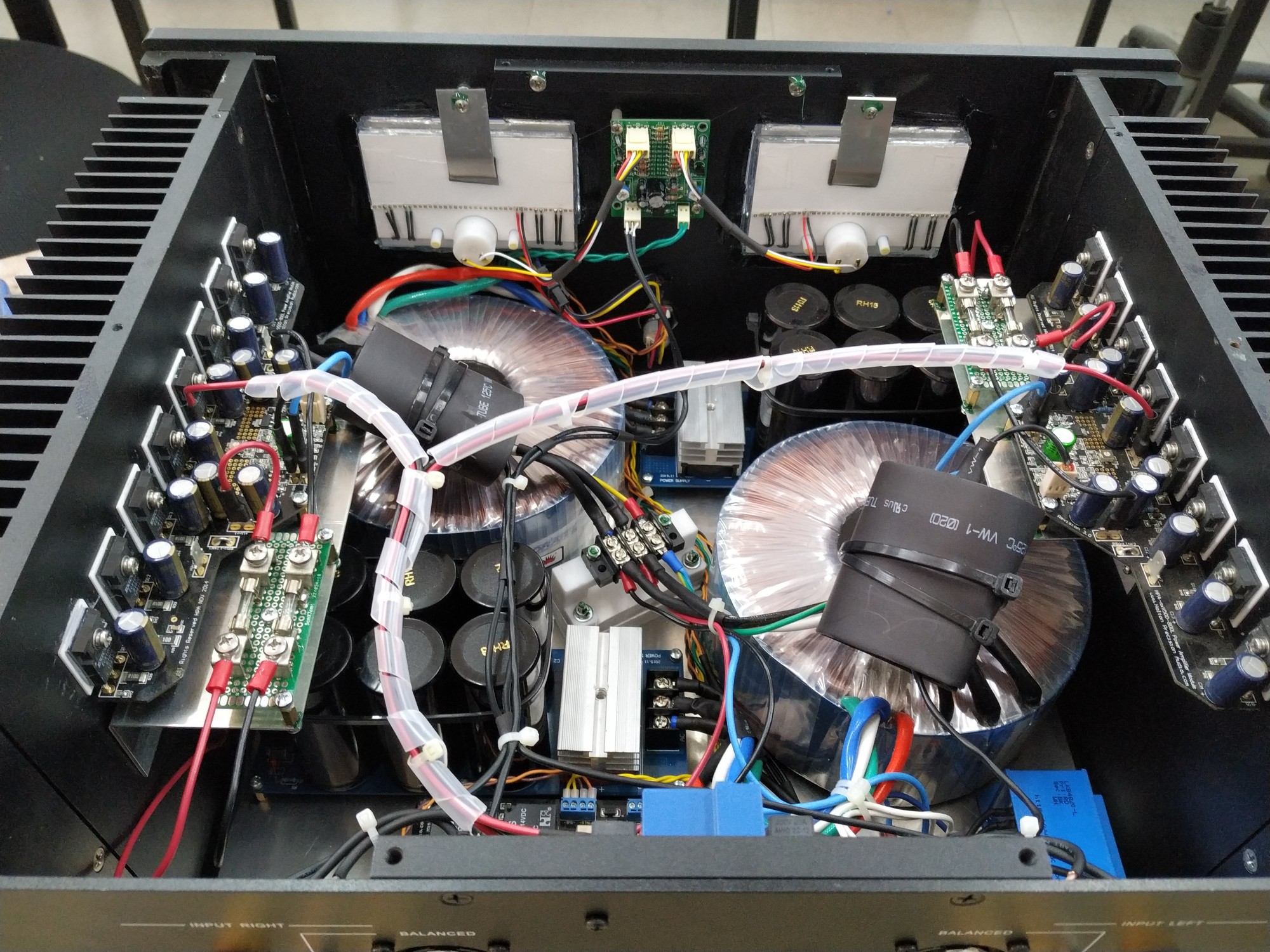

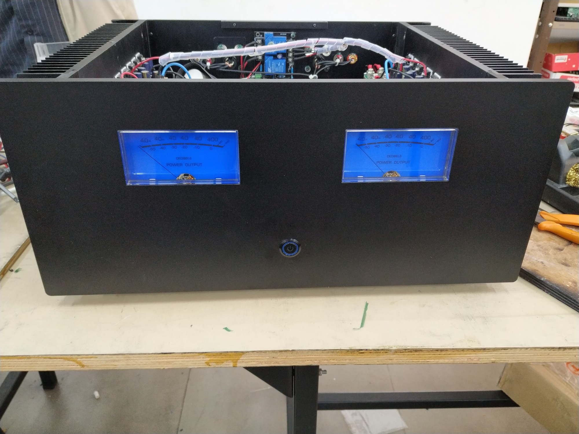

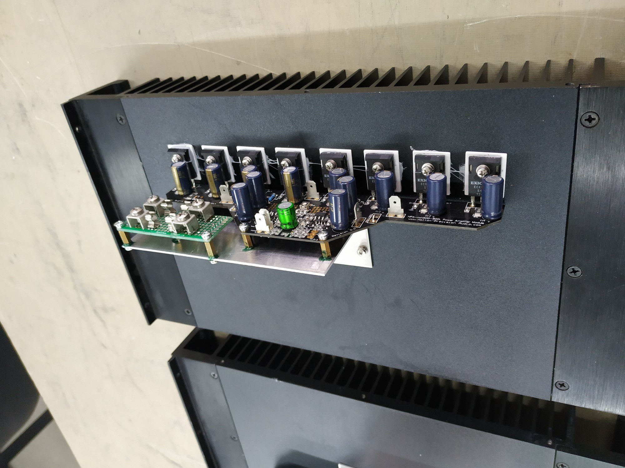

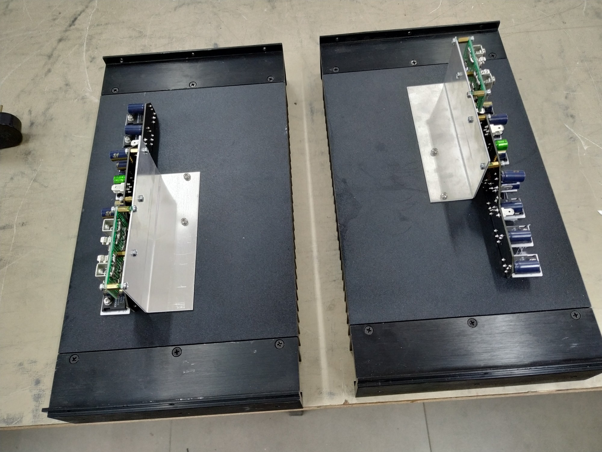

After so long i had the time to build my Holton Dual Mono amp based NXV500L.
main parts list:
1 x Holton AC Main (Soft start)
2 X Holton NXV500L
2 X 1000VA Noratel Audio Grade 55V x 2
1 X YHDC Transformer for DC Protection board and VU Meters board.
2 X 6 Nover 10000uf/100V (60,000uf each)
4 x Mundorf Evo Cap (Input caps on signal)
1 X KSA50 custom Chassis from Quany Store.
1 x Motronix VU meter board.
2 x eBay Blue VU Meters.
1 x eBay DC Speaker Protection board.
Neutrik Silver XLR, CMC Rca, CMC Binding posts, Furutech IEC, C&K toggle switches, Mogami cables.
Amazing, we had checked the amplifier for 2 days on Ekta Grande and noticed so much improvement in every aspect from the Rotel 1080 power amplifier (Details, Stage and Focus), currently the amp in storage because of Apartment renovation.Nice! So how does it sound?
Queenway Store - Small Orders Online Store, Hot Selling and more on Aliexpress.com | Alibaba GroupWhat is "Quany store"?? Chassis...
BTW, im really recommend not using transformer with Solid core wires, its really difficult to work, you can't cut them and solder because if you cut you have to remove the coat on wires...
