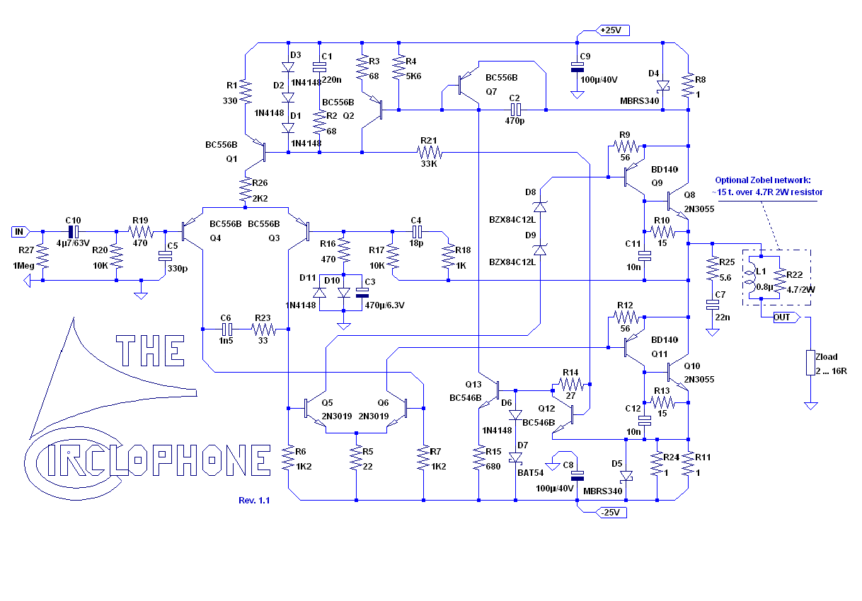

Thanks for your involvement.
-All resistors can be 1/4W
-The output transistors, Q8 and Q10 obviously need a heatsink, as do the drivers Q9 and Q11. All four can be a common heatsink, or be cooled individually, or grouped in any convenient way.
-Q5 and Q6 do not normally require a heatsink unless operation at supply voltages above 45V is desired.
-No direct thermal contact is required between transistors, but the following pairs should preferably be mounted side by side: Q3/Q4, Q2/Q7, Q5/Q6, Q12/Q13.
-For D7, any small TH schottky will do, BAT81 or BAT85 f.e.
-D4 and D5 can be any 3A or 5A schottky, 1N5820 or something larger in TO220.
-Splitting D8/D9 is not required, but gives more flexibility.
-I didn't include an inductive Zobel network, because it would only be necessary in very extreme cases, but provision for it could be made on the PCB (and strapped in most instances).
What is the purpose of R14 (27 Ohms, between base and collector of Q12) ?
It provides a first order cancellation of the dynamic resistance of Q12, making the quiescent current largely independent of the supply voltages.

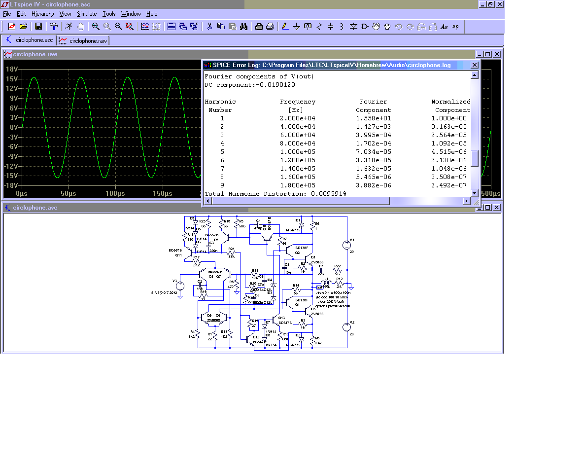

Here is the sim at 20KHz, the THD is doubled compared to 1KHz, but as I said earlier, the sim is not reliable at higher frequencies, and I'll need to make an actual measurement to confirm the value.

Well i may just be rambling here, but in my world, a amp that does 0.1% THD at 20kHz is a bad amp.
Though i realize i contradict myself here since the stereo npn amp simulates 0.1% or worse at 20kHz and kinda wonky phase, yet its one of my best sounding amplifiers.
Elvee: It is your design. Show me where you would implement a Zobel so I can include it on the pcb.

Tekko: I understand what was ment by a Zobel, but it is Elvees design and the designer should make that addition.
Here is a modified version of the schematic.

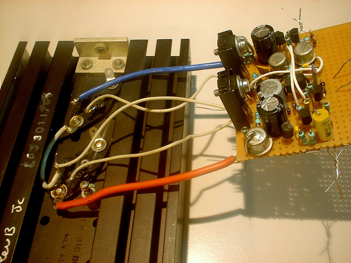

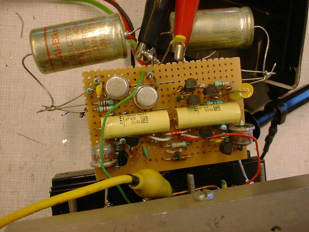

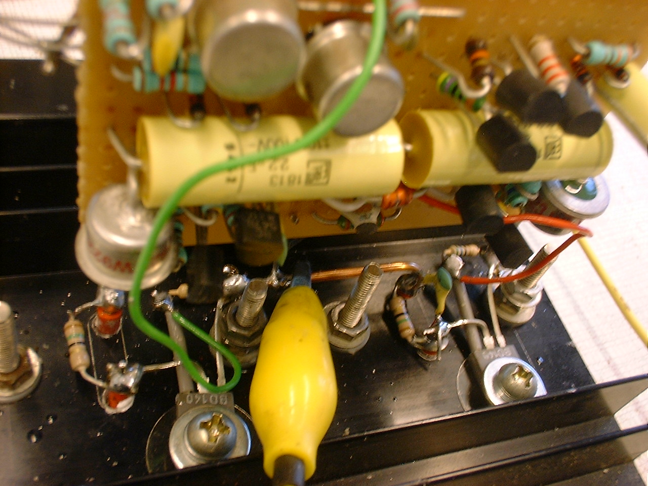

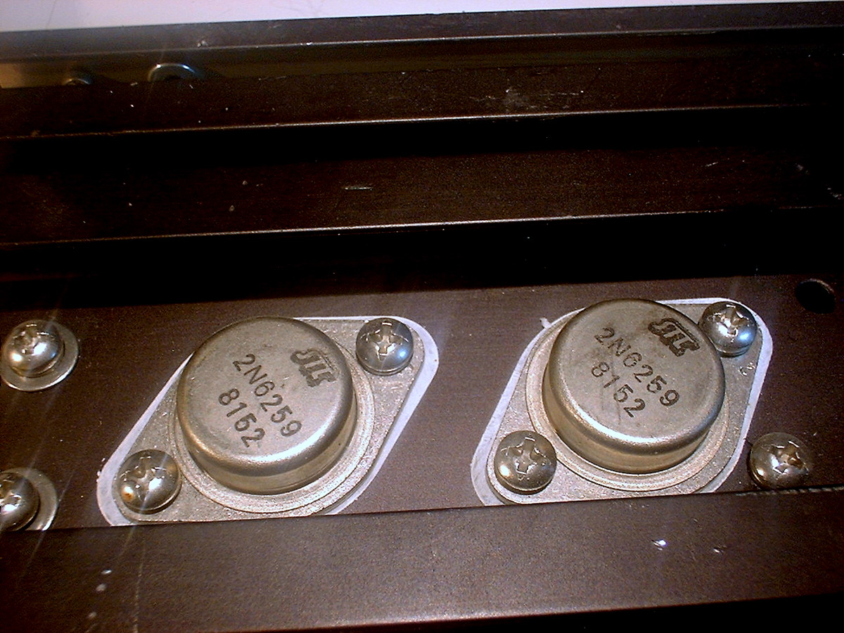

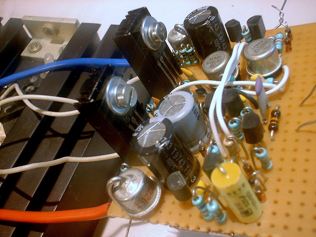

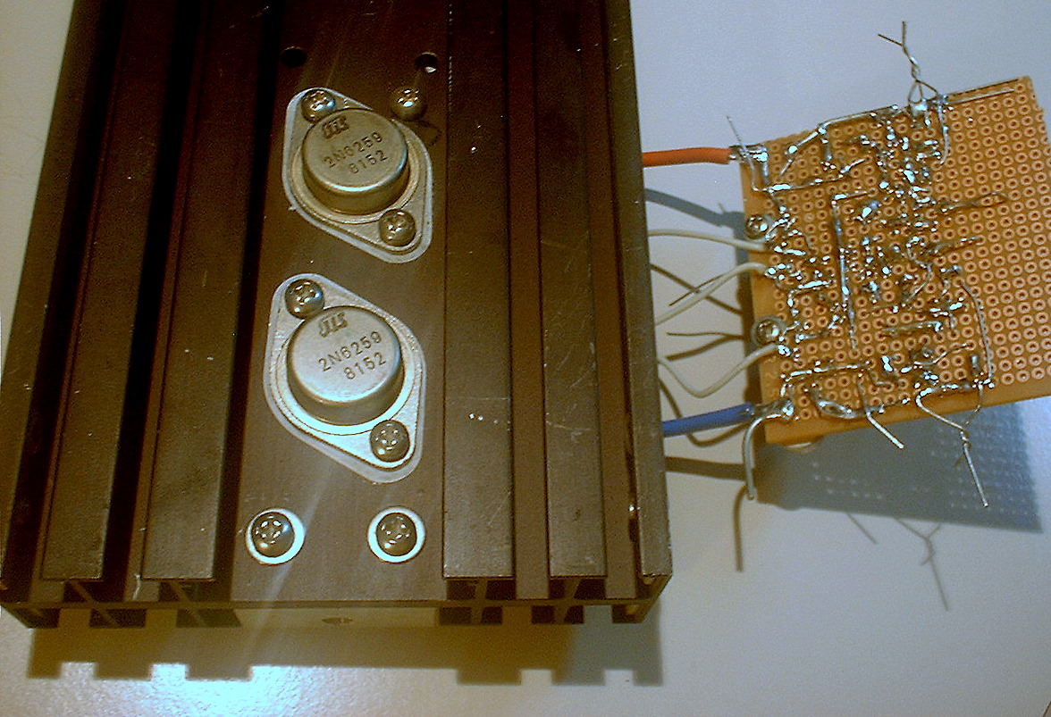

Can we see more pics of your board?
Here they are, plus pics of another prototype.
Note that with the ~10cm of wiring between the heatsink and the board, the transient waveforms are a shade less immaculate than the ones shown for the other prototype (they remain excellent though).

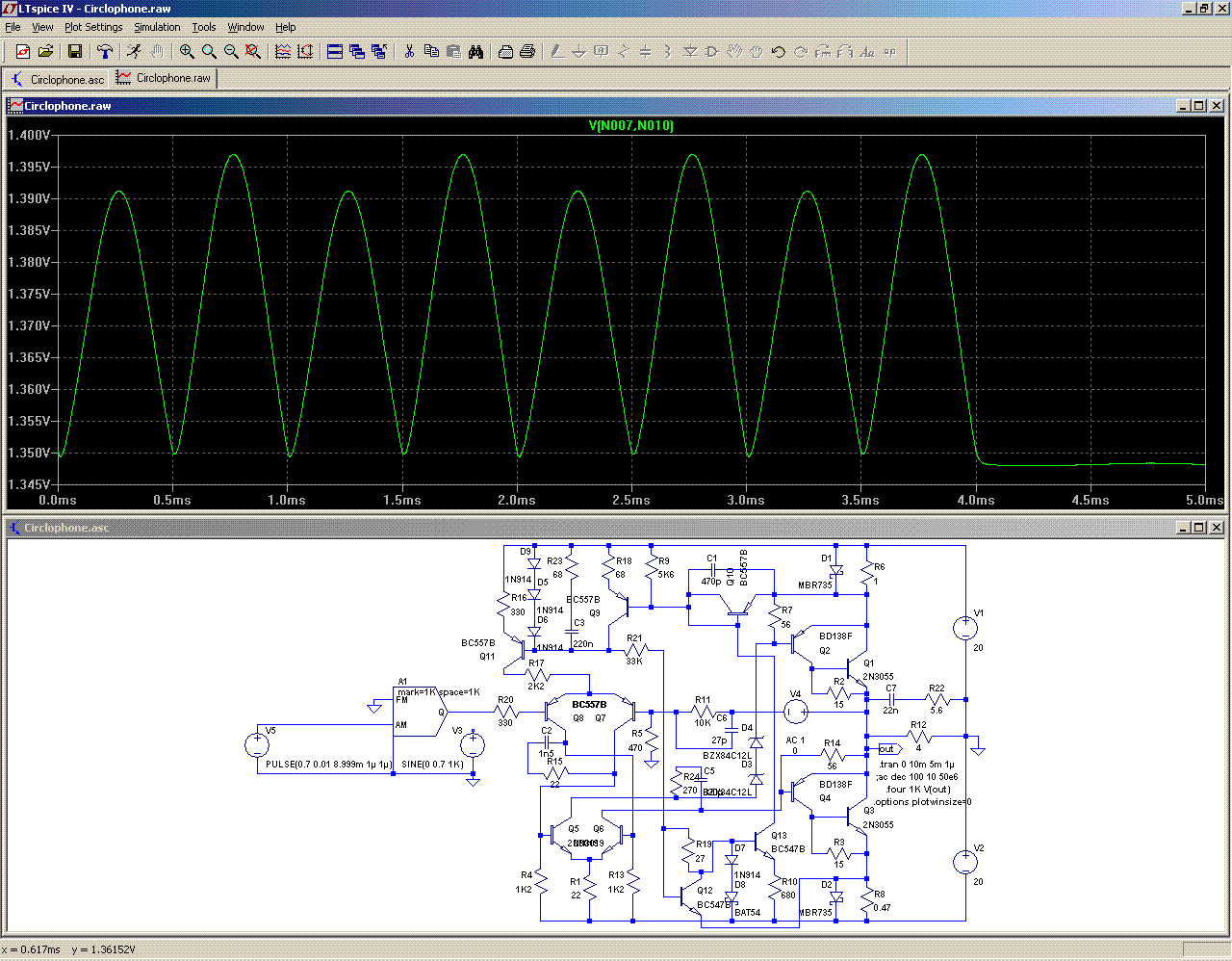

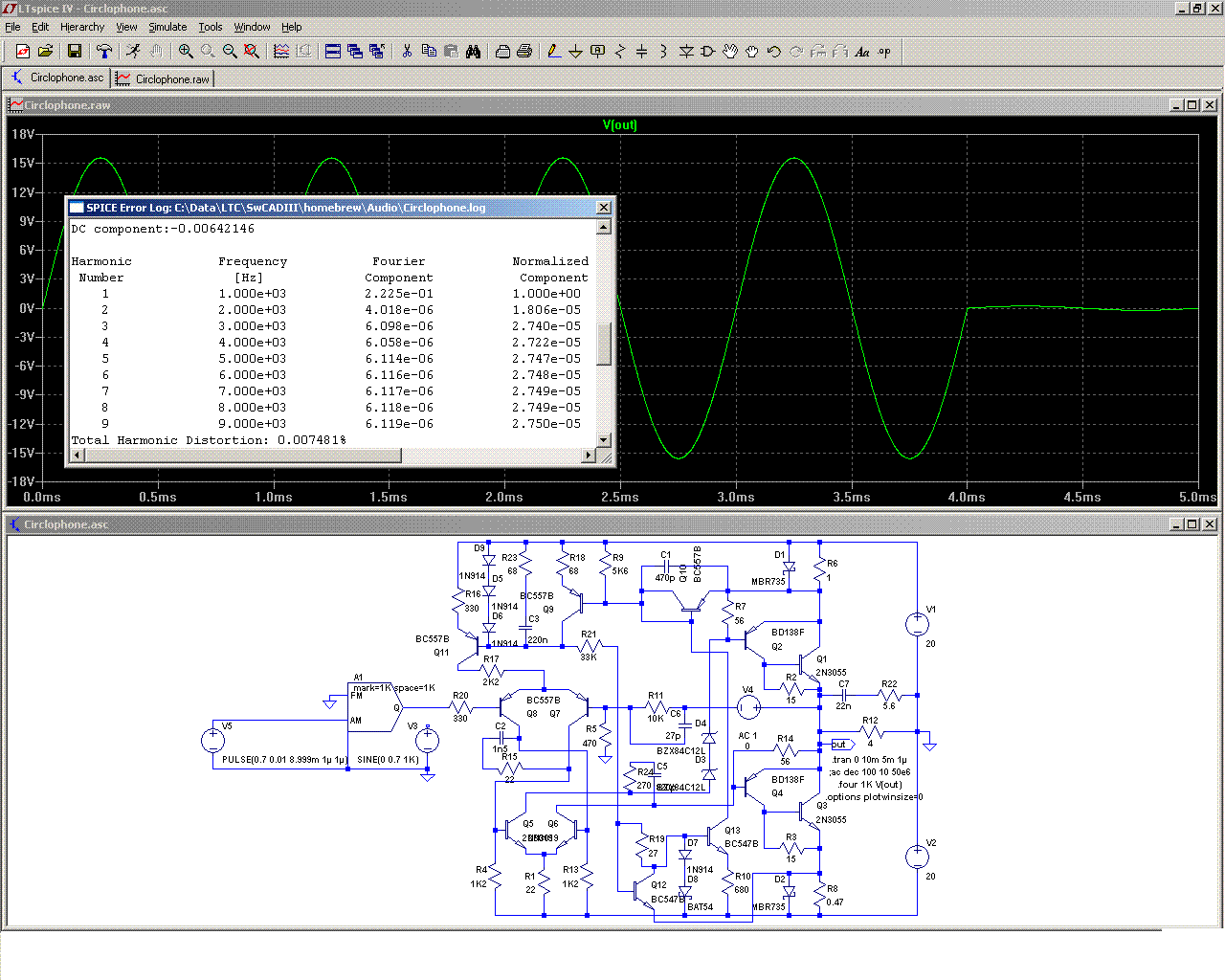

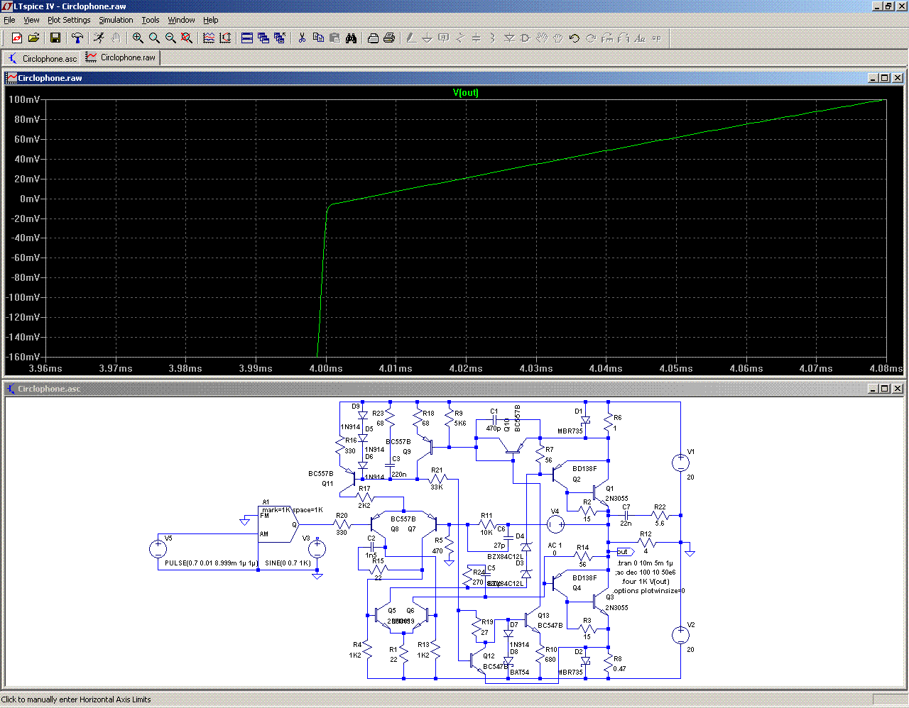

Here is a first test along the lines suggested by Wavebourn.
The signal consists of 9 1KHz cycles at full power and 1 cycle with the amplitude reduced to ~1% of the maximum.
First pic shows the general outlook and the distortion: there is a marginal increase in the THD, but it remains quite gentle (LTspice calculates the THD over the last cycle of the waveform).
The second pic shows the instant of the transition magnified
The third pic is the voltage across the loop filter cap, C3 in this schematic, C1in the first schematic.
This tends to indicate (and is confirmed by the actual tests), that the servo is very clean and well behaved, and cannot be "derailed" by transient conditions the way the Visch is.
