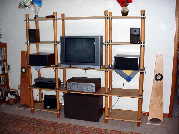

With Marian's cooperation, our living room and dining room/sun room have been substantially re-arranged. The Metronomes are now in the LR about 2" from the wall. Wow! Did that ever make a difference! Not quite where I want the sound to be yet--still too 'bright'-- but SOOOOOO much better. Only trouble is that both aesthetically and acoustically it would be preferable to have them out just a bit more so that they aren't 'obscured' by the bookcase. See photo below.
Placement also has affected the Polk Rti6's. Moving them from stands (to make room for the Metronomes) onto the bookcase destroyed their sound stage. I will leave them there for the moment until we complete room re-arrangements--haven't decided which speakers go in the dining room & which move up to my office. Also visible are the Visonik David 602's and their associated sub.
I'm almost ready to start removing some of the foam lining from the interior front panels of the Metronomes.

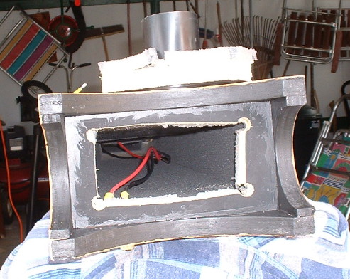

Steve,
My arms & hands are sore & bruised from trying to dig the foam out of the Metronomes.
That driver hole is SMALL.
What I could get out did move them in the right direction, so I'm taking a drill & saw to the port baffles to enhance access. When I get the foam out, I'll patch them back together as best I can. If they sound OK then, I may build new enclosures so that they are done right.
Cheers, Jim

Yes
My arms were killing me for days after I ripped the lining out of mine.
Eventually I had to get my wife to drag the last bits out as she obviously has smaller
hands and slimmer arms than me.
I'm sorry you have had to go through this Jim.
I'll drop Dave an email and see if he can alter the drawings to remove the instruction
to line the cabinet. Obviously it is not his fault. The fault is entirely mine.
I think constructors would be better served if the instruction was to leave the cab unlined and just use wadding to tune the speaker to the room.
Once again, my apologies.

Steve,
No apologies needed! This is a DIY area and all caveats apply. Or, as Ben Franklin said in Poor Richards Almanac (IIRC): "Free advice, worth every penny you paid for it." I'm learning. I'm getting there.
Here's what it looked like when I took the drill & a key-hole saw to the port baffles:
I got the front & one side clear, w/ the exception of the very top, where there was no way to get the stuff out. Now I have to get them back together.
Cheers, Jim

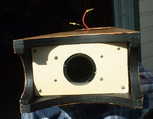

I patched the gutted Metronomes back together using duct tape to hold the cut-out piece in place and secured it with a piece of 1/8 inch plywood and screws. Not ideal, but good enough to test out the system.
And OH MY! What a difference! Now they're sounding good!
I just received the four test CDs from Stereophile and purchased a sound level meter from Radio Shack. Not sure yet how to make meaningful measurements, but when I listen to the 1/3 octave warble tones, I hear response down to 50 Hz, with something still there are 40 Hz. I think they are producing a response close to the graphs in posts #26 & #28.
Photo below shows the patch on the port baffle. When I get everything to my liking, I plan to build a new set of cabinets using all I have learned, including veneering the entire sides so that not only are the edges of the birch ply covered, but the butt joint as well. And I think I will make the port baffle removable for 'emergency access.' I only used half of the 4x8 ft sheet of plywood constructing the Metronomes, so there is sufficient material left for the final version.
Again, my thanks to Steve, Scott, Dave, and Martin for their contributions! I couldn't have done this without all your help.
Cheers, Jim

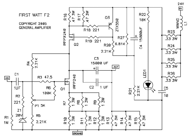

I had similar experience with fullrange drivers (Fostex FE206E and Visaton B200) . In the beginning, they both sounded so screechy, tiny, awful! I was sure they were a waste of money. Thanks to the help of guys on this forum, I’ve learned ways to tweak fullrange drivers, and be more patient. Over time sound really improves.
What I would suggest is to build (or buy) some of the Pass Firstwatt amplifiers. F2 is a simple amp that should work wonderfully with your Metronomes.
Best Regards,
Vix
Best Regards,
Vix
Jim Shearer said:Vix,
Where would one find plans to build an F2? My only experience building electronics was decades go when I did a kit amp in high school.
Cheers, Jim
Building an F2 shouldn't be hard, you'll enjoy it. Have a look at Pass labs section of this forum, there are some nice people willing to help.
For the beginning, read owner and service manuals posted by Mr. Nelson Pass at http://www.firstwatt.com/downloads.htm
Mr. Pass is a great, generous and appoachable person. He's got a lot of understanding for beginners and will ofter reply personally on the forum.
