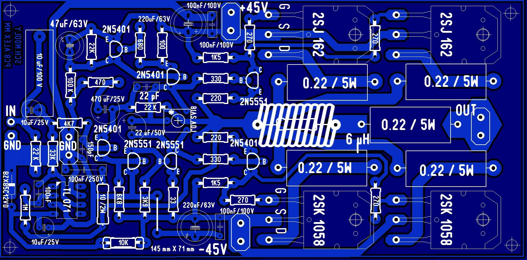

dear ge ,
you use both(q8,q9) n channel transistor 2sk1058
thanks your ever masood
dear mooly,
in poll 264,mr.GEirin has use (Q8,Q9) BOTH 2SK1058 and you use 2sk1058 and 2sj 149.
what is the right.
thanks
The circuit in post #1 is correct, although not shown on that diagram (because I forgot to draw it) is a 10 ohm 2 watt resistor across the output inductor.
Nothing has changed since that time, the circuit is a complete tried and tested design that has been in daily use for the last 6 or 7 years.

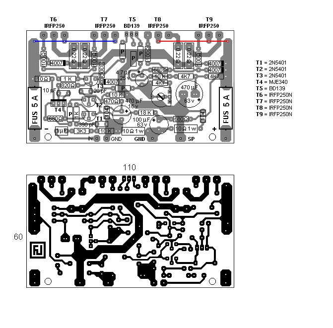

dear mooly
can i use mosfet transistor irf830 and irf 9630 in place of 2sk1056 and 2sj162.
thank you yours masood
The amp was really designed for the lateral FET's and I have not evaluated the performance using HEXFET's.
That said they will certainly work but you MUST include a vbe (or vgs) multiplier. This must be attached to the main heatsink. Beyond that I wouldn't like to say because the amp was designed from the ground up to use laterals. It would need re-optimising to get the best performance from the HEXFET's.

t is request you to send me the pcb copper side of 200w amplifier using two npn and two pnp mosfet transistors.i will highly obliged if you can this.sorry for not expressing my feelings.thanking you
yours ever masood
dear mooly
yours ever masood
Hi Masood,
I only have the PCB layouts for the single pair lateral FET version.
dear mooly,
thanks for reply but give me any source .thanks in anticipating reply my email is khan.shahid251@gmail.com
yours ever masood
yours ever masood

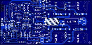

DEAR ALEX MM,
PLZ SEND ME THE PCB COPPER SIDE OF PCB USING TWO PAIR OF 2SK1058 AND 2SJ162 THANKS ALOT YOURS MASOOD
