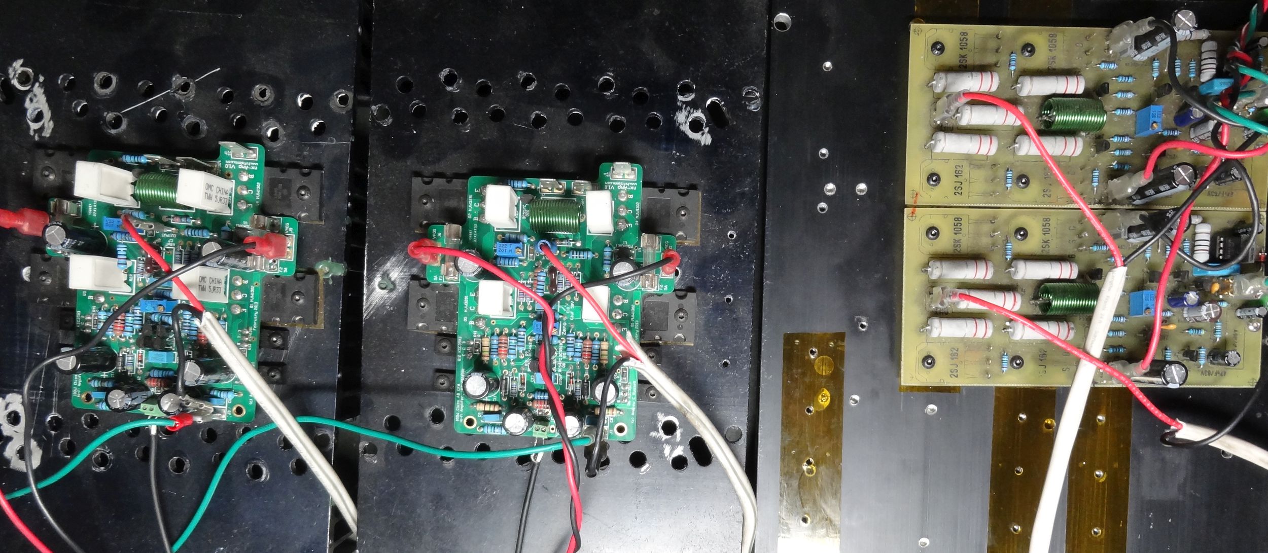

Hi Guys,
Ramr asked me to do a comparison between this Mosfet amp and the Ovation NX. I finally got time today and hooked both amps up to my A/B setup. This amp is running on +-44V and the NX on +-47V. Both PSU's have 20,000uF filters per rail.
After listening for about 5 hours I find no audible difference between the two. Both are extremely clear with tight solid bass. Everything I played through them sounds wonderful.

Try to replace the 2N5401 input transistor with 2SA1015 GR.
The 2SA1015 is to close to its Vce limit to use safely.
The original Hitachi 2SA872A (gain group E) could be a superb choice but these are long since discontinued.

I just said it sounds as good as the NX. Why would I want to change it? I did this comparison by request. I only shared my findings for those who might be interested. Not to create more work for myself.
I just said it sounds as good as the NX. Why would I want to change it? I did this comparison by request. I only shared my findings for those who might be interested. Not to create more work for myself.![]()
Hehehe you said "no audible differences" and I just found that it is strange
The low noise A1015 GR (Vce=50V) at input stage is only a clue, where small change can create audible difference.
A1015 with Vce=50V is the highest Vce rating low noise transistor that I know. If you think it is not save (due to unreliable current production), don't you think it is a good idea to bring voltages down so we can use low noise transistor, especially at the input.
I'll find out about the Hitachi...
For many years, 2SC2240/A970 have been the undisputed BJT champs at low noise/high voltage applications in the input stage.A1015 with Vce=50V is the highest Vce rating low noise transistor that I know. ..
Now we use KSC1845/A992 as the only equivalent THT pair still in production. I think though, by trying to use common obsolete parts or those extracted from old consumer equipment, you would limit your design options and the ability to know what others are hearing.
These sell for US 0.33 ea/1 or $0.10 ea/100 from Mouser and probably not too expensive for small quantities through their local representatives or those of Digi-key, RS, Farnell etc.
I have many of those you mentioned (but I'm curious with the Toshiba Mooly had mentioned). There is discussion about vintage amp versus modern amp...
IMO, if only manufacturers have the incentive to produce special transistors for audio (especially for the VAS), amps will be a lot better than ever. I found that in producing a good amplifier nowadays, nothing can beat a good choice of superior transistors.
