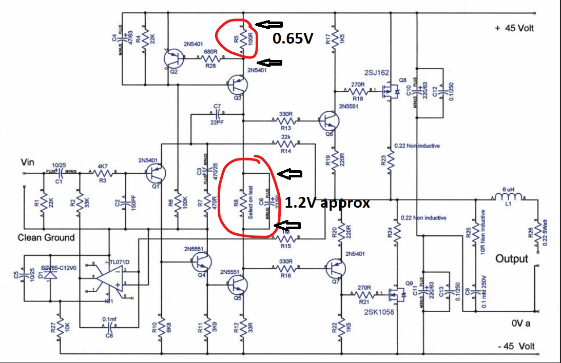

The fact both boards have different symptoms points to a construction error/parts error somewhere.
Some key basic checks are:
1/ The voltage across the 100 ohm in the current source. It should be around 0.65 volts.
2/ The voltage across the bias setting resistor should be around 1.2 volts and vary as the resistance is altered.
If you link out (short out) this setting resistor then Iq should fall to zero. If it doesn't then there is a problem in the final stages, driver and outputs.

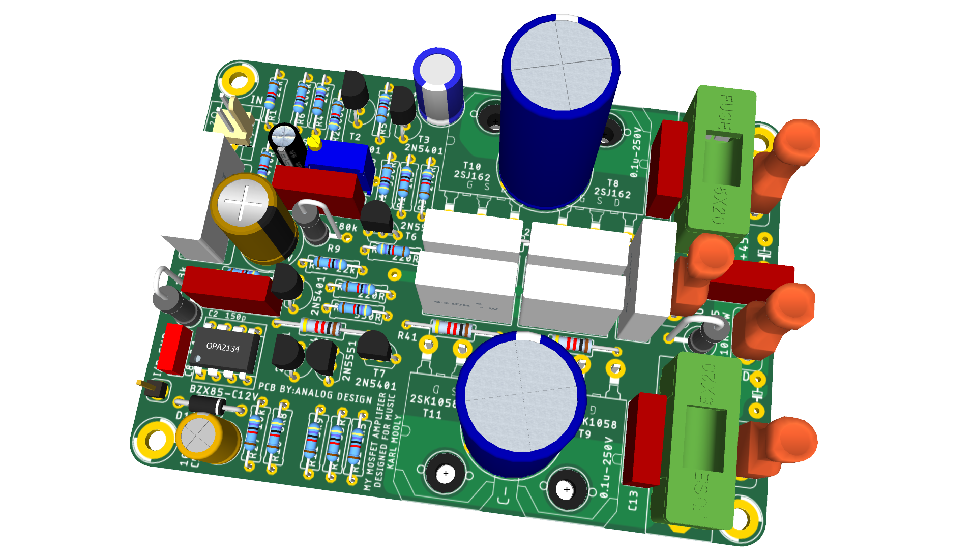

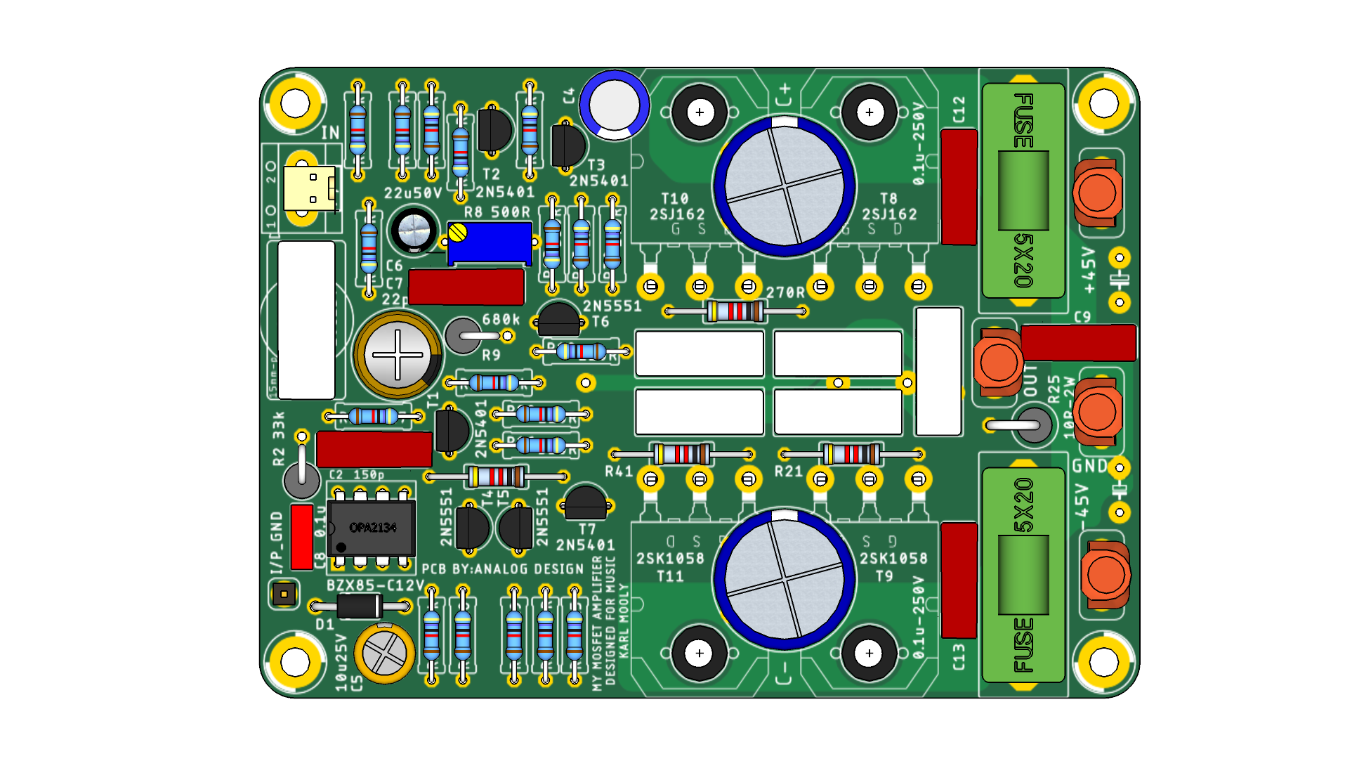

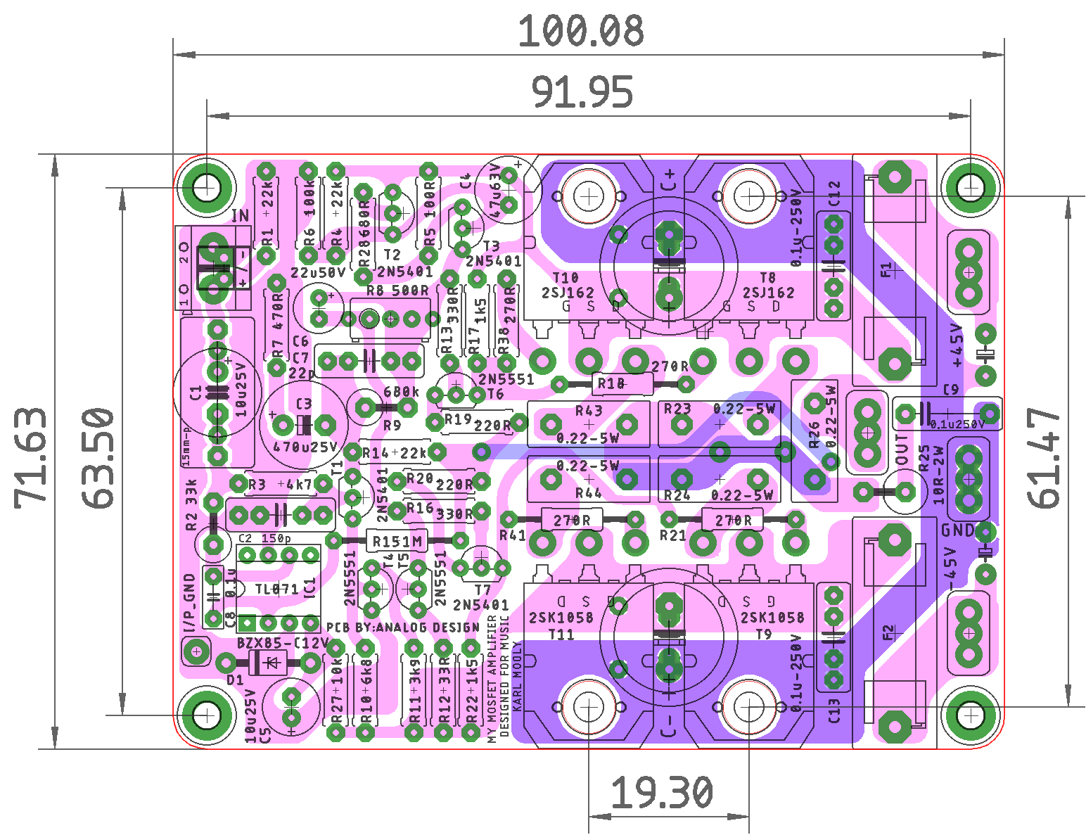

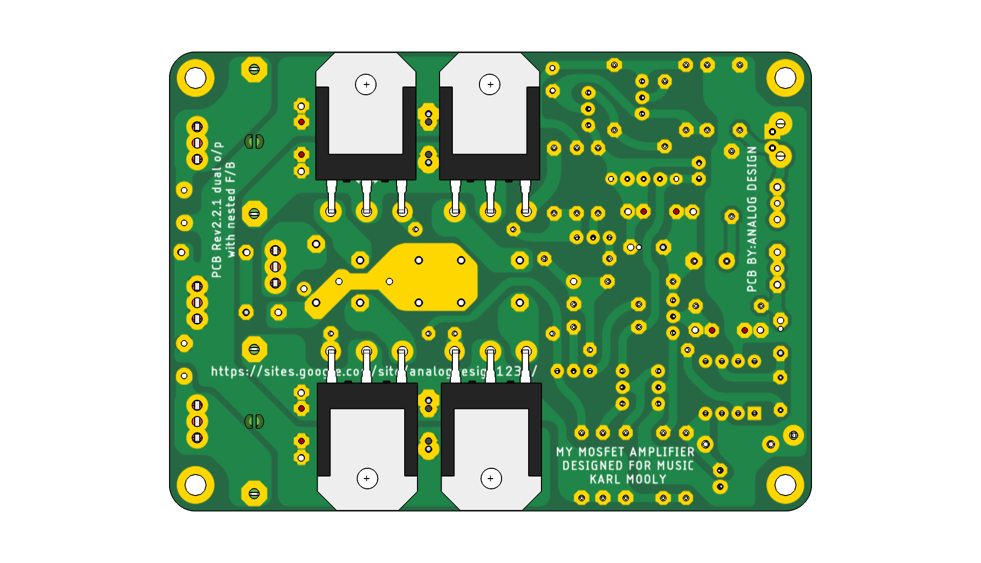

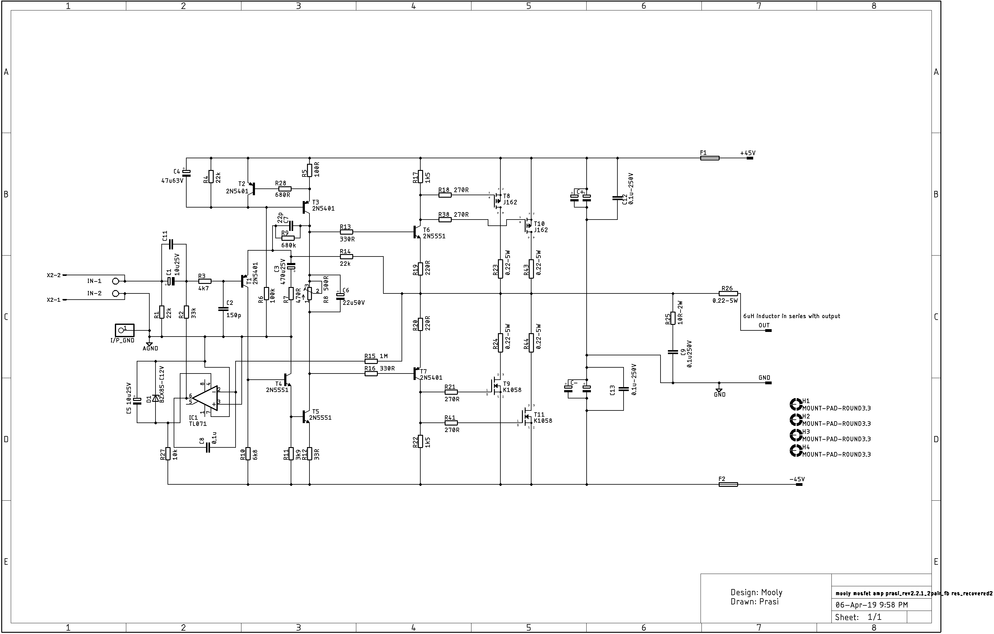

Are Prasi's gerber files for the slimmer width PCB posted somewhere? I couldn't find them in the thread.
I cant remember if I posted them, here they are.
regards
Prasi
gerbers_mooly mosfet amp prasi_rev2.2.1_2pair_fb res_recovered2_2019-08-02.zip717.9 KB · Views: 792

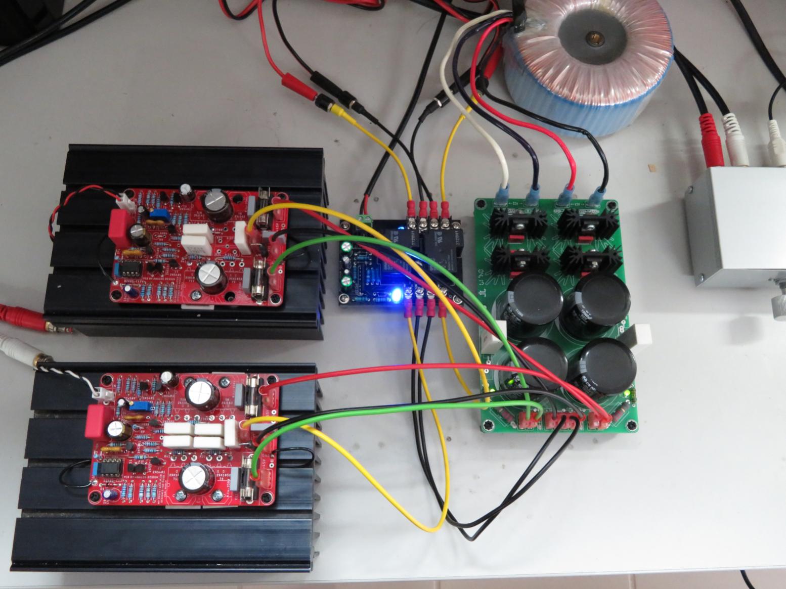

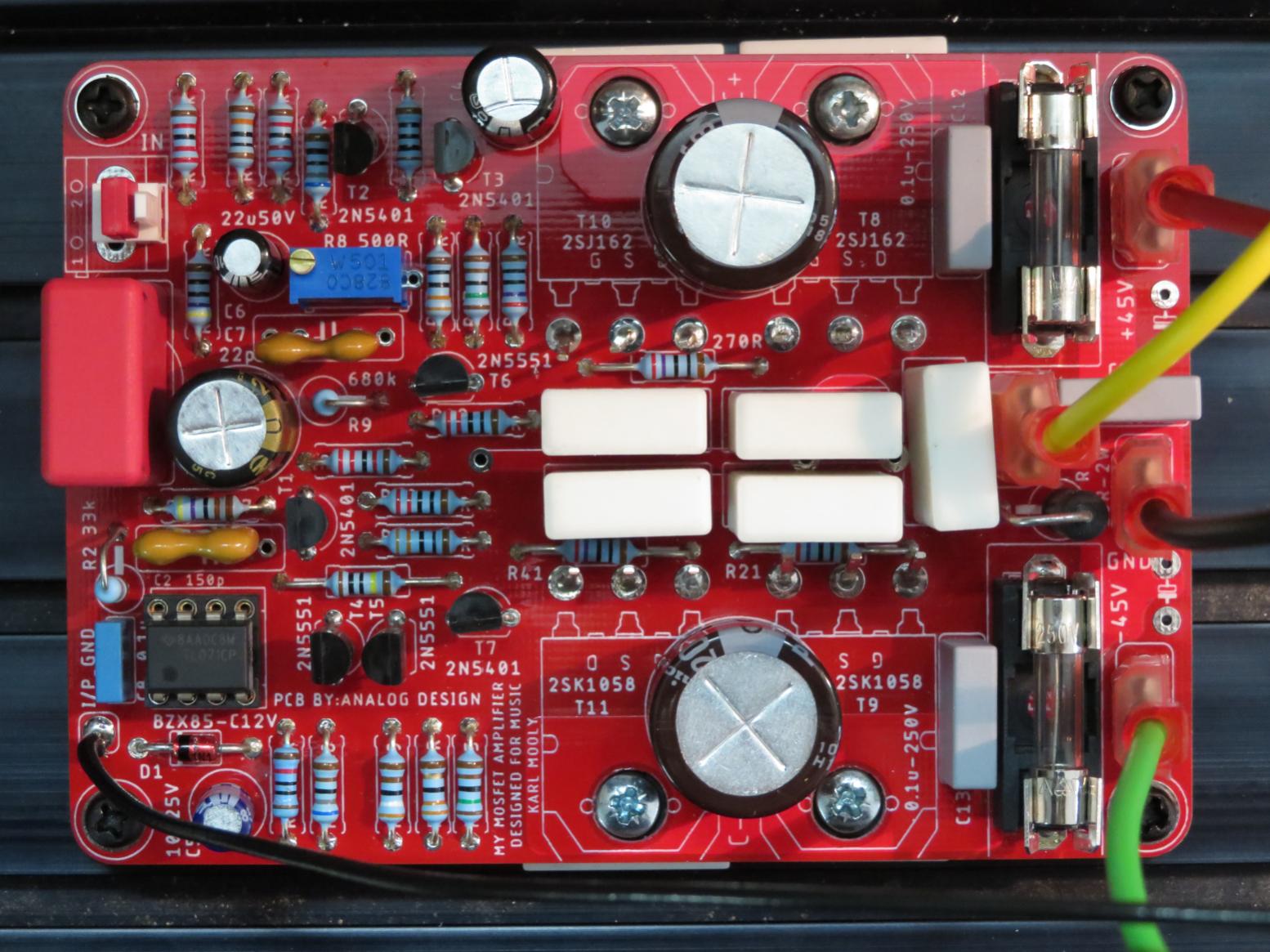

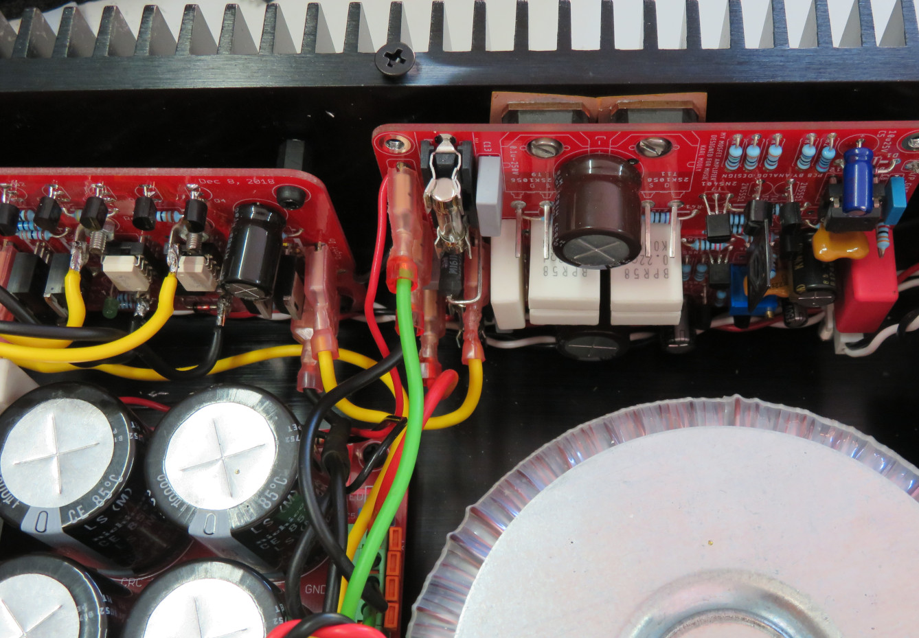

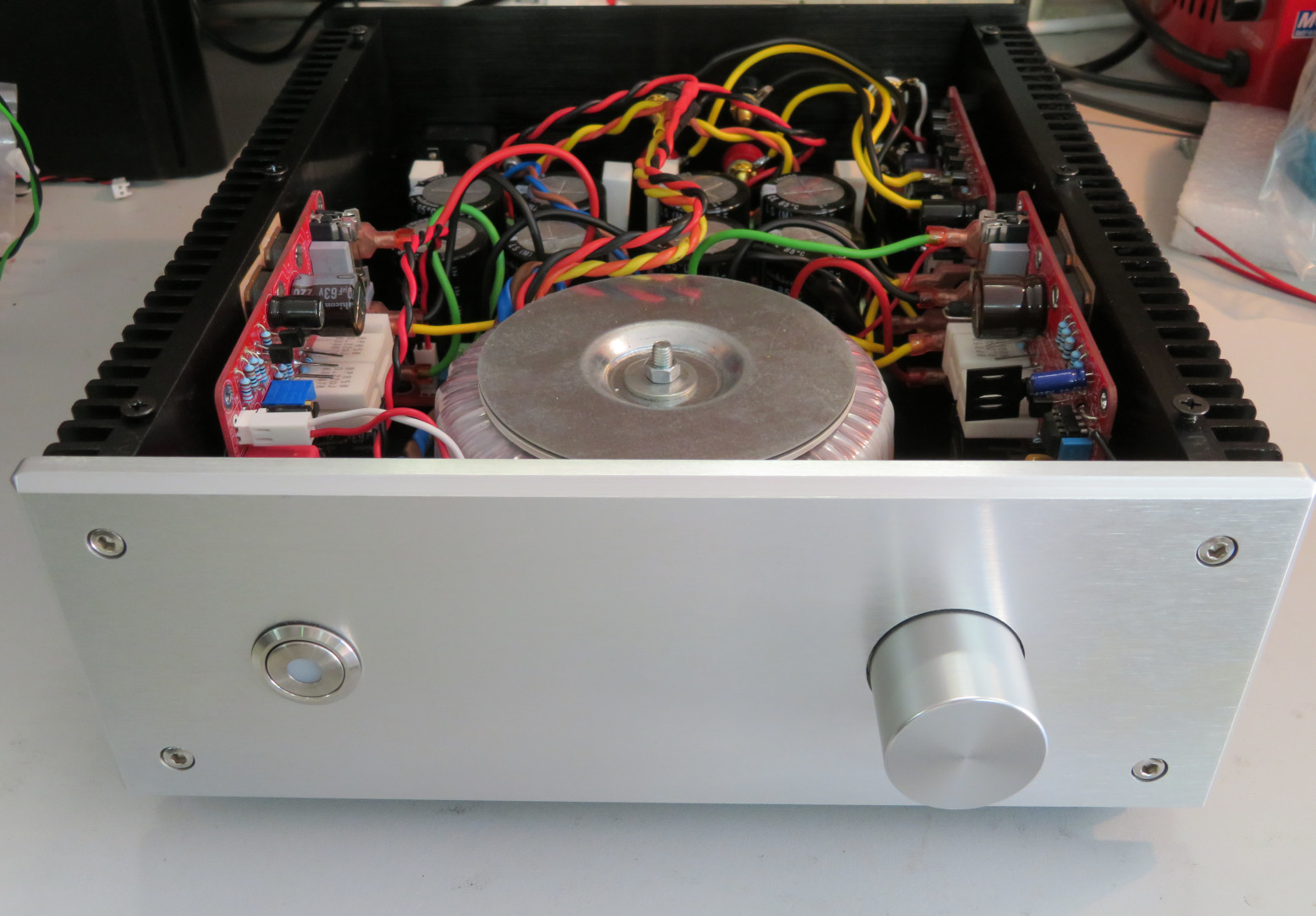

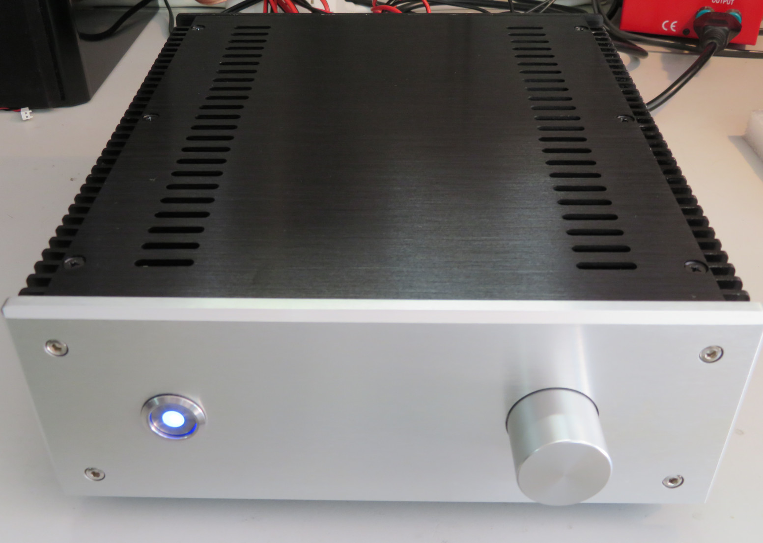

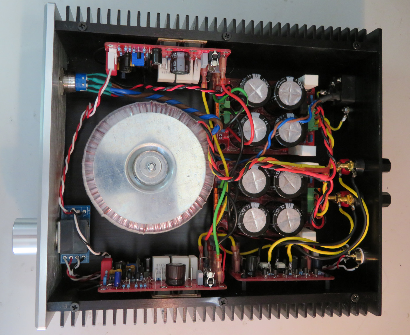

And now the finished amplifier built with the help of Philippe for mechanical and wiring 😀
It will replace the Quasi for driving outside speaker for musical dinner and cocktail in the bamboo dinning house
Ciao,
Marc

Hello Hugh,
Thank you very much for your kind words.
Hello Marc,

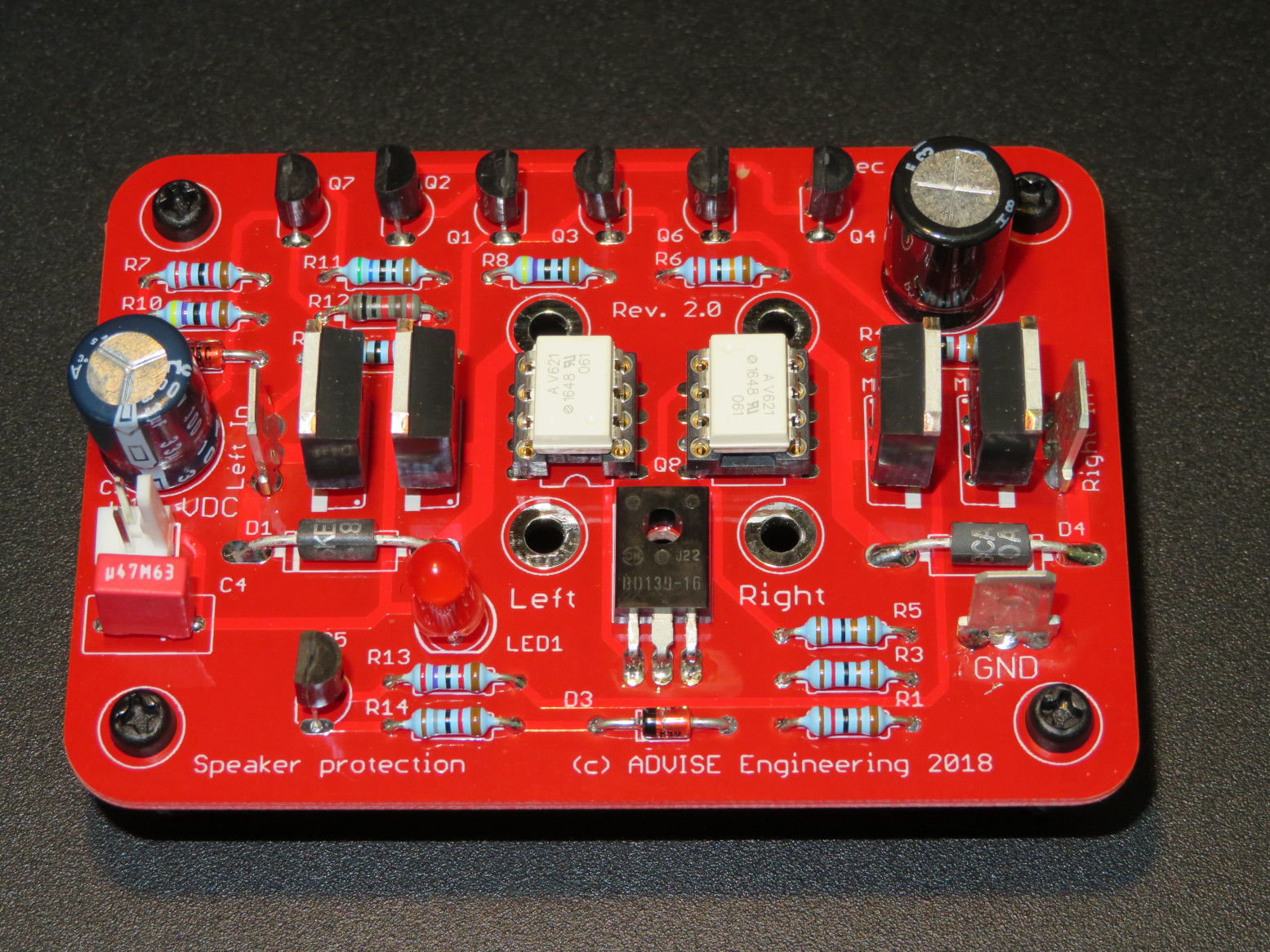

Thats a very compact and very nice build. Is it a SS relay protect PCB?
Enjoy the cocktail dinner with your new musical amplifier!
regards
Prasi

Hi Mooly: You where correct about construction errors. At the moment I have 1.2V across R8 and .5 across R5. At the base of Q6 I have 2V to ground, at the base of Q7 I have .28V to ground and .4 at the output to ground. Could you advise please.
Thanks. Richard

The voltages on R5 and R8 are in the right zone.
I would check around the opamp. Make sure the supply voltage is correct as measured on pin 4. It should be negative 12 volts. The opamp output pin should be approximately negative 5.5 volts.
Make sure the opamp is a genuine TL071.
If you are running on a lower supply rail than the original -/+45 volts then you will need to decrease R27 which is a 10k feeding the negative supply to the opamp.
