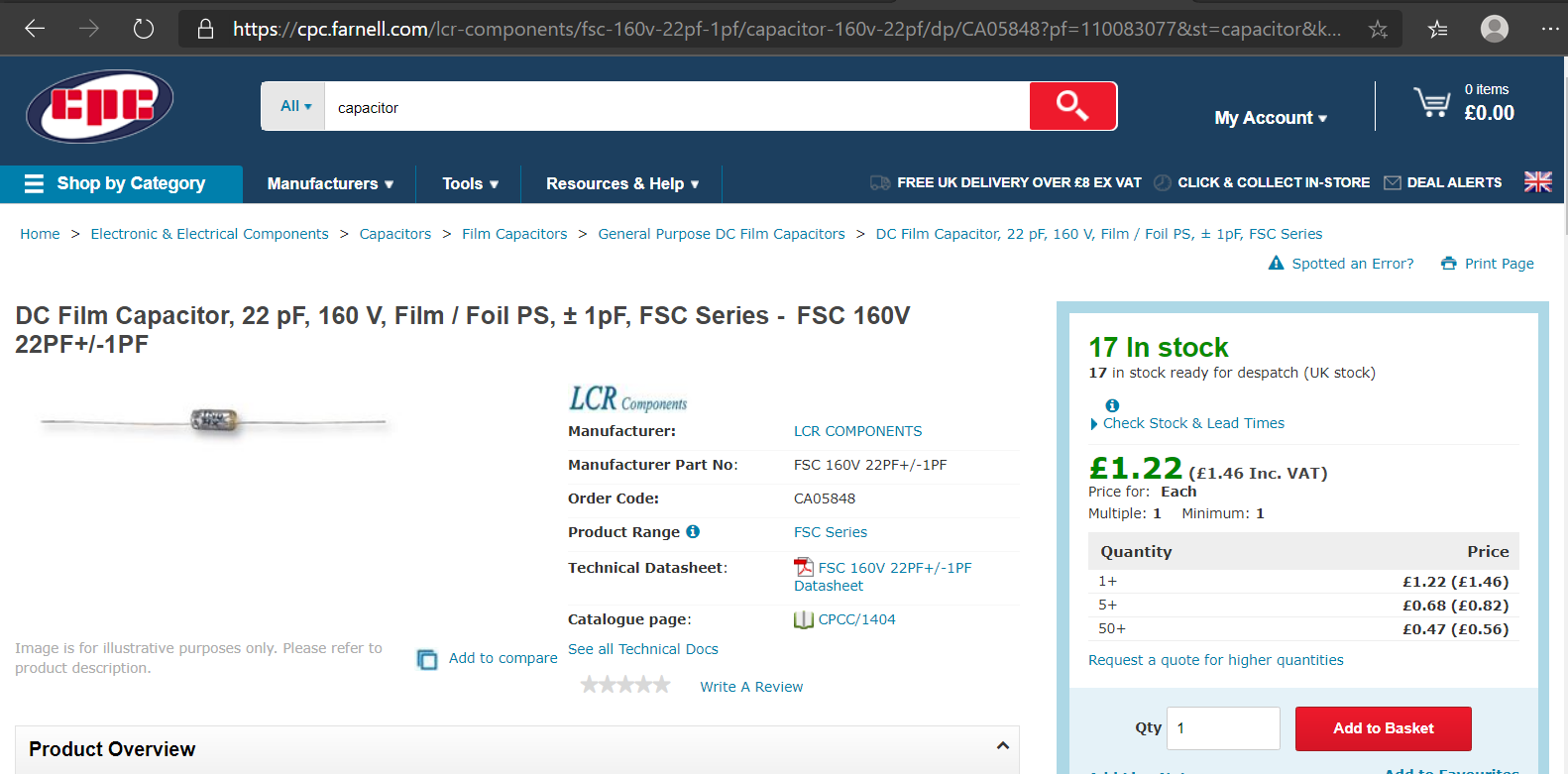

My "problem" is that I have no idea on how a metal cap is reacting vs a polystyrene cap, so I have to try to follow the schematic. But my idea is also that the designer, have selected values and types for a reason.
I do also struggle with some of the values, you have two caps, one with 22 as text and one with 22p as text. So I am assuming that no unit means the standard unit Micro.
The value of 22p polystyrene, have I learned is the same as a Polypropylene but I can't find such a low value.
Polystyrene caps are generally obsolete but they are treasured by some audiophiles for their subtle tonal effect and loathed by others because they melt if you are not quick enough at soldering or the leads are not long enough to limit or sink the heat. They are still made in low volume, often by hand and thus expensive. Even if you can buy them as NOS on Ebay, don't try these unless you can solder fast, your skills and preparation are good, the leads are very clean and bright and the solder/flux combination tins rapidly.
NPO or COG grade (multilayer or MLCC type) ceramic caps are standard types, quite small, thermally stable and otherwise best suited here if the voltage rating is adequate. Cheap, standard ceramics are only 50V rated which is not enough for many audio applications. Other ceramic grades usually have weird distortion and high thermal drift problems so don't try them in critical areas like the input stage, compensation and feedback path of amplifiers. Google is your friend for general information, data sheets etc. of any specific grades of capacitor. Or, try this with translation software: Ceramic Capacitor: MLCC, X7R, C0G, Y5V... >> Electronics Notes
