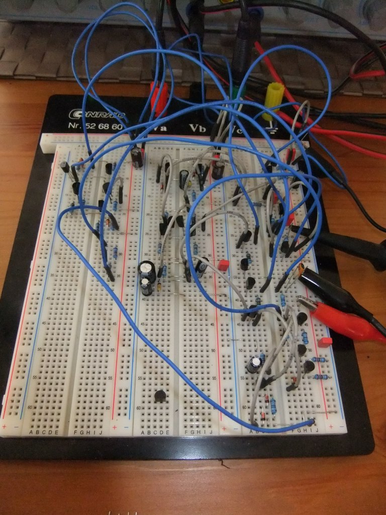

The breadboard contains the single ended inputstage (using BF245A as input devices for now), the VAS gain block, bias control and an output buffer follower so I can employ NFB without loading the VAS. All devices are BC550C/BC560C.

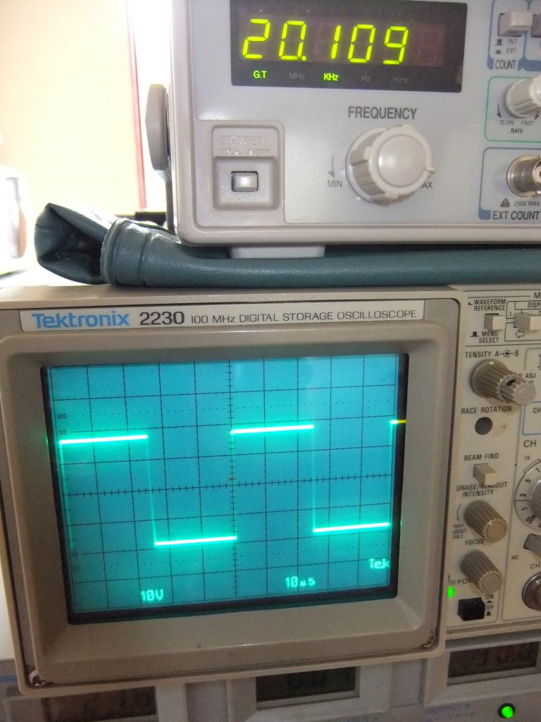

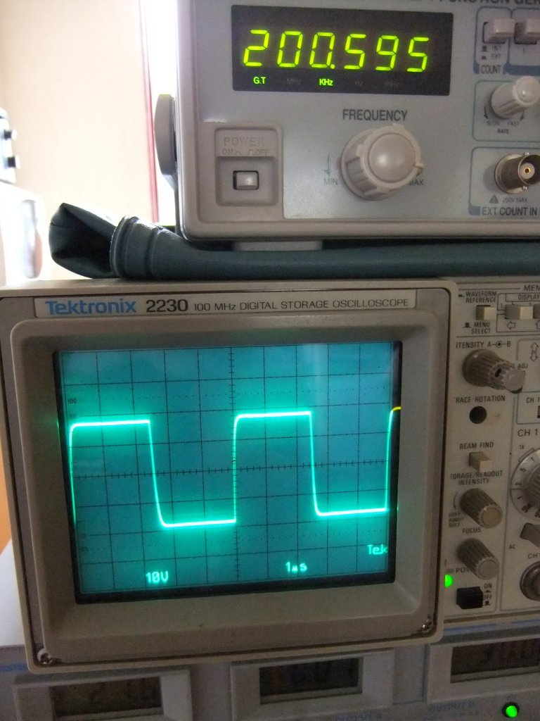

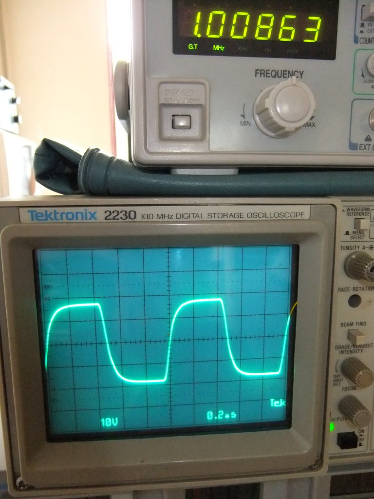

I've been running square waves to test and I've been able to optimize it achieving all the traits. The bandwidth is numerous times higher than I achieved with MF80, a basic symmetrical push pull design. There is a roll-off filter of 8MHz.
I've made a few pictures for you to judge, a 1MHz, 200KHz and a 20KHz square wave and a picture of the mad scientist's project
The 1MHz square is still full-power.

That is phenomenal HF performance for a plugboard prototype !
Is testing to max, hiding overshoot or ringing?
Thanks! During building the circuit I learned the finer details of the tuning mechanisms besides the more obvious like Cdom. The circuit has cascoded VAS devices. The following mechanisms I've found:
-Cdom1: Across output cascodes, determines speed of VAS rail.
-Cdom2: Feedback cap across output and VAS input (single ended, inverting input)
-Rfb: Influences, togeter with Cin of inputstage the transfer speed between output and input
-Re1: Degens resistors of input stage, speed of input stage.
-Re2: Degens of VAS input devices, speed of VAS input stage.
By adjusting all of these, trying to tune the speeds of stages so the 'previous' stage is as fast or slightly slower than the stage before, I've been managing to remove over/undershoot as much as I could. I could remove the input filter and it would still be stable but it would show some ringing as it then becomes too fast for the circuit to follow.
It's been quite an adventure pushing and pushing the performance of the circuit. Even the rail litics are needed to retain stability, their effects are clearly visible on the scope, as well as the decoupling elcos across the zener references for the cascodes so their bases can draw the instanious current.
