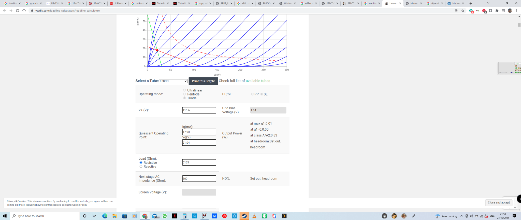

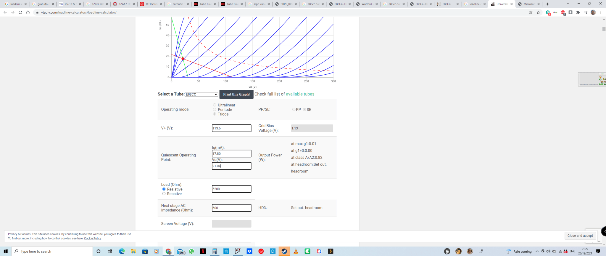

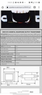

My Sowter's have 3 secondary coils used for 3 difference ranges of headphone Z.
So my Zload can vary between 3600-14400.
After much thought, I chose to optimise for 4940Ω as this corresponds closer to headphone values I'm be more likely to hookup with most others coming in at a higher Z to the one optimized for.
Some compromising, no doubt, but consider this:
The SSRP is currently set-up for a Zload of 300Ω ('cause I'm an idiot) and my Sennheisers are 50Ω, reflected as 7200Ω and it still has plenty of power despite the gross mismatch.
I can't wait for the parts to arrive to put this right.

The reason it has plenty of power is because the quiescent current is so high. I very often hear people saying this preamp or whatever has a very low output impedance (especially if it is a white follower) but all to often they forget that these figures are derived from theory and are actually small signal values. These tell you nothing about the drive capability of the stage which is determined principally by the quiescent current. Basic theory only takes you so far. Thereafter you need the thing on the bench to make measurements of reality.Mine isn't fixed either.

Just finished tweaking the amp. I corrected my mistake of assuming that the sowter transformers input impedance was a constant 300Ω... It's not. Z varies with the headphones plugged in and the range I selected. So the SRPP output stage wasn't optimized, for example, my 50Ω phones reflected 7200Ω, etc.
The SRPP was working as a single ended stage only.
Now it's properly stretching it's legs as a push pull.
