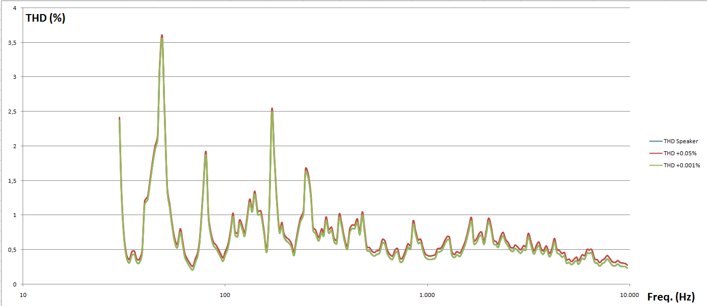

See the chart below.
This is an actual THD of the lastest 3-way speaker I've built last year - it sounds great, by the way, beating some known brands in the market (opinion from other people on A/B comparison).
The chart has the original speaker THD (Blue line) plus 0.05% (RED line) and plus 0.001% (Green line).
0.001% is not even possible to see - it gets perfectly superposed on the original.
Would you pay good money to have the green line instead of the red line?

Your speaker is not that good compared to this:You tell me.
https://www.diyaudio.com/community/threads/virtual-audition-of-very-simple-quasi-mosfet-amp.295286/
Yes, this other speaker is better than mine in terms of THD (around avg 0.3% and max 1%)
Mine has THD around avg 0.5% and max 2% to 3.5% on the room peak/null resonances (the measurement was taken indoor).
Since I had this real data on hand, I took it just an example to comment how electromechanical typical THD (>0.1% in general) compares to electronic low typical THD. The discussion focussed on how the small THD electronics influences the final THD sum of whole chain (vinyl, RIAA, amp and speakers) and how low should we push the electronics THD.
