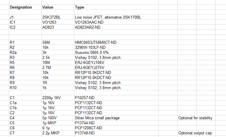

The R2a value is shown as 3k ±0.5%.
This resistor is in series with the 10k Variable R2.
Why is a 0.5% tolerance resistor specified?
Q3.)
The 1k R10 2k5 R3 and the 1r R9 are specified as Vishay S102.
What do these resistors do, that needs this quite specific resistor?
Can any 1r and 1k metal film be substituted?
If not any, what parameters are important for selecting these resistors?

C4 is optional and a 5pF is suggested. A position is not shown on the PCB. Where should this be located?

Q2 0.5% is standard tolerance for 0805 Susumu.
Q3 we want to use the best available, so S102. Have not done any analysis. Feel free to use whatever you ee fit.
Q4 Not required in multiple examples built by us. Ele solder directly on the pin of the IC.
