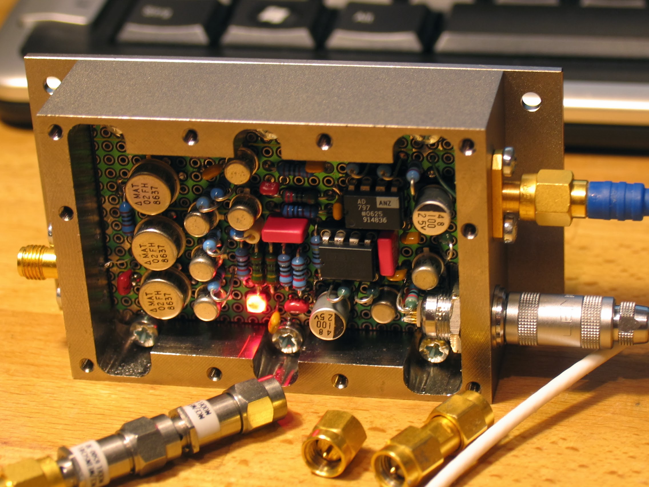

I have a similar problem with the measurement amplifier I'm currently working on.
I want to measure tiny noise voltages riding on potentially large DC ( phase
noise after a phase detector, sensitive supplies etc..).
Lower corner f is 0.1 Hz also and the C should be larger than required for this
for noise reasons.
Therefore I must AC couple right at the input, currently 10u foil + 110 Meg
+ many FETs. After connecting a DUT it takes an eternity to settle after the
FETs, cascode, transimp. stage that I need for bandwidth & noise.
I put a window comparator at the node cascode <-> active load
and when I'm not close to the chosen operating point I reduce the
input bias resistor from 110 Meg to 4.7 Meg, so things speed up by
a factor of > 20.
I use a MAX393 as a switch, that seems to work nicely. Does not
induce any transients during switching and the leakage is OK.
But my 25 BF862 seem to have some leakage, the 110 Meg
sometimes drop 1.5V DC from the bias servo.
Currently I play with bootstrapping the base of the cascode
to get rid of the FET's Cgd. Cgs is already taken care of by the
source feedback.
Gerhard

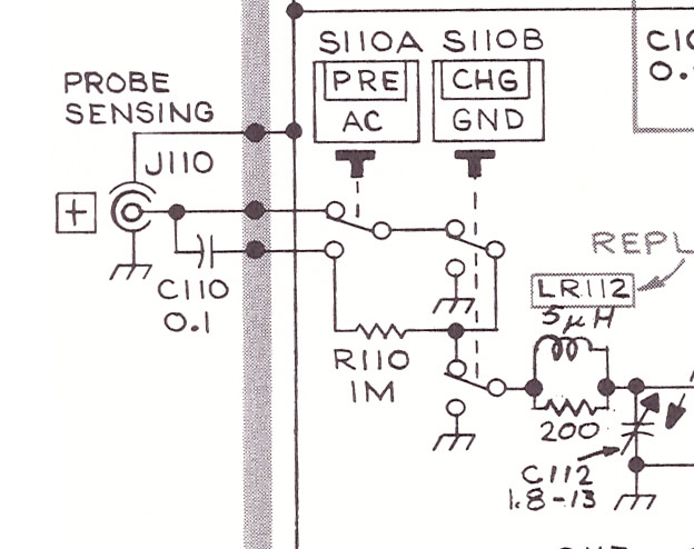

some PAR/EG&G lock-in amplifiers have input ac/dc/gnd selector configured that way, that in gnd position input cap is charged from the signal source, but the input is shorted to gnd (this requires 0 dc on the input gate). I also noticed gate leakage with 100M resistor.I reduce the input bias resistor from 110 Meg to 4.7 Meg
I believe that the Tektronix 7a22n and 5a22n differential preamplifiers do so similarly. On the 5A22N, there is a "precharge" button, don't have a 7A22N anymore.
The manual is available on BAMA: http://bama.edebris.com/download/tek/7a22/7a22-differential-amplifier-plug-in.pdf
Discussion of gate current compensation.
I made one of these circuits on RS proto-board and the leakage was very evident.
Time for dead-bug and through-hole components, or those little teflon standoffs.

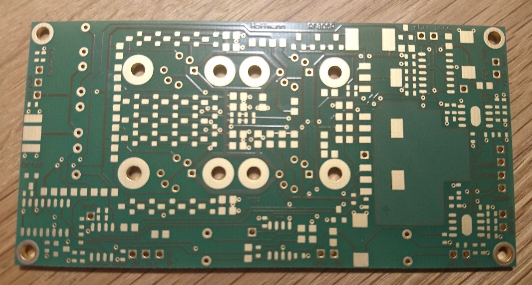

But I just got V3 of my BF862 / IF3602 preamp board
- Design & Build
- Equipment & Tools
- My version of the G = 1000 low noise measurement amp (for Ikoflexer)
