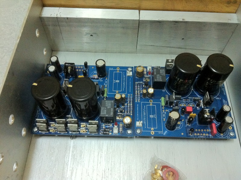

Dario,
One other comment on your new chassis. It's just amazing how small the FE's look in that box.
Jac
One other comment on your new chassis. It's just amazing how small the FE's look in that box.![]()
Yes, the chassis it's pretty big, it's a 19", 2U unit.
Nevertheless I'll have to place components with care... with all parts in there's no so much place as you may feel initially...

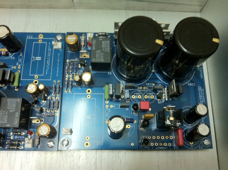

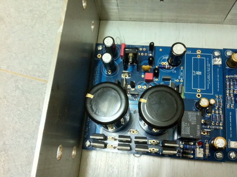

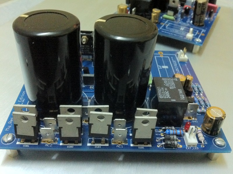

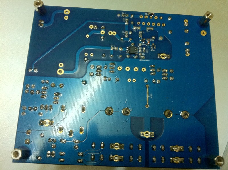

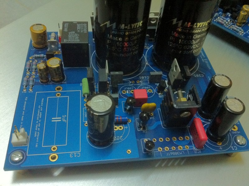

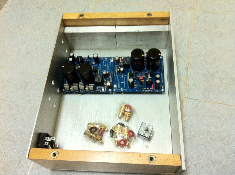

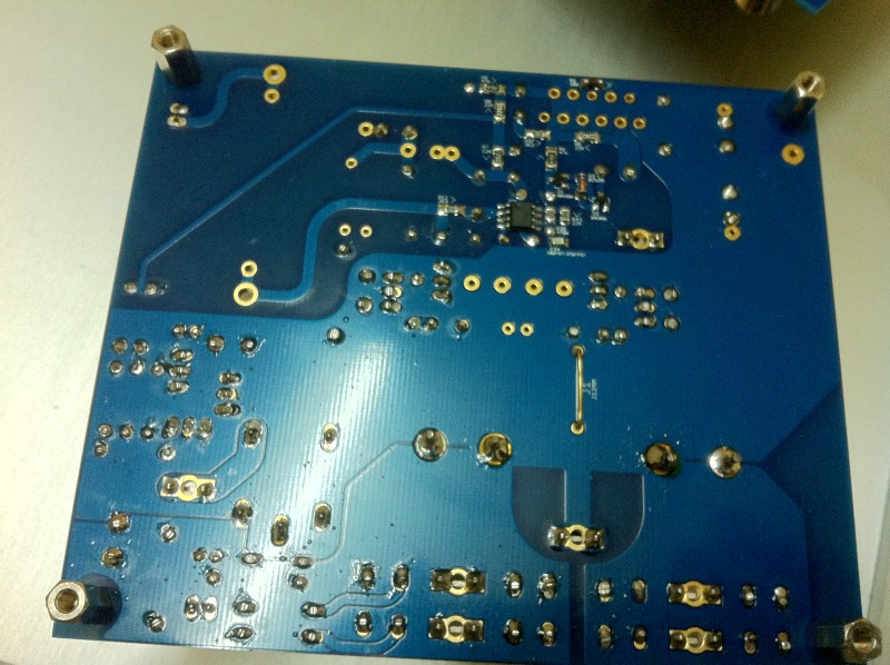

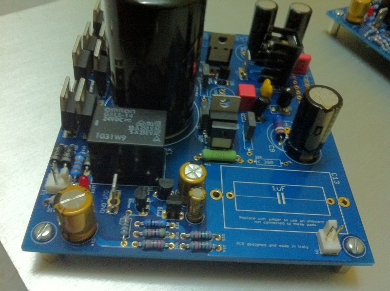

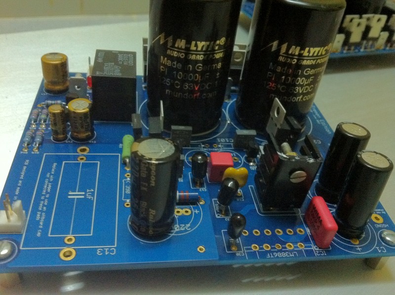

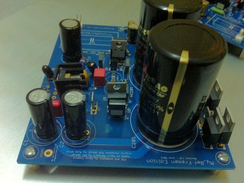

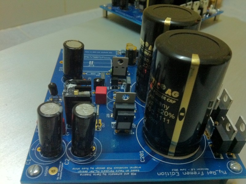

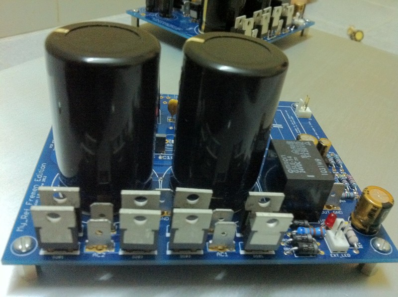

Badri's build (part 1)
Badrisuper asked me to post for him pictures of his build...You'll find them attached.

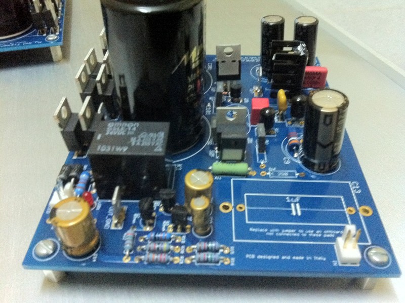

Badri's build (part 2)

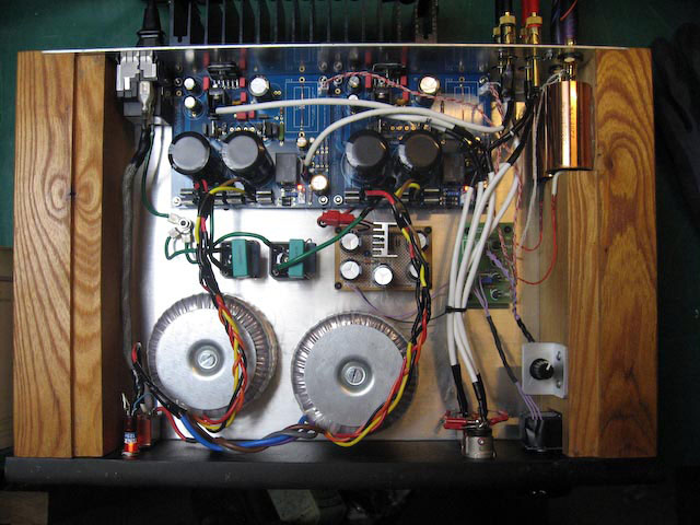

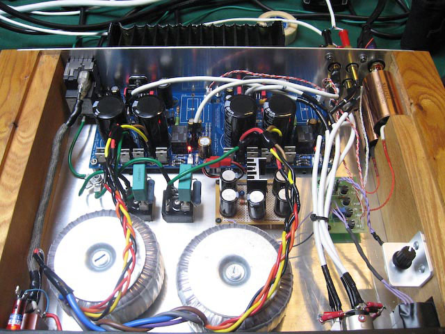

Finally got my FE RC build working today....
Shoe-horned into my 'my ref rev C' chassis, and using the obligato input caps and lightspeed passive pre I used in that build. This was mostly because of lack of money, but also means I can compare with my memory of how the my ref rev C ultimate bom sounded last week.
All worked with no hum or problems straight away, measured 13 mV and 16 mV DC R/L at the output.
I will wait a week or so before getting too sentimental, but the sound is already very good after a few hours...
Thanks Dario, it's sounding good!
Hi Bill,
Good news!
Fine, expect DC offset to lower in some days.
You're welcome.
I've seen you're using a ground breaker to connect PGND to safety earth.
When you can, please, try to disconnect PGND from modules and tell us if you hear a difference (pay attention to soundstage).
Hi Bob,
Power for the lightspeed is tapped from one of the large smoothing caps via a regulator suggested by Regi Regi on the My ref rev C ultimate BOM thread.
That's the brown proto board with five caps center right.
White leads are cheap cat 5 lan cable, I just use one for each channel, going to a headphone socket/switch set up.
It's all a bit patched up and shoddy since I added the headphone output as an afterthought.... still don't have the resistor values right...
Next time!
Bill
Next time!
Bill
