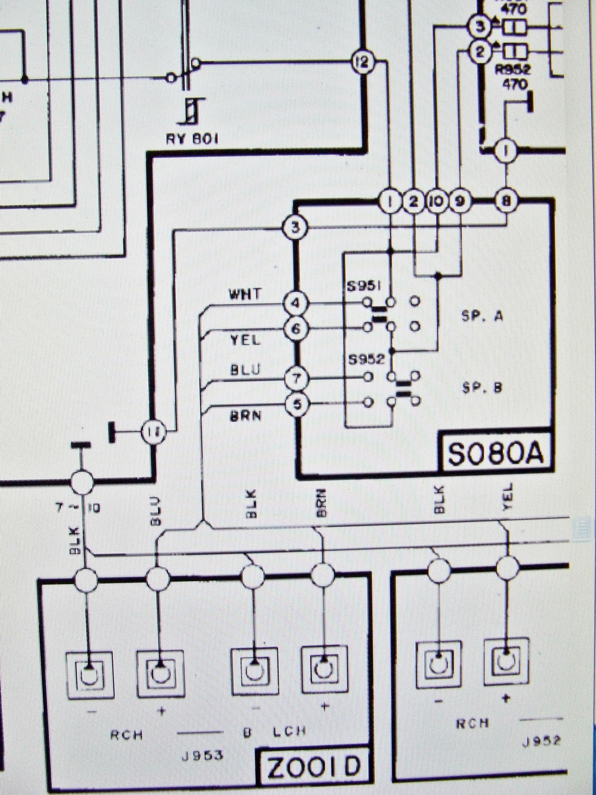

I am too in a similar predicament! I am trying revive a NAD 2155 & the output relay of this needs replacement. However, the service manual gives only the part No. which is 81-619 & no other details as to it's voltage & current ratings!
Have anyone of you guys replaced this relay, on this particular model & if so could I possibly have the replacement manufacturer part No. for this unit please? What voltage/ current rating is this relay?

Thank you guygo for your invaluable info! Yes, I completely agree & you're absolutely right about the perils of modifying or ripping the pcb tracks in order to fit the relay or for that matter any component! I am old school when it comes to replacing parts-always the original or the closest direct replacement when this is impossible!
I will compare & measurement the pcb foot print of the relay & then try to locate a direct replacement part for it! "Finder" brand relays too can be suitable I suppose?

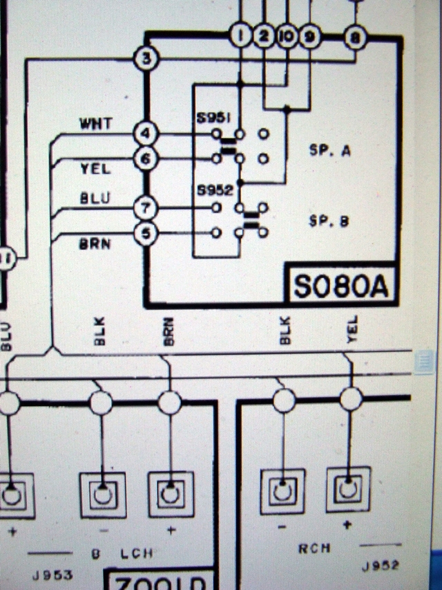

Thank you junior35!
The relay you have recommended & used is a DPST. Looking at the 2155 service manual, it looks like a DPDT 10 pin latching type relay in a single package! Please refer to location SO808 in the service manual. Could some one please verify this? Further, the 2155 is 55w/8 ohm while the C740 is rated @ 35w/8 ohm continuous RMS! So I wondered if this relay might not be sufficient for the 2155 due to it's higher output current or am I being over cautious? In any case I'd need a DPDT in a single package!
