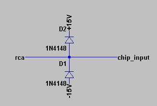

yamaha used to protect the inputs of the selector chip with diodes from the inputs to the analog supply rails. the analog switches here are CMOS, and they can be damaged by static electricity, and by any voltage higher than the supply rails. usually the analog supplies are either +/- 12V or +/- 15V. 1N4148 or equivalent are usually what's used. it's a simple mod, and should protect the chip from a repeat of this problem.
