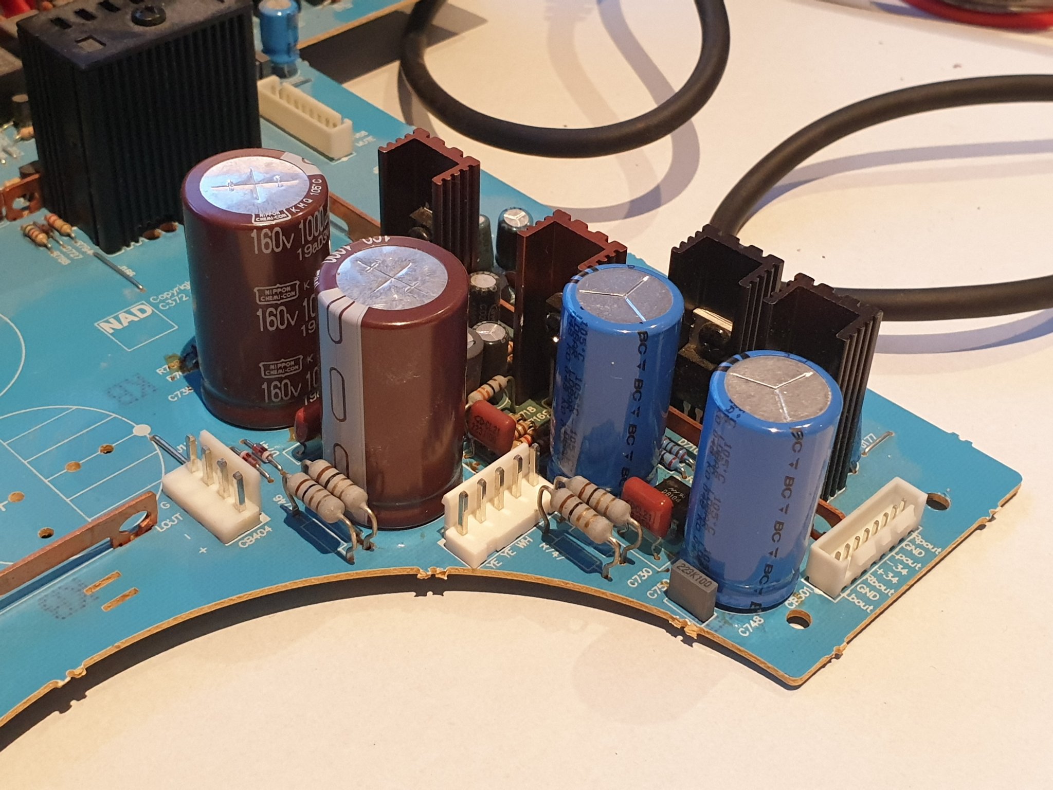

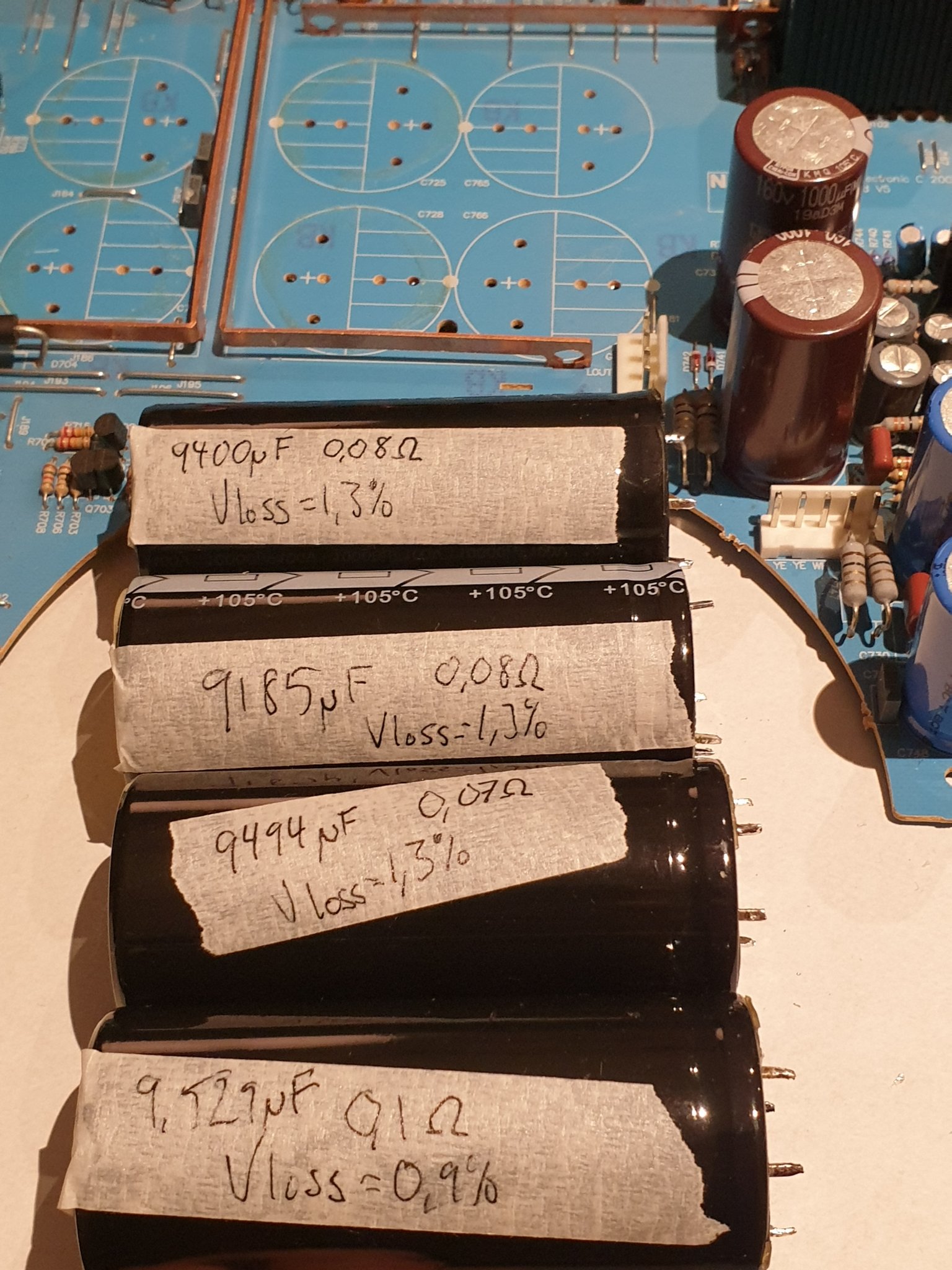

My first approach was to open it up and look for leaking or bulging caps.
I found a lot of brown gunk around 4 bigger caps (bulk caps for rail B and C: C734, C735, C748, C749).
Since the noise is in both channels, the PSU seems like a plausible source of the noise in my noob head.
This is where it all started. Sourcing caps and info on what kind of caps I needed, aka opening Pandoras box...
I had a lot of problem with the small footprints and the 105C rating. The C372 is known for running hot so no 85C for me please.
Most HiFi-caps were too big since rail B and C clearly was designed by some engineer sharing closet with his wife,
while the main rail A was designed by previous mentioned wife.

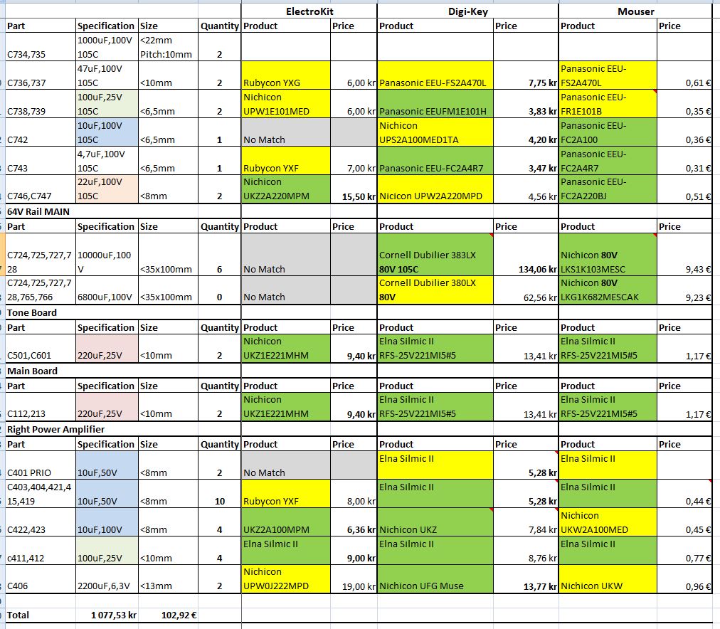

After 3 days and 2 nights without sleep I ordered the best I've found:
2 x Vishay 2200uf 50V 105C with 7,5mm pitch (part# 2222 048 61222)
2 x Nippon Chemi-Con 1000uf 160V 105C with 10mm pitch (part# EKMQ161VSN102MP40S)
Cost: 20€
This is where I couldn´t help myself. I took another look into that box and soon realized that it's more fun to upgrade something than to repair it.
Invest money instead of just spending it so to speak.
I have no idea if these caps will solve my problem since it could be more bad caps.
I've also learned that not all caps bulge when they're bad, and that the brown stuff might be glue.
My idea here is to change most/all of the electrolyte caps (all branded Jinghai) to newer and better ones since they're all old.
(Are Jinghai good btw? In the computer world Chinese caps are not that welcome...)

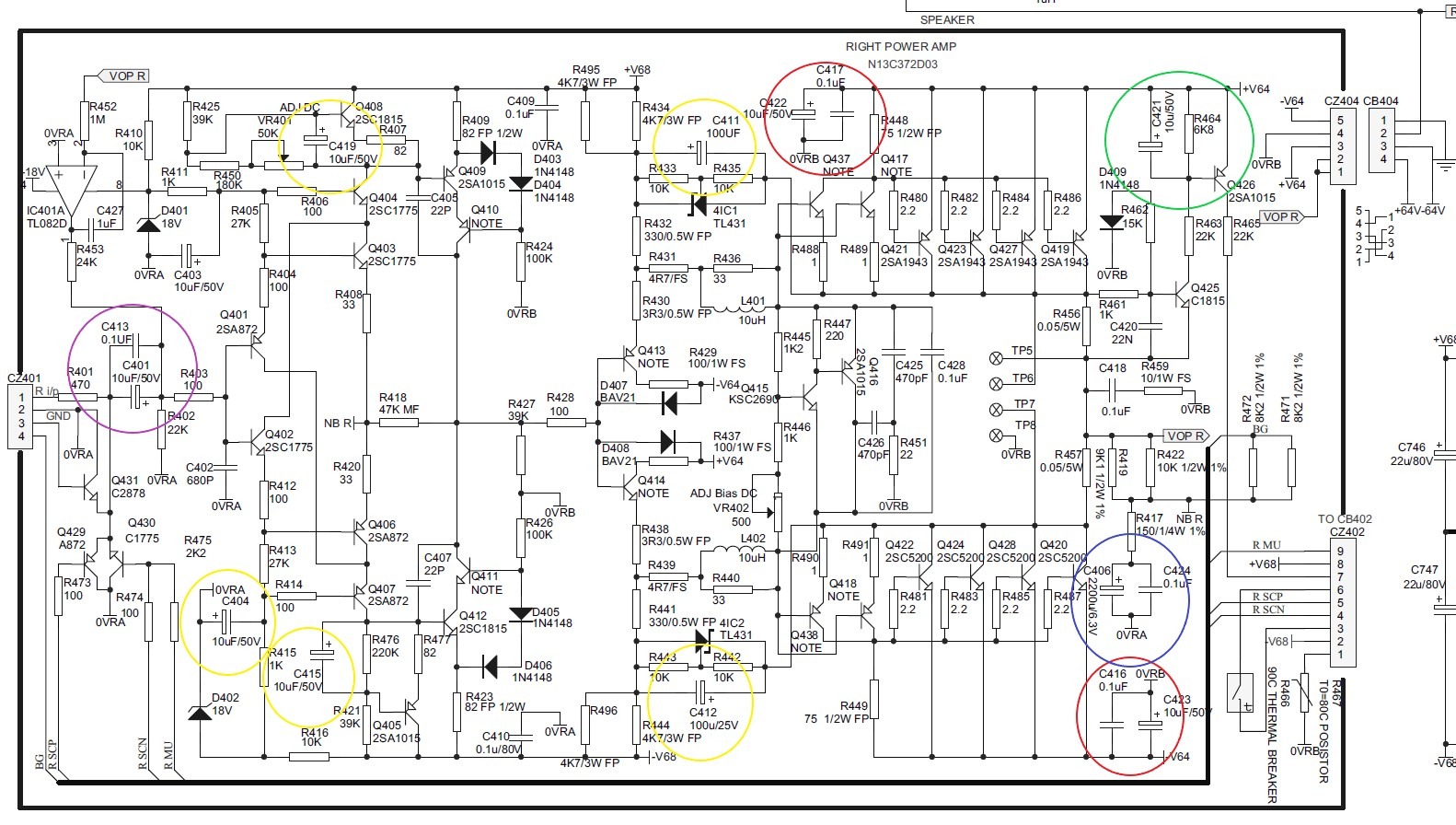

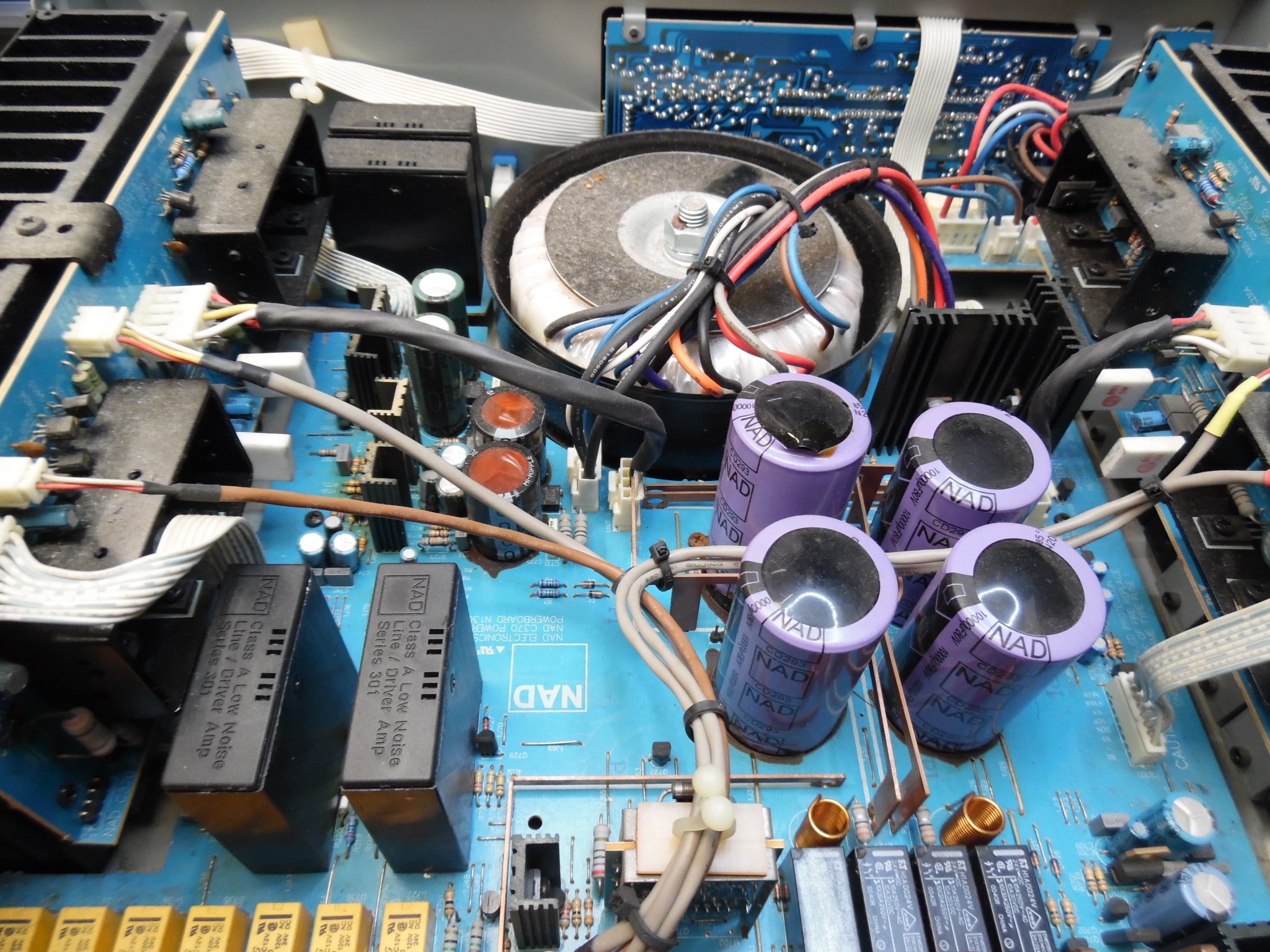

I have attached a Photo of a NAD C370 main board, this is before the Amplifier was recapped and repaired.
The issues with the electrolytics failing over time is common, and if you de-solder the large power supply capacitors you will most likely find one or more of the pins fall off and if you shake them they will rattle confirming they have completely dried out
Also many of the capacitors are mounted close to the heat sinks of power components, so again they will have dried out.
Its the same for the left and right channel Audio output modules.
NAD fitted J&H capacitors and still use the same brand for more recent Amplifiers.
As you have identified if you order Audio grade capacitors they are physically larger than those installed, also the cost will be very high for the large capacitors.
So there's a compromise you can still fit brand named capacitors for example Nichicon, Panasonic etc.,
You need to get the Amplifier to a known state before further fault finding, and in this case all the electrolytics ideally should be replaced.
starting with the power sections.

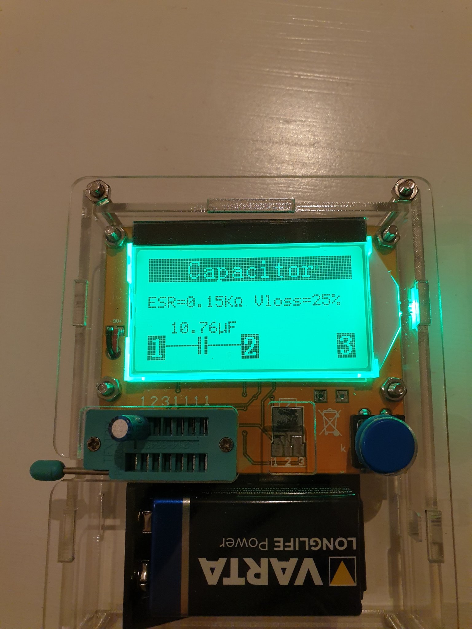

It feels a bit like a catch 22 to recap it to know if it's worth recaping it.
I've ordered an cheap LCR meter to check the caps, but even if I find faulty ones changing them might not solve the problem.
Would be great to know where the problem most likely is, and try to recap that part, and if it doesn't help make a decision whether it's wort continue or replace it.
I'm not doing it for a resale, but I don't want to spend more for a repair than it's worth, which I believe is somewhere around 250€.
I'm ok with spending time though, as I learn a lot doing this.
The noise you describe is heard through both channels so it points to a common cause.
The power supply sections would be the first thing to check as if the capacitors are open circuit then you would hear 100hz noise.
The issue here is all the capacitors will be at some level of deteriation, the large power supply capacitor have a hard life as do any that are mounted next to the heat sinks or voltage regulators, power resistors etc.
The ESR meter will confirm bad caps and an ESR meter can be used to check electrolytic CAPS in circuit but only to a point, removing them and testing out of circuit is the only way to confirm 100%. So while your removing them for testing you might as well just replace them.
The smaller CAPs will not be expensive the large power supply capacitor will be approx €14 Euros each.

With some help from the user PerStromgren at the Swedish forum faktiskt.io I tried remove the bridge between preamp and power amps. No noise.
Tried to connect audio directly to the amplifiers without all the other fuzz, and no noise!
If I'm understanding this correctly, then my problem is between the mains and the pre-out.
This means that those expensive 10.000uF 100V bulk caps isn't faulty (Might be worth changing anyways, but not critical ATM.)
But most of all, this means I can use it as an amplifier even if I can't fix the problem with the preamp.

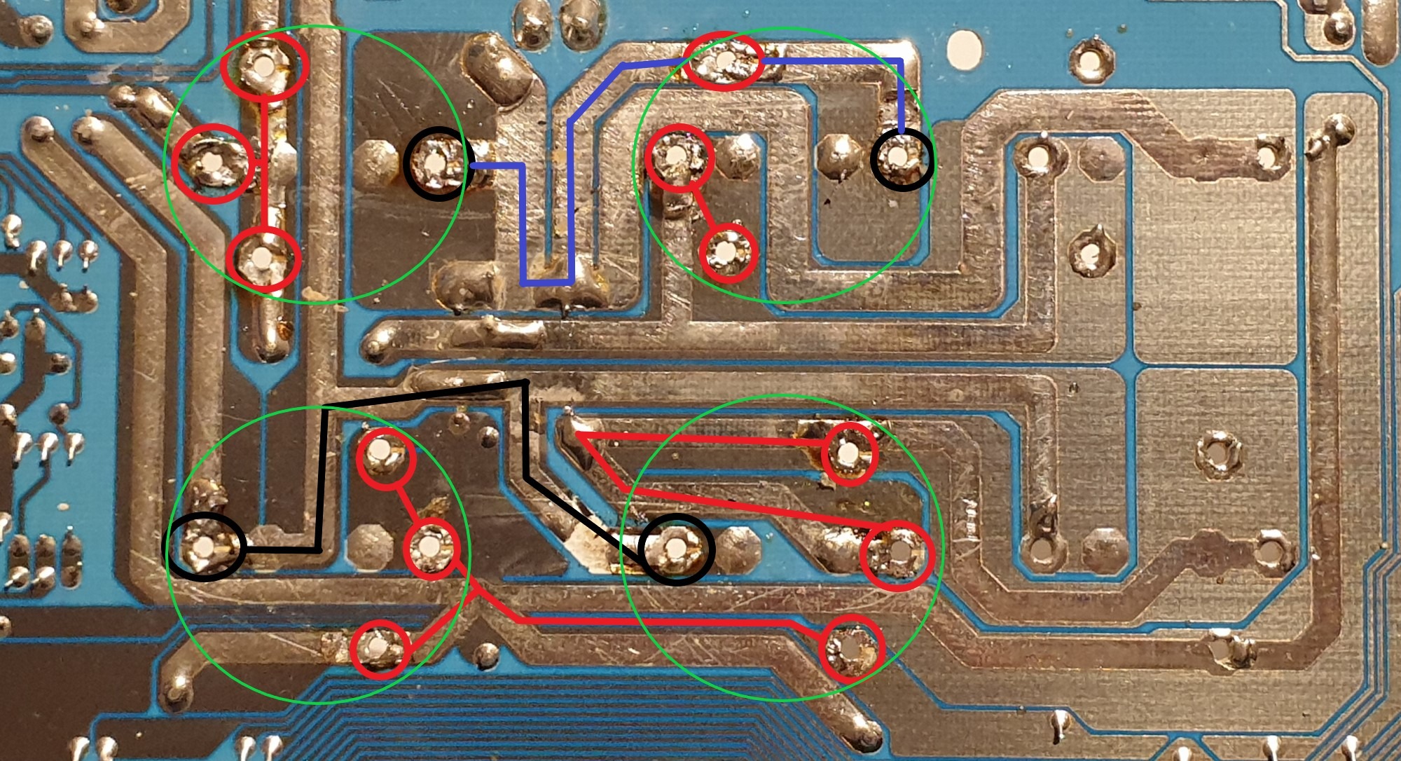

The big bulk caps are four-pin, but the main board is prepared to take two-pins with a 10mm pitch too.
Are there any advantages except build stability to use four-pins?
Now we got the PSU part covered (hopefully), let's look at the Amplifiers.
The red caps are basically the same smothering caps that rail B and C have locally if I understands this correctly.
My plan is to get the ones mentioned above for exchange and maybe add another higher grade small decoupling cap too in parallell.
The others are a bit of a mystery to me however.
I think that the violet is doing the same thing as the red ones and that the blue is a buffer of some kind, but that's just guesses.
Are there any of these I should chip up some extra money for?
I would say the blue (DC) and green(over current) protection circuits. Whatever works.
Red ones for rail decoupling to prevent oscillation. Low ESR is good for that.
Violet is input cap (some people are very specific with the quality/type here)
I would think the yellow ones to the right are bootstrap caps..
Basically I would replace all the electrolytic caps, and maybe put some audio grade on the input cap. Poly cap or bipolar electrolytic.
BUT: get the amp working first, before you start spending.. especially on the big PS caps.

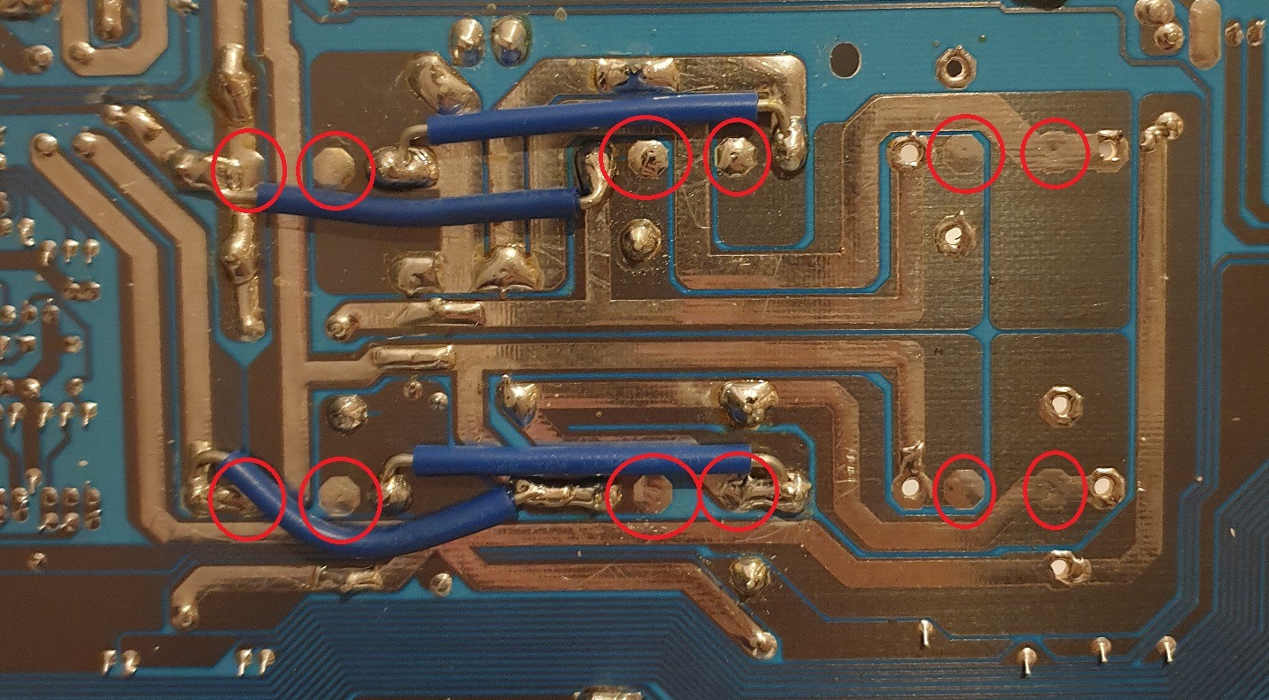

I can answer my earlier question about the shorted pins.
Those are, like me, dummies.
It's not recommended to connect them to any power though according to Nichicon (IIRC) since it will add to the power leakage of the cap.
Will opt for two-pins instead.

So, this is what I found.
The big boys is only 80V, as the first version of the C372 had, but six of them instead of just four and that of better quality so I hope it's ok.
Bold prices are what I'm planing to go for.
The price difference from non audio grade to audio grade in the smaller caps are close to nothing.
80% of the cost are those 10.000uF.
I still kept it under the 150-200€ budget.

Of course I didn't!Did you check the actual voltage in the PS? Just to be sure you have some margin on the caps voltage.
I just read this thread: https://www.diyaudio.com/community/threads/nad-c372-to-restore-or-not.248323/page-2#post-5199342
along with the assumption that it would be ok since 64V is 80% of 80V.
But we all know who's mother assumption is...

First I'll order everything I need from Electro-kit. Among those caps are the ones I need for the 34V-rail (missed them in my last post).
I'll try fixing the problem with the amp, and resolder the main bulk caps after I checked them. Then I'll make sure that the 64V-rail indeed is 64V.
Then I order the rest of the stuff from Digi-key, just like you told me to in the first place.
I have some doubts about adding the two extra big bulk caps too.
I don't think it will do that much extra for the sound and just stress the PSU for no good.
How about adding two smaller caps with lower ESR instead.
Will that do any good?
Yes. Mine is one of the upgraded units with 100V caps instead of the bad 80Vs.Shortly after that NAD 'C' line was introduced there was call backs by NAD on the 270/2's, either the integrated's power amp's, or both. Because the large caps were exploding when you played the amps. You can still locate the stories through g search.
While waiting for new caps for the 34V rail I removed and meassured the old ones.
The 1uFs seems ok but the 22uFs were not that great.
Checked the big ones too.
They're not perfect but not terrible either.
Soldered them back to be able to test the amp with new caps in 34V rail.
