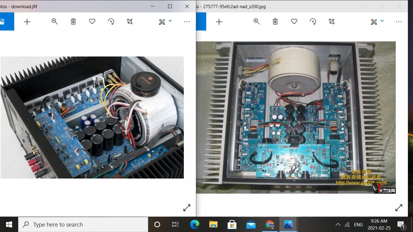

I don't even know where to start, I found even more bugs. Now I think that they were made on purpose or this is a middle class technique that does not claim to be high class. Mark Levinson and Meridian also have high-end devices, but there are also medium-simple ones. For example, if compared with NAD218THX, then in NADS200 the relay is not properly covered by the feedback. Perhaps due to the fact that the relay was chosen too bad.

For today, my friend and I have selected power Russian and Dutch speaker cables ARKANA and Van Den Hul for this amplifier. Now, even with these flaws, it sounds pretty good. It is probably time to change to new electrolytic capacitors. Because after the amplifier has warmed up, turning it off for one minute significantly improves the sound. Apparently, the dielectric is being re-formed in the capacitors or the internal voltage in the transistors is being removed. I observed a similar effect in tubes.

NAD S200 is a factory tweaked/modified NAD 218 THX.
They share the same schematics.![]()
The biggest difference between these two amps is the chassis with terminals.
Other changes are better PCB (two sided, same layout, but the wire straps are replaced with pcb tracks), Metalfilm resistors instead of the ordinary and some better capacitors here and there.
The only S-amp that`s someting special is the S300 (based on a Gryphon amp) but thats another story;-))

I had a few looks under the hood of the 218 and the S200. They do look strikingly similar at a glance. Pretty amp though (the S200).

What is this jar of Vaseline on the NAD 218 THX transformer?

What is this jar of Vaseline on the NAD 218 THX transformer?[/url]
I hadn't looked close up to see that. Is that what that is? That owner must really like his Nads
Or it's merely meant to reference size (of transformer) 😱.
