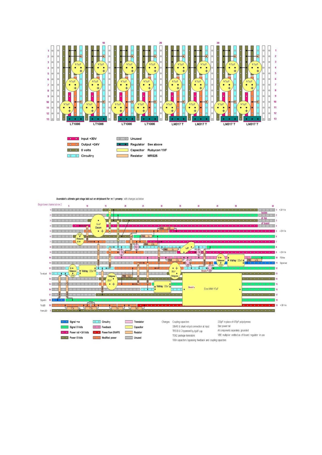

The Naim Nac 42 has been extensively modified to "ultimate Avondale" specification - it makes a world of difference. The two pictures show the preamplifier layout and components used, the circuit is 'mirrored' which as well as looking neat is said to offer sonic advantages. The pre-amp has discrete regulators which require 30V so the SNAPS power supply has been modified to provides this. The source and speakers used is in the original text.

pictures
I do not know if it works well, but I find it super beautiful!
I put it directly in my naim clone folder for later.
thank you very much sir

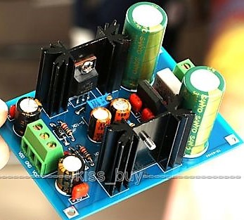

A while ago, I decided to experiment with the installation of a stabilized power stage on my NAIM NAP-140 clone more out of curiosity than out of real need, as even today this project remains the best sounding power amplifier I have ever seen in my living room.
Considering that the audio amplifications with the power stages stabilized, none of my sympathies for a sound "closed" and devoid of great breath and seduction has ever gone, but after two months of testing and experimentation on my clone NAP-140 improvements in terms of thickness timbre, harmonic richness, instrumental realism (this fundamental note seems much richer in harmonics) combined with a delicate detail, are so concrete and objective that I excluded any possible suggestion by experimenting with more than a pair of speakers, passing from my magnetoplanar MAGNEPAN, to a pair of bookshelf SONUS FABER up to a pair of vintage New Loudspeaker ADVENT.
I would like to point out that the installation of the +30/-30 Vdc stabilized power supply stage concerned only the differential input stage and the VAS section.
The linear power supply (+42/42 Vdc) of the pilot stage and the power BJTs, was instead left strictly unchanged.
A change that therefore I would strongly suggest to all and easily integrated through the installation of two adjustable stabilized power supply kits based on LM317/337 at a cost of a few euros on eBay, spending another 20 to replace the trivial electrolytic kits, with the refined and beautifully sounding NICHICON Muse.
In addition and after experimenting in the driver stage (Q1 and Q2) with the complementary transistors shown in the original scheme, TIP41/42 (Current Gain Bandwidth = 3.0 MHz), I reassembled a pair of complementary MJE15030/15031 (Current Gain Bandwidth = 30.0 MHz).
The TIP41/42 pair was characterized by a particularly sculpted and defined bass, while the MJE15030/15031 pair gave back that extraordinary magic made of extraordinary realism on the mid and mid-high delicate and magnificently chiseled that I personally consider much more refined and appropriate characteristics to the extraordinary sound of this exceptional circuit design, not lacking in any way, however a fast, articulated and extended bass register.
