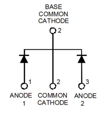

However, I would like to add that despite the improvement of increasingly refined production technologies, in reality it is inconvenient to use more conventional diodes in paralel, because even if only slightly, they could have different intervention times at the time of "conduction" as soon as the threshold voltage is exceeded.
Much better then to use the so-called double diodes, which are made on the same wafer of doped silicon.
Below is the example of an Ultra Fast type and that among the many I have been using for years, in my constructions, the MUR2020CT:
![Doppio-diodo.jpg](https://i.postimg.cc/cL0YG5sg/Doppio-diodo.jpg)

I don't think this is the correct way to determine a diode's internal resistance
Two diodes in parallel, in the best case scenario, will turn on at different times. So you'll have even more switch-on/switch-off disturbance, even if you use some fancy dual diodes (which, by the way, are also not meant for use in parallel).

Not really. Diodes are not resistors. Even if they share the current perfectly their non-linearity will counter-act their conductivity as each will conduct only half the current. The winding resistances of the transformer will be of the same order too. I’m not sure what your reason is for fast recovery diodes either.I hope I've been able to answer your questions as well..![]()
