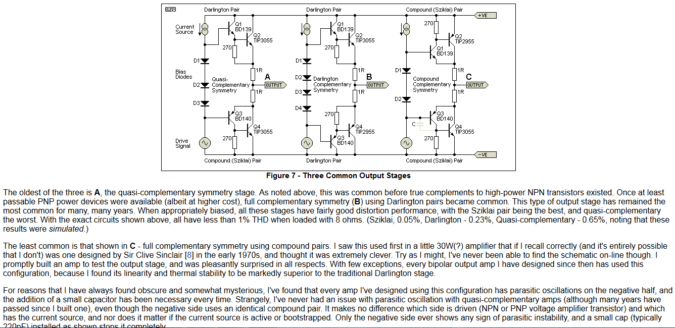

Of course the Darlington deals with positive current and the pseudo-Darlington with negative current. So your characterisations may apply half the time.The CFP topology does not sound conventional. It is very low distortion and the bass control is unique due to local feedback in the CFP.
The two configurations are quite different in their function. I can see why JV used a mixture of the two (he wanted only npn power transistors) but I’m not sure why SS chose two CFPs instead of two Darlingtons for fully complementary, aside from potentially slightly better bias current stability.
It’s hard to untangle the possible motives; sound quality is not the primary aim of the Nait series.

A pseudo-Darlington is less stable than a Darlington and so is more sensitive to load.CFP designs allow a little more output swing which means slightly better power ratings, if that matters but the reasons traditionally given for preferring EF designs here are mostly arguments and anecdotes about stability and driving difficult loads - a problem with some early designs that is now better understood and dealt with to the point where it's no longer any great concern.
The bigger issue is that there does not exist a npn and pnp power transistor pair that have identical characteristics. It’s a law of nature.
So JV chose a compromise with a Darlington and a pseudo-Darlington. There are other compromises possible.
If you choose the compromise of having power devices of opposite gender then you can use either Darlingtons or CFPs. It is better to use the former (like Krell did). Sells may have had several reasons for using CFPs but as this is Naim’s budget rofl integrated, the thermal tracking benefit that Bigun suggests would swing it.

Let me try to translate...
EF = emitter follower (Ian used as shorthand for a Darlington as opposed to a CFP)
CFP = complementary feedback pair, or Sziklai pair or pseudo-Darlington
Darlington = two same-polarity transistors in emitter to base cascade
Pseudo-Darlington = two opposite polarity transistors in collector to base cascade.
VAS = voltage amplification stage, or Miller cap stage
LTP = long-tailed pair, or differential amplifier
Quasi complementary = one Darlington and one CFP in push-pull
Fully complementary = usually two Darlingtons or two CFPs in push-pull

The category of the original NAP and Nait power output stages is known formally as Quasi-complementary. It has been so since at least 1980 when I studied them and worked on a few NAP models. "quasi" suggests that the design mimics a complementary design though it actually uses the same power transistors in both upper and lower or positive and negative power rail locations as shown on conventional circuit diagrams. The schematic diagram of NAP250 amplifiers that you see posted many times in this thread and appears almost everywhere on the internet, is conventional and you can refer to it .

Conventionally, the term "Darlington" now refers to an emitter-follower cascaded pair of transistors fabricated on a single die and packaged as one device. It probably should not be used to confuse it with the arrangement of two discrete transistors in a similar emitter-follower diagrammatic arrangement nor with Sziklai pairs because the thermal and electrical behaviour is quite different under stress and we may not know what the internal circuits really are.

Rod had a name for the Nait XS or P3A CFP topology: Compound Complementary.

you need mixed PNP and NPN devices for CFP designs - that would not be possible on a single chip.Quiz:
1).... Why don't you see pseudo-Darlington/CFP/Sziklai transitors for sale?
Though I respect Rod's historical use of it, the problem with using a term like "compound pair" or even "compound complementary" pair is confusion. Example from Wikipedia: "the Darlington configuration (commonly called a Darlington pair) is a compound structure of a particular design made by two bipolar transistors....."
In other words, both EF and CFP discrete forms can described as compound and also complementary transistors. Which do we mean??
