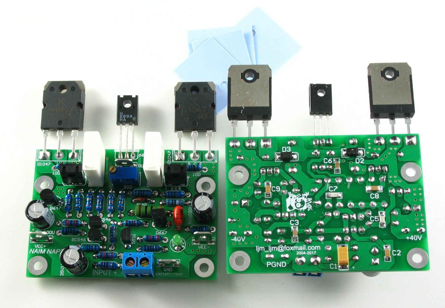

I was having another look at the LJM version of the nap250. AT a glance, the component count seems reduced so my guess is that he has omitted the protection circuit. The transistor count seems to indicate that but there is this odd looking transistor that he placed on top, supposedly to sit on the same heatsink as the output transistors.
The transistors in the typical NAP schematic seems to go in pairs. Any idea why is it 5+1 instead of 6 TO92 (?) in this version?
It's an LJM adaptation (lower power, no regulators or current limiters, as you suggest) version of The NAP 250 design. LJM though, is a real engineer and a good audio designer who knows how to achieve excellent performance within the scope of the cheap parts and PCBs available to Chinese kitsellers. I like a number of his kit designs better than most other kits, which often prove to be poorly designed junk. Of course, if you assemble something yourself, the parts and build quality are still your responsibility because cheap kits contain only low cost items.

Since you asked about the number of TO92 transistors, don't forget that the D669 transistor, shown as mounted between the power transistors, will also be bolted to the heatsink in this build, since it's more reliable and easier to fit that way rather than fiddle about with clamps, heatsink grease or big holes for TO92 size transistors, in order to maintain thermal sensing of the output transistors. It's often called the Vbe multiplier because it multiplies their Vbe variation with temperature and this output is used to regulate bias current and thus prevent thermal runaway and disaster.
In the original design Vereker relied on the ambient temp inside the closed, heavy aluminum enclosure to allow the Vbe multiplier to thermally track the output devices.

Putting the Vbe multiplier on the heatsink seems odd to me, because on a CFP output stage, you want the bias to track the drivers, not the output transistors.
Well, the other half is an EF, so it's like picking the optimum bias: there's no good answer. Maybe that's why Vereker used ambient temp. 😉
